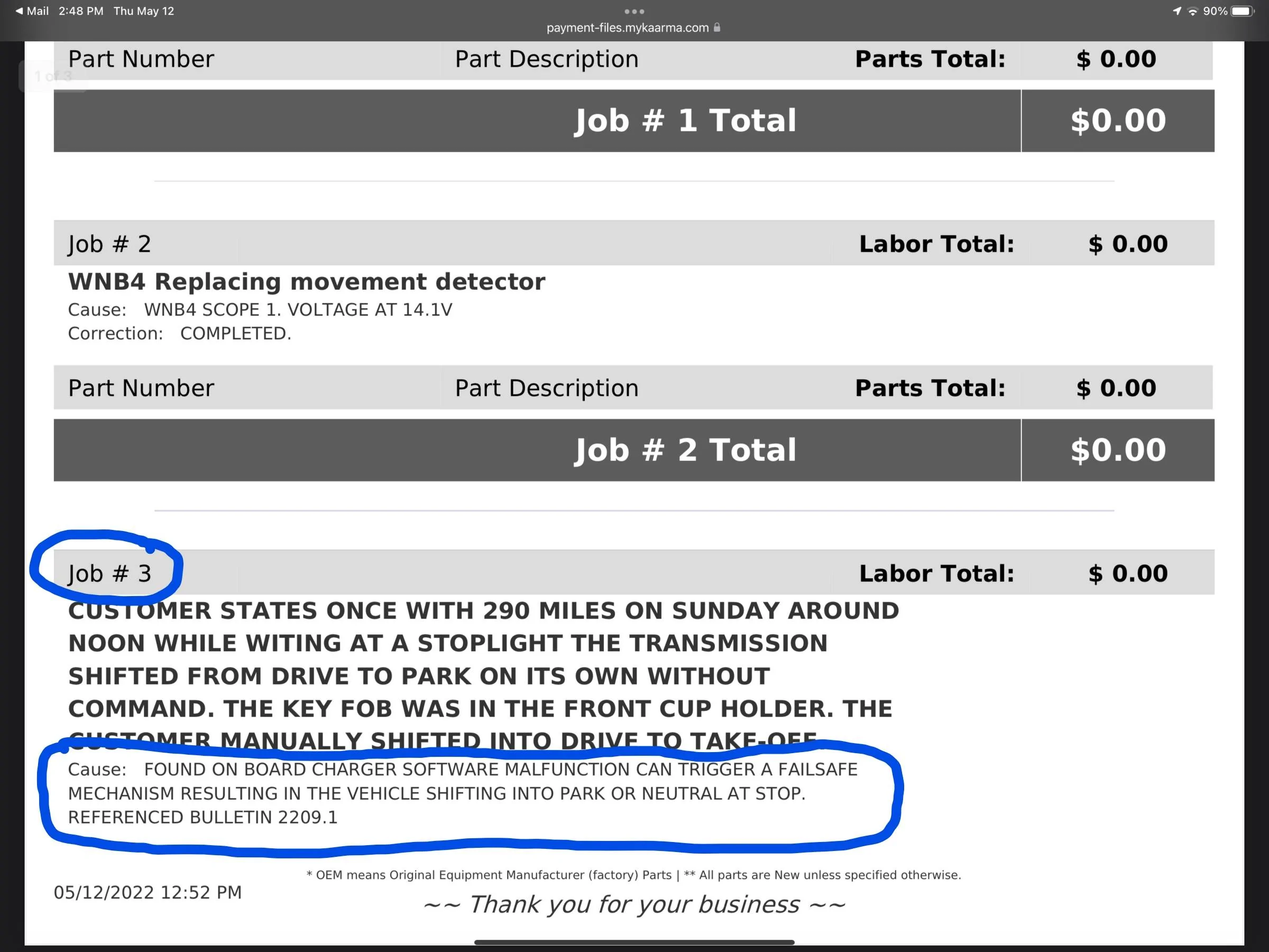

Mention of charger software malfunction triggering shift to park or neutral per this post in a different thread:
Porsche Taycan Car went into neutral then park spontaneously - deja vu all over again Inked5ab3e34d-2bbe-4063-b050-d2b7b65cecda-png_LI
edited image with marks
Just spoke with my SA about this update. He said my car (build date 3rd March 2022) already has the update so it doesn’t apply to me. At 150miles odometer my car shifted itself into neutral and started jerking back and forth….
