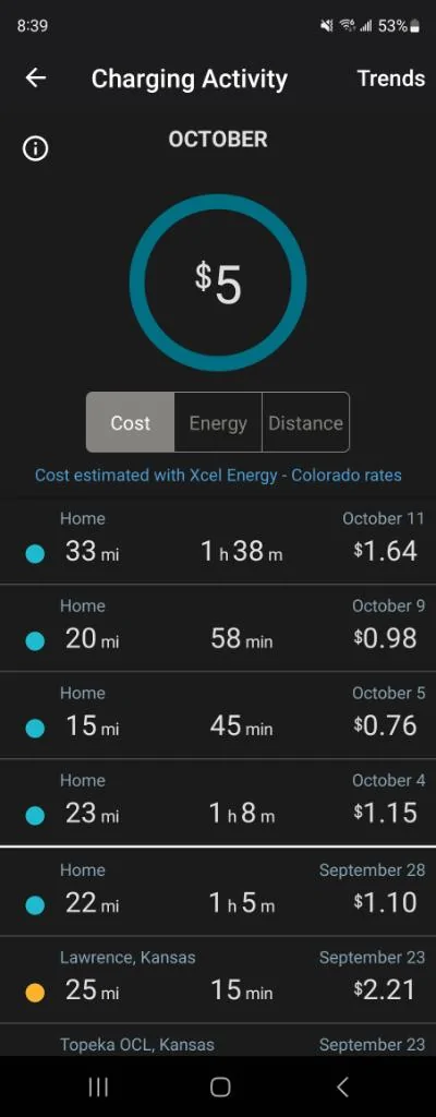

Mine works just fine. I replaced my Juicebox with one a couple of months ago and could not be happier. The app has enough functionality to get what you need out of it, so if you are thinking of installing one in your garage, I would recommend it.
