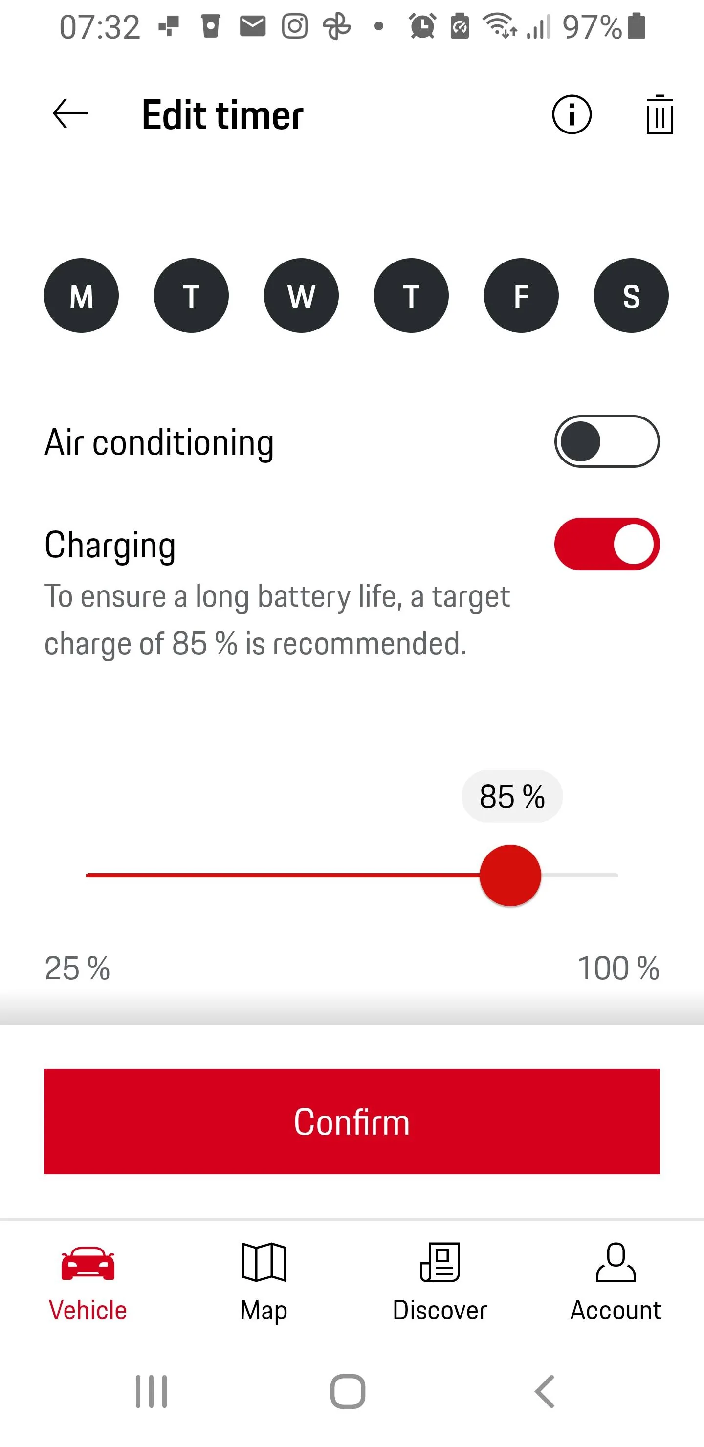

Ah, missed that. so approximately 80-85% is what Porsche recommends. Wouldn't it be nice if they incorporated the recommendation in their User Interface like Tesla does (the screen below is from Tesla "set charging limit" screen).
Porsche Taycan Charging patterns 1665376120885
It is marked on the battery display via a line at the 85% position as well as on the My Porsche App in several places - charging overview screen and Timer config screen.
Porsche Taycan Charging patterns Screenshot_20221010-073211_My Porsch
