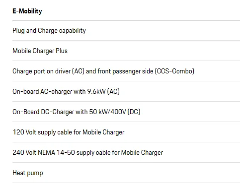

is the onboard charger 11kw? porsche.com shows 9.6kw
