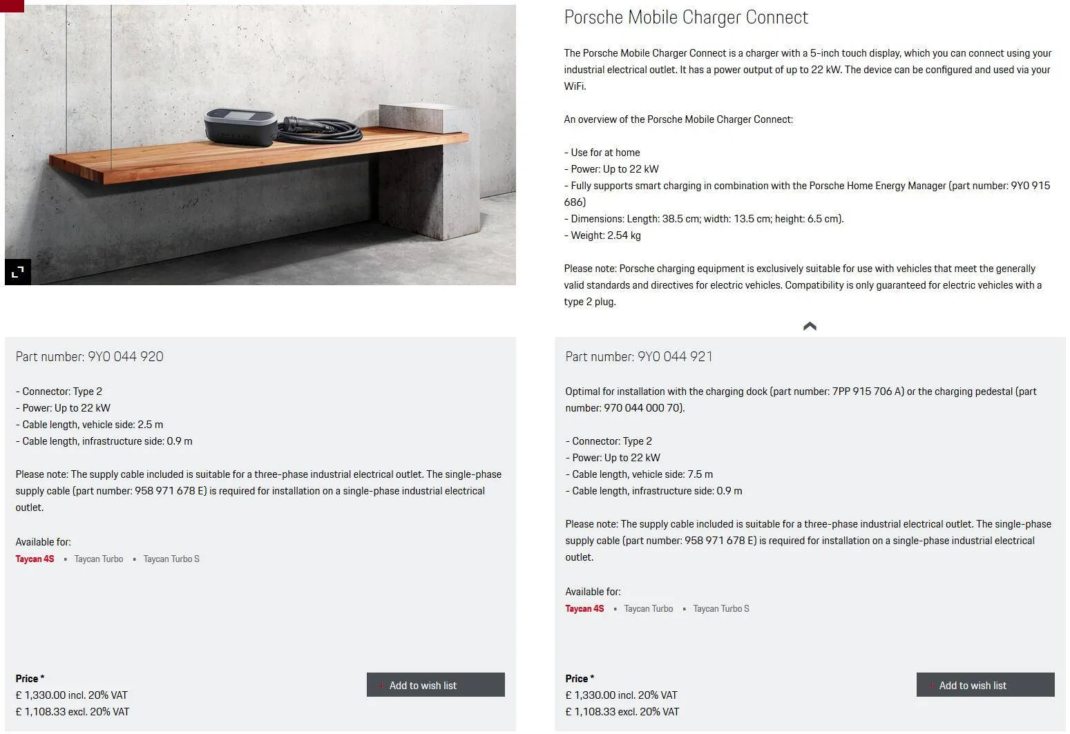

Got it. As soon as I confirm that I have (literally) thousands of dollars refunded to my credit card, I'm ordering the HCS-60! I've got my than my share of gee-gaws with this car.... I just want something that will charge the vehicle and not melt!
Maybe you can also ask your Porsche dealer, why they charged you that high amount at all, when they sell the same charger for a completely different price somewhere else on this planet. I would be happy to hear the answer. I found that on the UK Porsche website in the Tequipment segment.
Porsche Taycan Ditch the PMCC (for now)? 1598164533058

elberk,
Can't tell if have owned Porsches in the past or not, so forgive me if I am making an incorrect assumption here.
I've owned many Porsches (and continue to do so) over the past 20-odd years. What I have found is that Porsche charges every customer a premium for every single thing. It is there business plan, and they follow it fiercely. Their pricing makes no logical sense, save for some un-published margin rate that they must hit for every single thing sold containing the Porsche brand.
It doesn't make any logical sense, it just is...... I would keep the PMCC *IF* it would not create opportunities for skin burns while charging the car.
Trust me, I know that. And that is not my point here. I wonder why a Porsche customer in US is charged 3 times the price than in UK for the exact same thing, assuming nearly 1:1 exchange rate.
