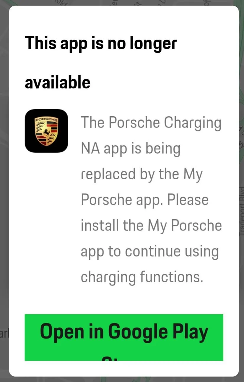

Porsche obsoleted the Charging NA app with the same functionality incorporated into the My Porsche app. That was roughly a year ago. The My Porsche app activates my EA charging sessions the same as with the old Charging NA app. Is the My Porsche app not initiating EA charging sessions for you? Please be more specific so we can help.

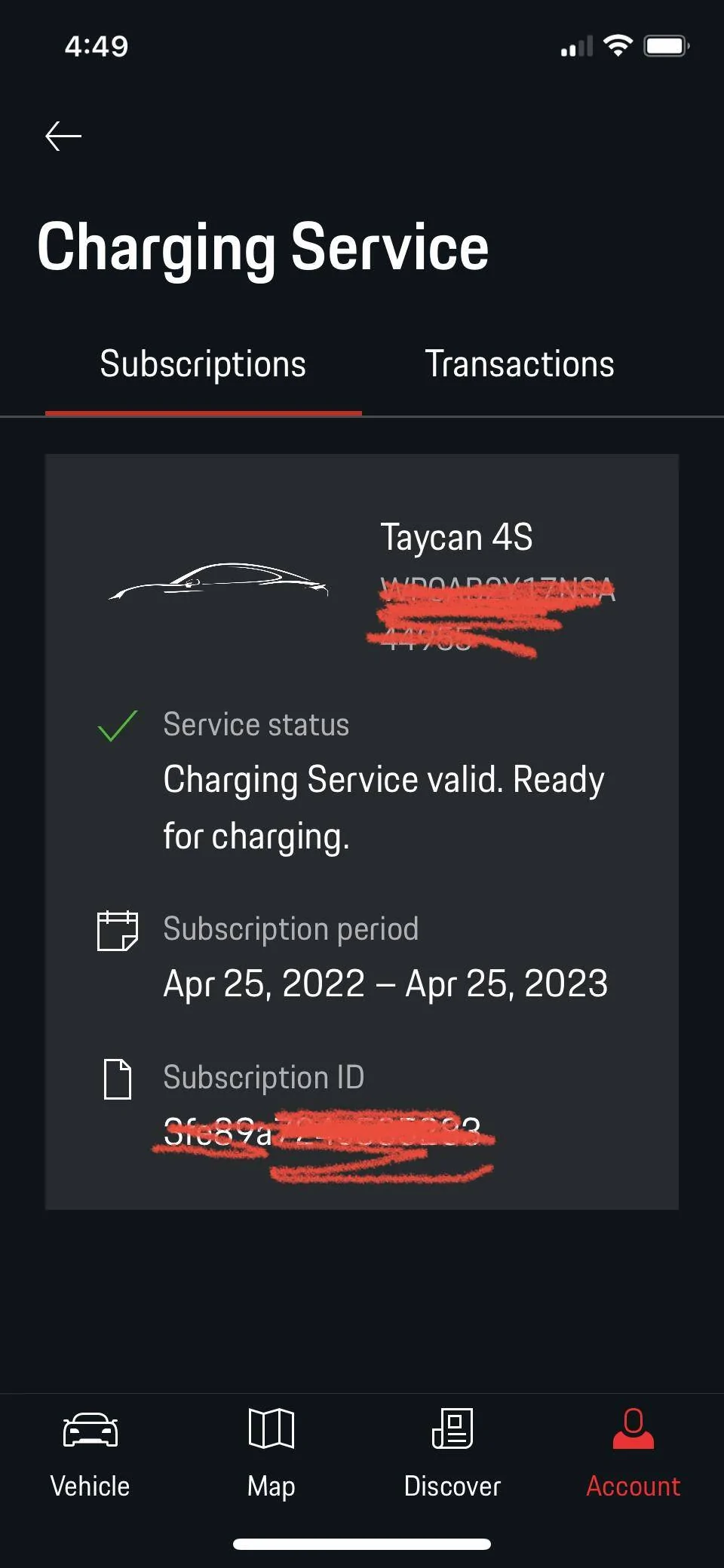

does your app look like this?
