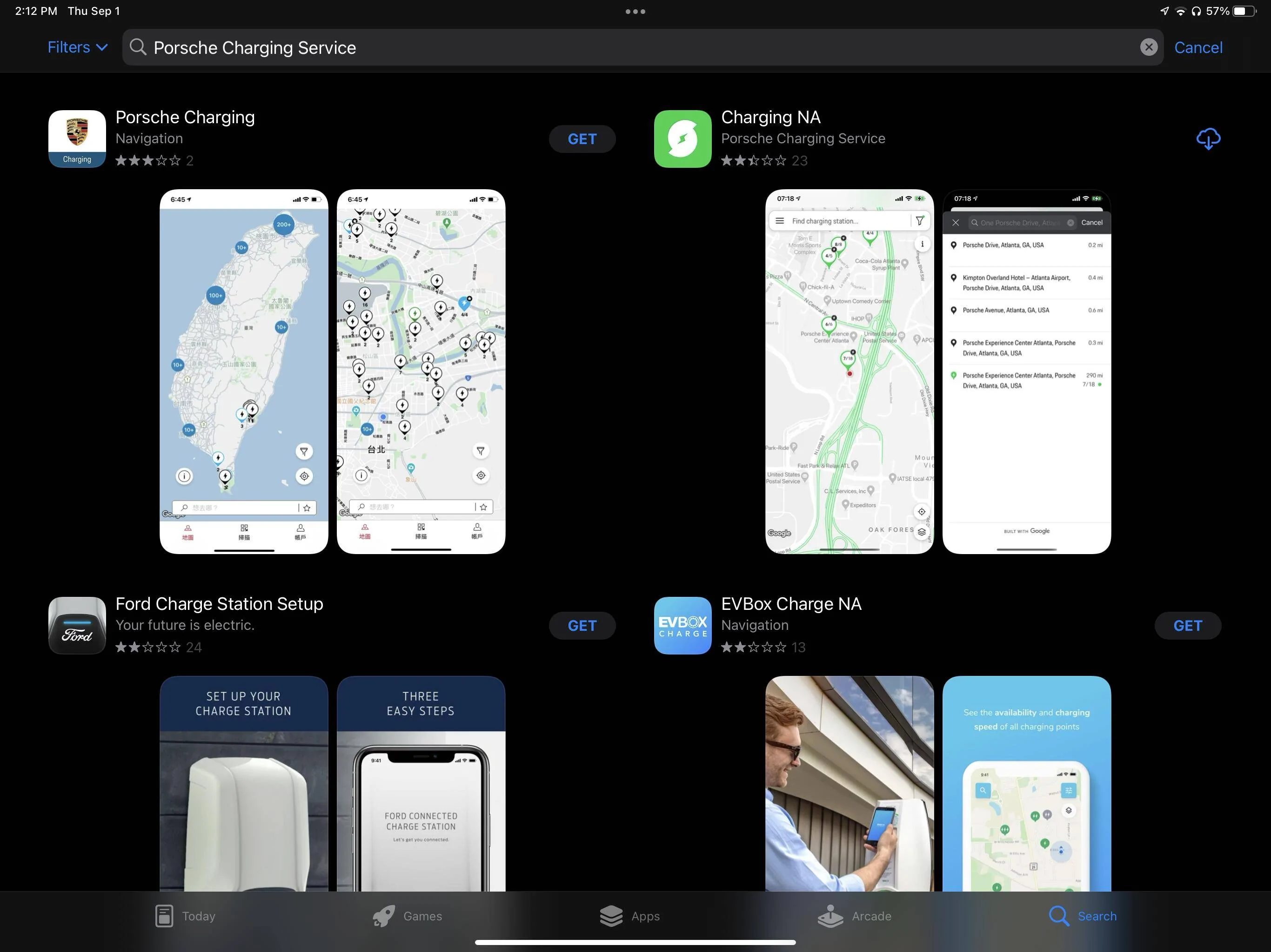

Hey, I picked up the car Tuesday, made sure the Plug and Charge option was selected, went directly to EA, and plug and charge didn’t work for the first time since we owned the car. I called EA and we were able to initiate a charge through the My Porsche App. I was transferred to Porsche Customer Service, and they walked me through this process…
1) they had me download the Porsche Charging Service app (Charging NA)
2) went to My Vehicle
3) disabled Plug and Charge by toggle
4) after 30 seconds, I enabled Plug and Charge by toggle
5) I waited to go back to EA until yesterday afternoon…Plug and Charge worked perfectly.
I hope this helps…

Is the name of the app you downloaded Porsche Connect? I don't see one called Porsche Charging Service.

Huge thank-you to @fusdoles for the simple trip to get Plug and Charge working again after the uPdate. No one at Porsche Online Service or my dealer knew about this so it proves once again how much this forum works for us all.
Reminder for anyone that If you have this problem just use the old Charging North America App to switch Plug and Charge Off and then On again with a minute or two in-between and it seems to reset something that means the EA chargers work again.

Will try this after disabling plug and charge only in the car for a few minutes and re-enabling it first... I do not want to download a sketchy (charging NA, 1k downloads, 1.6 star rating) looking app if I don't have to but glad to know there's another option. Hopefully Porsche does some better QA before their next software release so this doesn't continue to be a working/broken situation!
