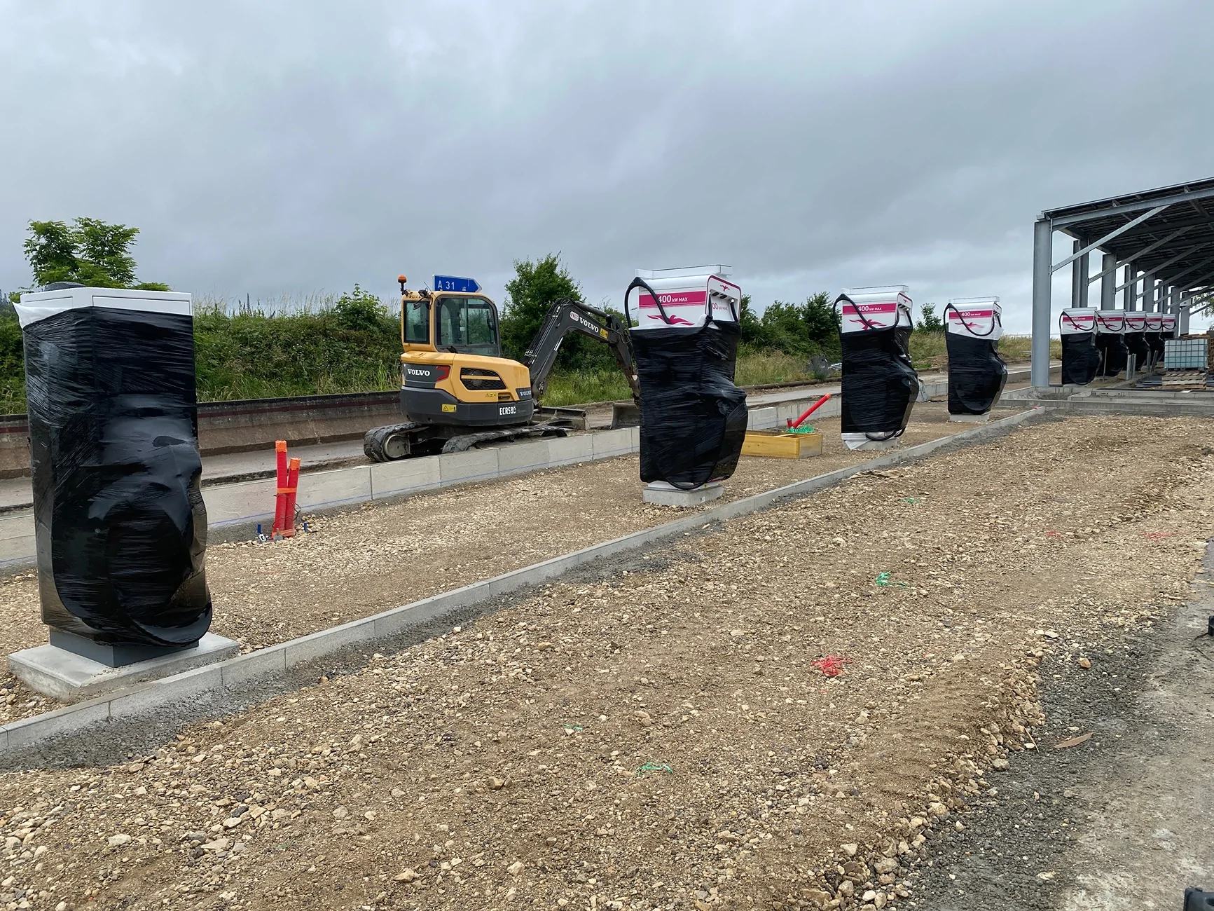

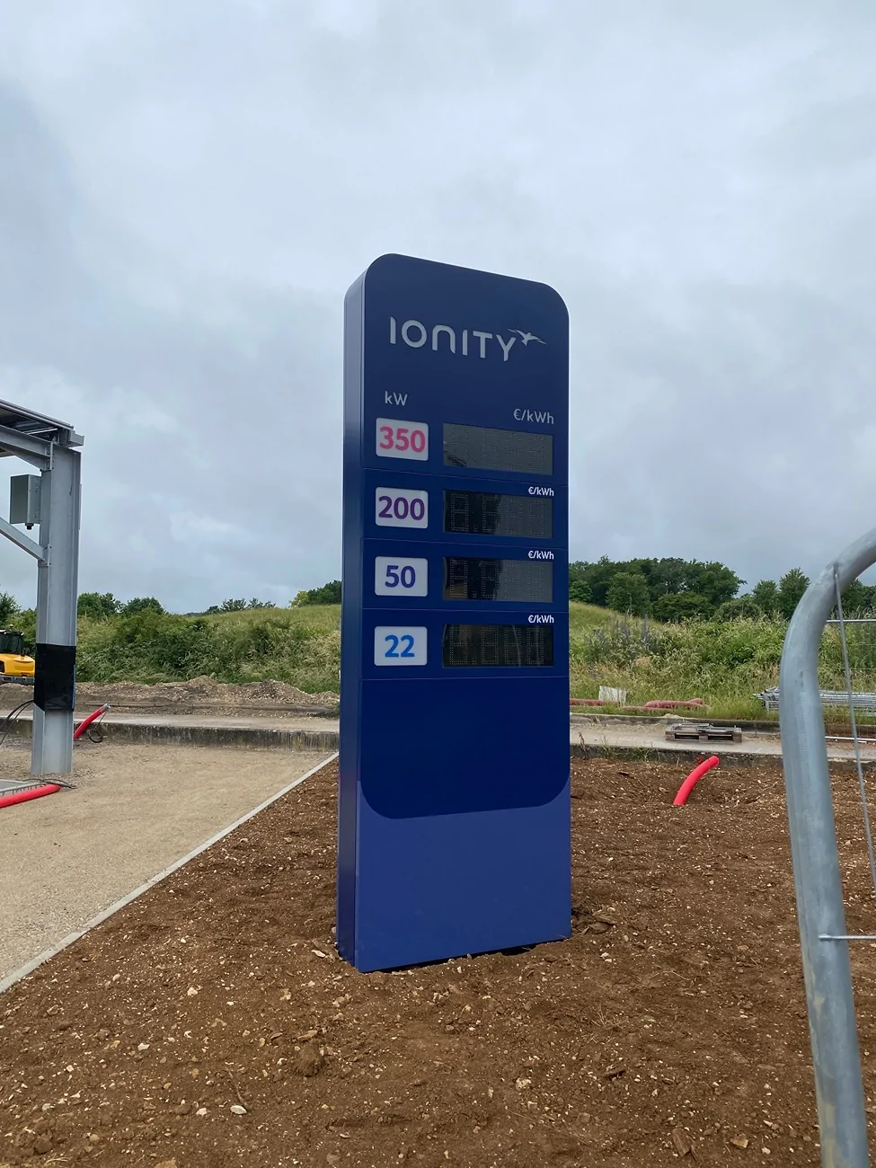

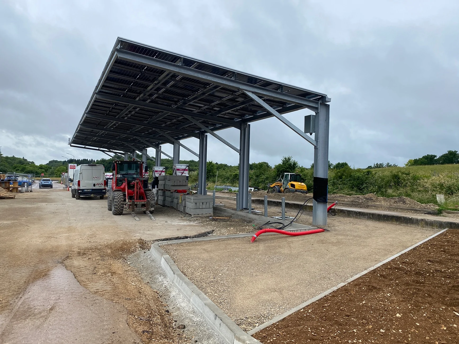

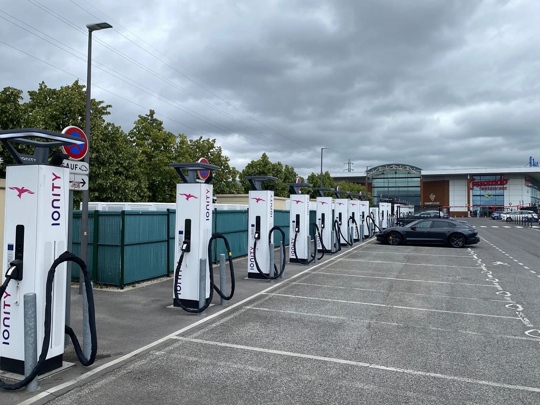

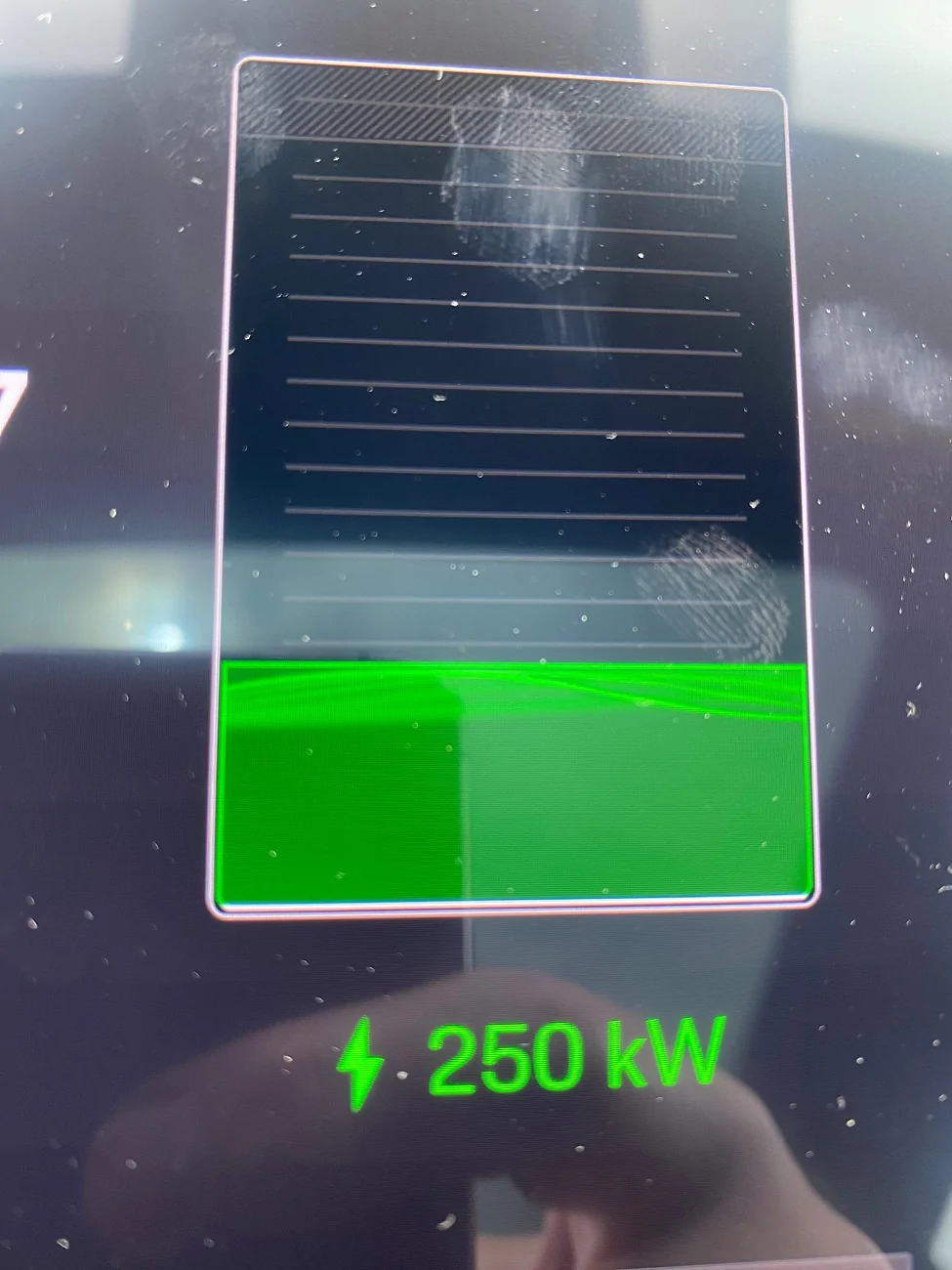

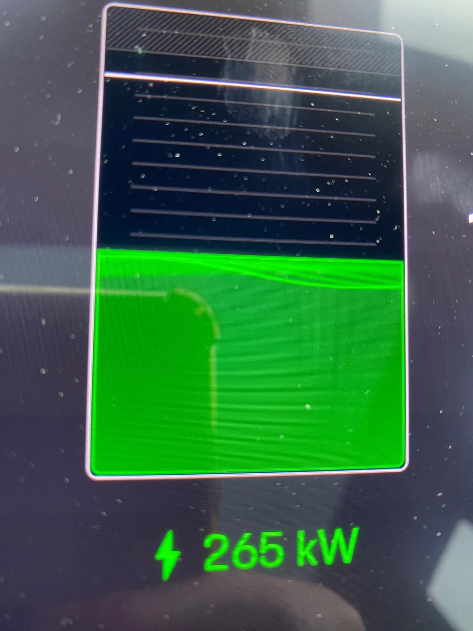

So I've just driven 1000km Geneva (CH) to Cambridge (UK) and the navigation and charge planner worked perfectly.
I will also add that the Taycan also performed superbly, the car just ate the miles on the autoroute, with quiet comfort, helped by innodrive.
I charged with Ionity, which also worked great.
It looks like a big Ionity build out in Langres Noidant France, they look to be creating a hub with around 20+ change units and even a pricing sign.
Later on the existing Iarge Ionity site at Champfleury also worked perfectly.

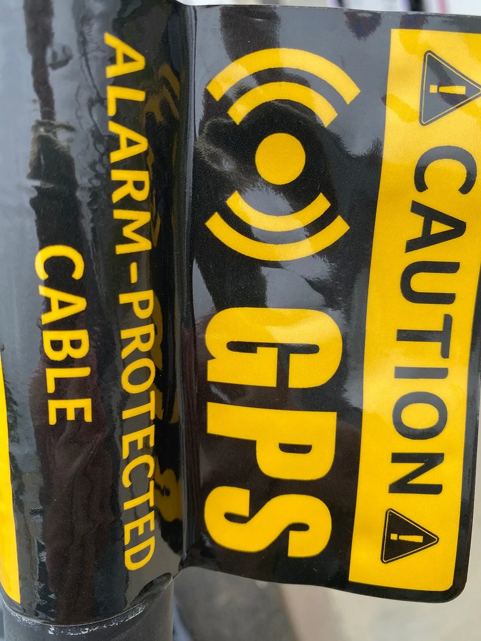

Last thing to note is that the Ionity cables now look to have some sort of alarm system to deter cable theft.
So the nav issue for me looks be fixed.
