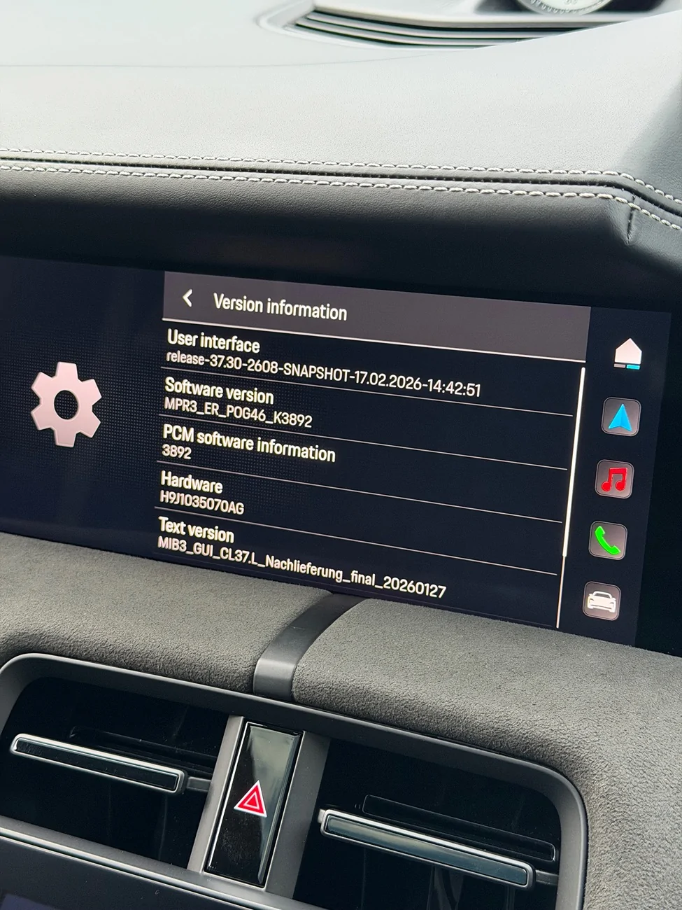

Mine is now all done, was in the dealer for 7hrs, of which I believe the software update took 5hrs. Impressed with the bits others have already mentioned and no crashes on the way home.
30% of my ownership of this car has been without a working Nav. Now this is fixed I shall wait for the next thing to go wrong
Just had my car delivered back to me! Very impressed with the service from High Wycombe today.
had a quick play with it on the drive to check versions and new features but need to get back to work now. Will give it a proper test this weekend.

Hi, I love the Snapshot version that took 4 months to be rolled out to customers.
chun
Feb 4, 2024
2,474
2,243
Taycan Turbo 2020, Cayman GT4
Still faster than the partial PCM update that took 11 months :D
They spent extra dev time (3-4 months + 6 months to decide) to develop a intermediary update 3892 - rather than release 4360 to every j1.1 car accompanied by the required ECU updated (it's a a lot more bilable service hours to do the 4360 update ).
The main concern is and has always been money, not keeping the cars up2date, not keeping the customers happy, not resolving issues promptly :D
