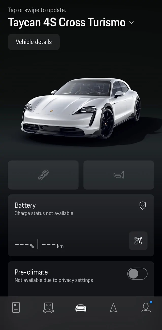

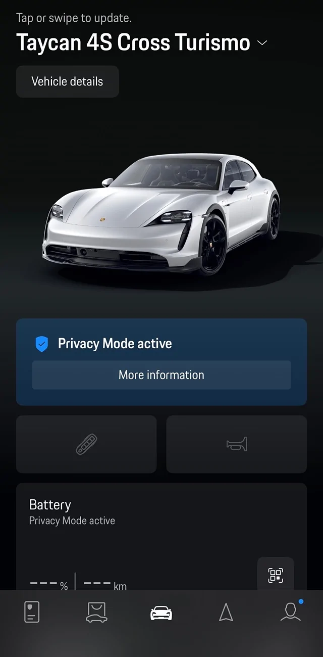

Got the software update last week and the PCM is working much better overall. However, I’m now stuck in privacy mode and can’t get it to turn off.
I’ve tried every option in the car and app, but nothing works. Toggling privacy mode in the app does have an effect — the blue “Privacy Mode Active” banner disappears, and the charge status/preconditioning labels change — but the actual functions remain unavailable.
The dealer says it’s not a known issue. Has anyone else experienced this after the update?

Try unplugging the 12V for a few minutes.
Make sure you are in a zone with good signal when you take it out of privacy mode; and it needs to be for a few minutes as it downloads some certificates

You need to disable it in the car, not in the app. What happens when you try that?
Also, I suggest you search this forum for "privacy mode" - it's certainly not unknown to get stuck in this state, though often it's due to Porsche's servers, not the car.

Sorry was a typo - I disable it in the car/PCM not in the app.
