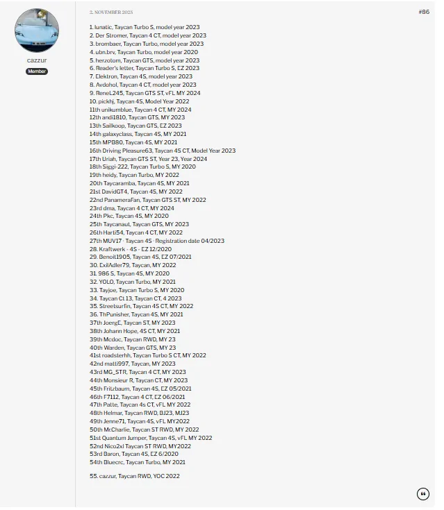

European Taycan owners in this forum and the German Taycan owners forum have been posting about Taycan hanging navigation systems since July.
Contact Porsche AG executives. Contact the press. Publicize this problem.

Wow, that's not only a long time but a large number of people - and amazing that OPC can still claim they've never heard of it happening before
The List was started End of August and I am confident I had issues prior to that. But as usual one thinks it might be a singular occurence o_O

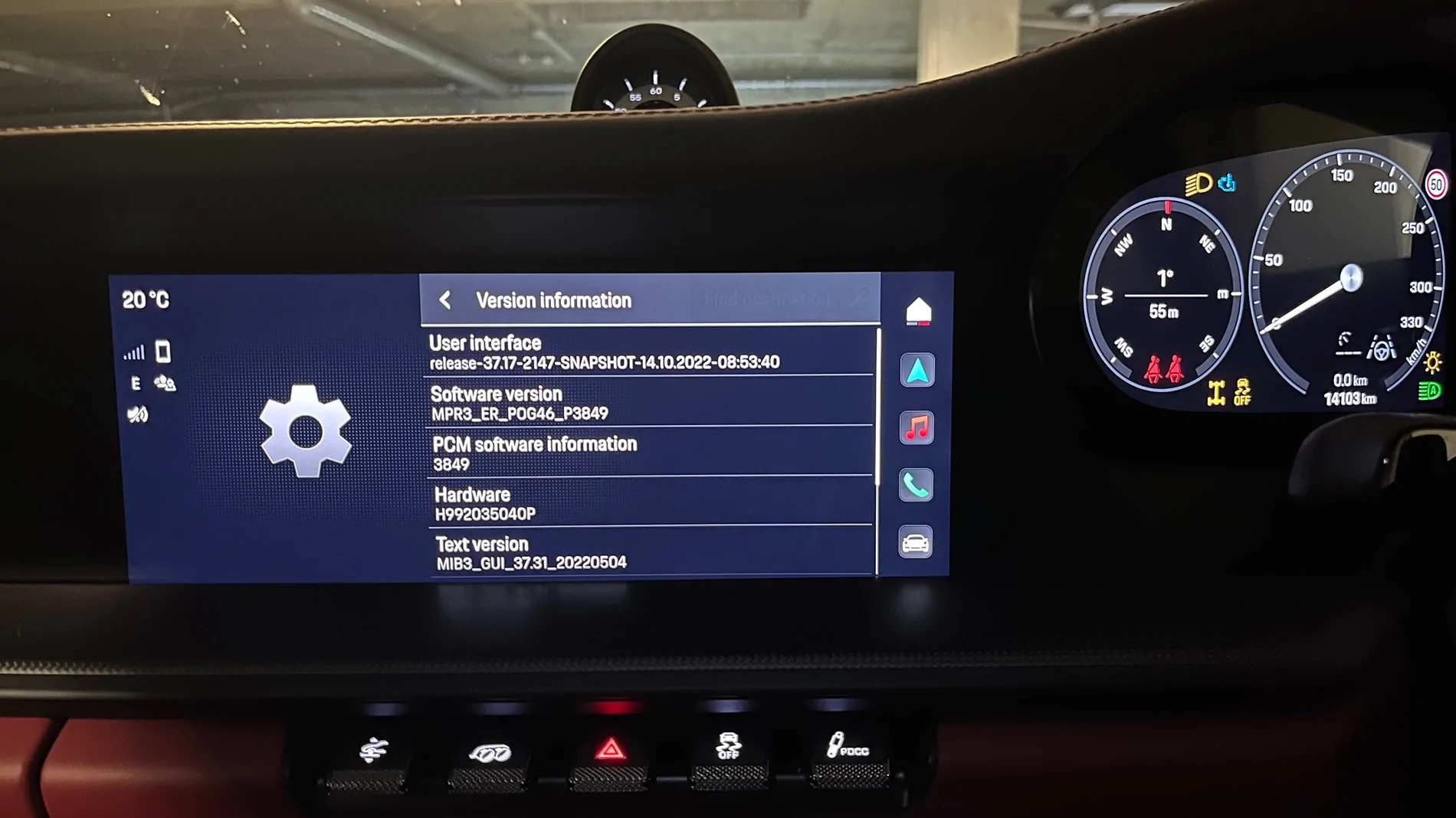

MY22 in the UK, on 3885 after a dealer update a few weeks ago, and I had the rebooting navigation on a 250mile round trip.
Has to be a bad map update or something if it's suddenly effecting so many cars at once

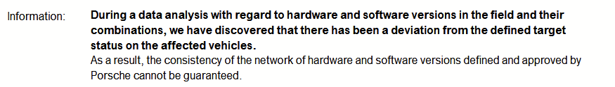

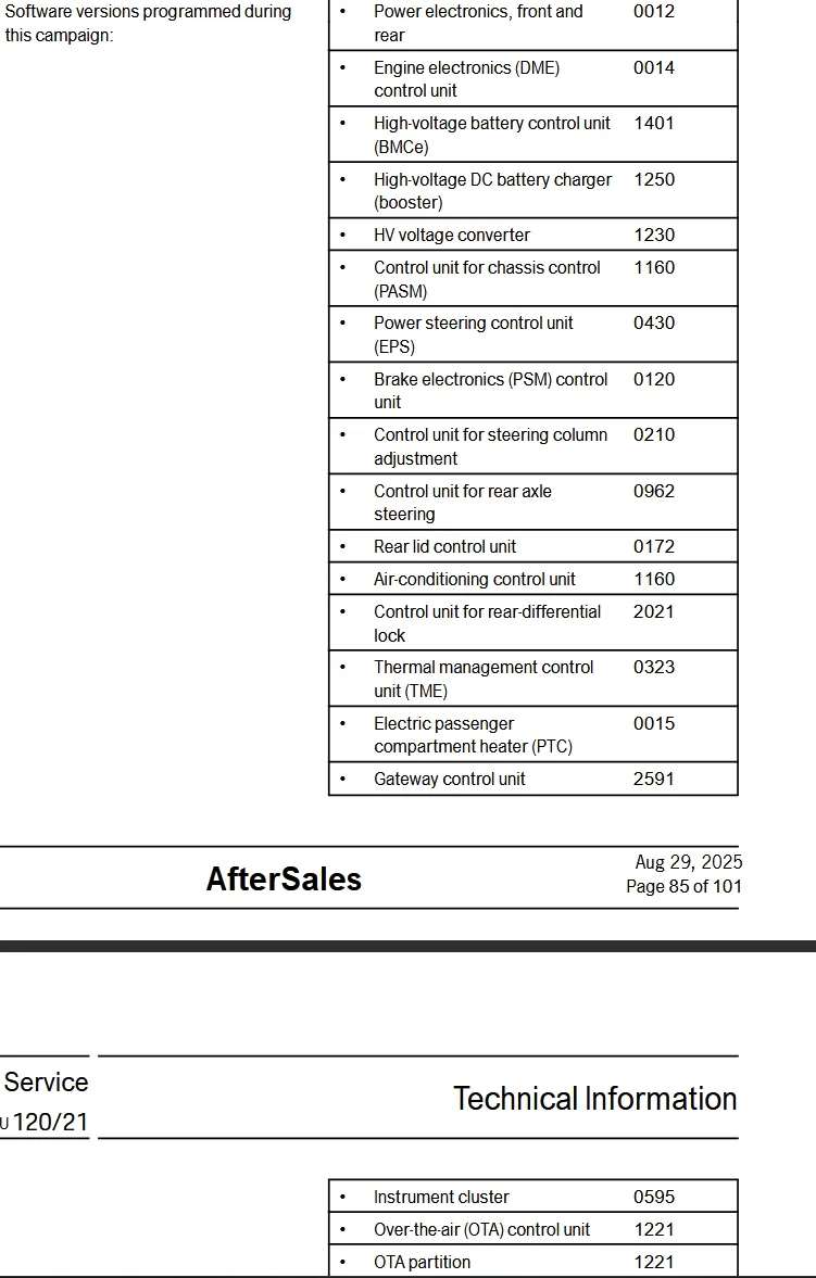

Since my dealer in Bern fixed mine & my friends, and knew about the issue and was sure they can fix it before even seeing the car - I say with 99% confidence dealers know of the issue and the solution.
I suspect Porsche is in a low-cost gliding mode, and don't want to have pricey service campaigns / recalls yet.
If I were you, I next time car is in service, I would ask the service of an extract of ECU versions.
The latest versions are public, so easy to compare.

Would be shocked if people with this issue have the latest ECU versions

I have just been in contact with my service adviser about these issues. Despite Porsche Smartmobility advising me to book the car in for outstanding updates to TI65/23 and 3885, plus @chun recommendation for WMH0, the answer I got was:
Just the heating system to change again.
But nothing about the software.
So yes COST SAVING MODE is implemented.
But now I will get the 5th if not even the 6th cabin heater! Unbelievable!
Do you think Porsche service will supply that information.
’I looked through that long document for the campaign and noted that there were many sequences scheduled for updating all ECU’s. And each sequence seemed to have a list of the updates performed for the different elements.
I have tried to ask for the update, and response was there is none. I will ask for a list of all the sw versions in the different ECU’s now and see. But I guess the information you have shown is not public knowledge?
Worth a try though
