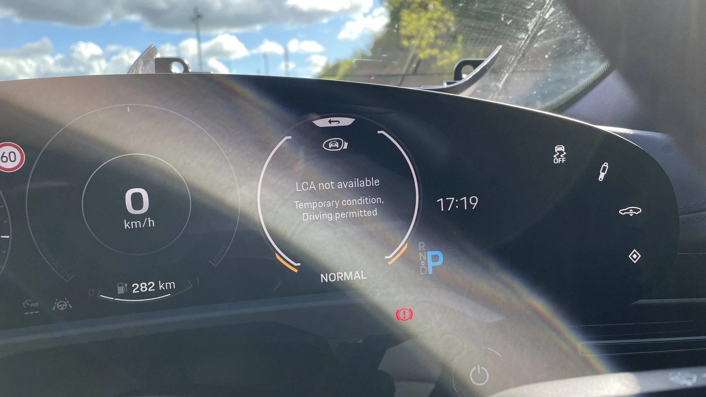

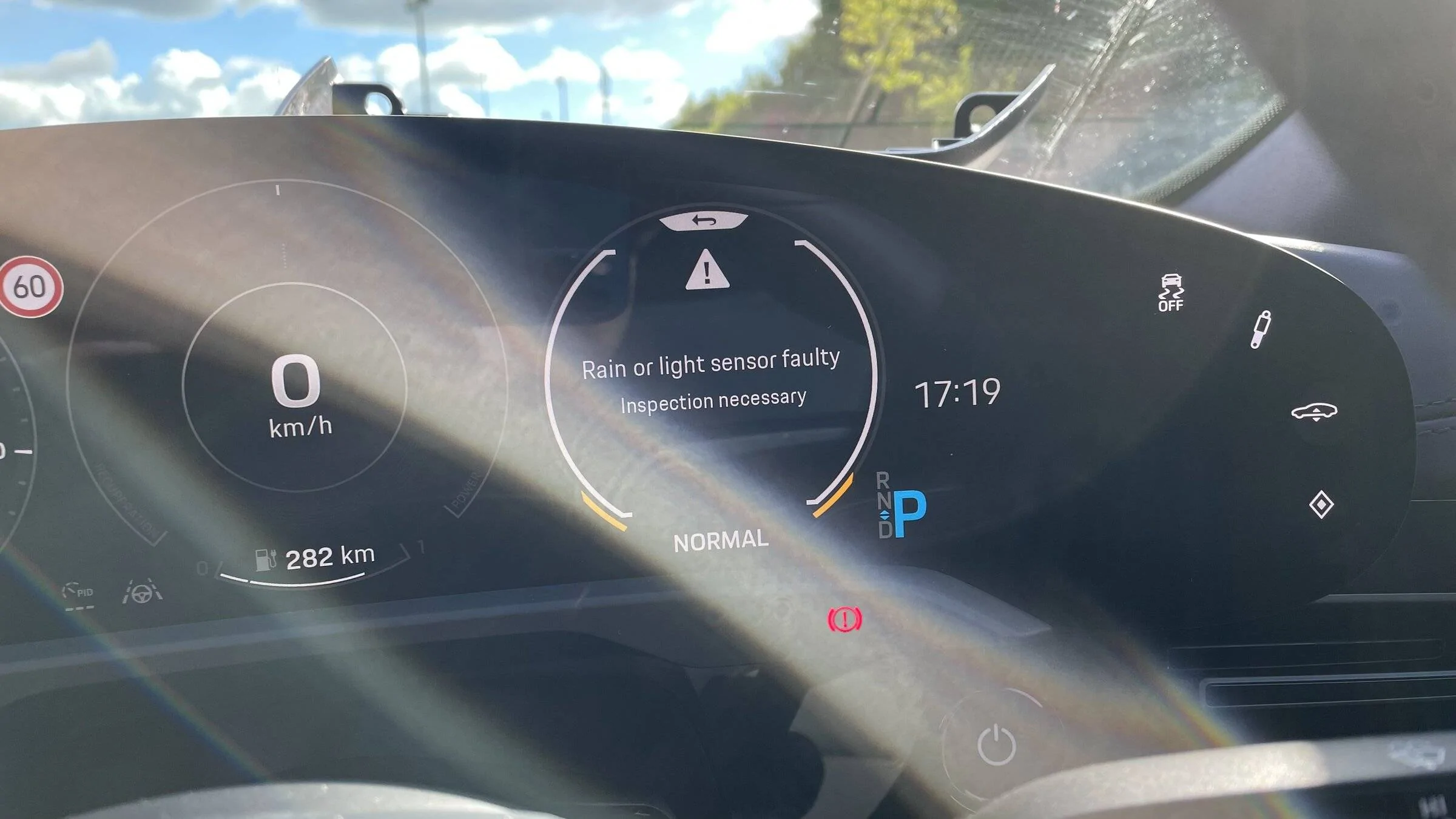

Quick question for those that have installed this: is it necessary to disconnect batteries and such before doing the install?
98
3,572
8,002
Dublin, Ireland
www.targatrips.com
No need. When you disconnect the required cable that plugs into the dashcam – you will see two warnings appear:
Porsche Taycan Fitcamx dashcam installation IMG_0187
Porsche Taycan Fitcamx dashcam installation IMG_0188
This is perfectly okay and they will automatically clear once you've connected the removed cable into the dashcam and plugged the dashcam into the socket where you've removed the original cable.
