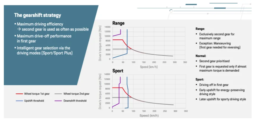

That said, I don’t think the Taycan really suffers the same issues. In an ICE, you don’t typically cruise at high rpm, which means you often need to downshift when you want more wheel torque…and it’s reactionary and delayed in automatic mode.
But cruising at high rpm with an electric motor is less of an issue. So, it can cruise in an optimal torque gear without needing to downshift when torque is requested.
If you look at the the shift graph for sport, the torque request is nearly vertical and nearly down to zero torque.
This means that the shift point is pretty much always at the same speed, regardless of how you drive, and you aren’t typically waiting for a downshift for torque.
Plus, there are only two gears. The band of speed in which shifting even makes sense is much narrower.
In practice, I don’t think it’s really an issue.
Plus, coasting is awesome. Not really a function of the two-speed gearbox. But a difference to Tesla.
