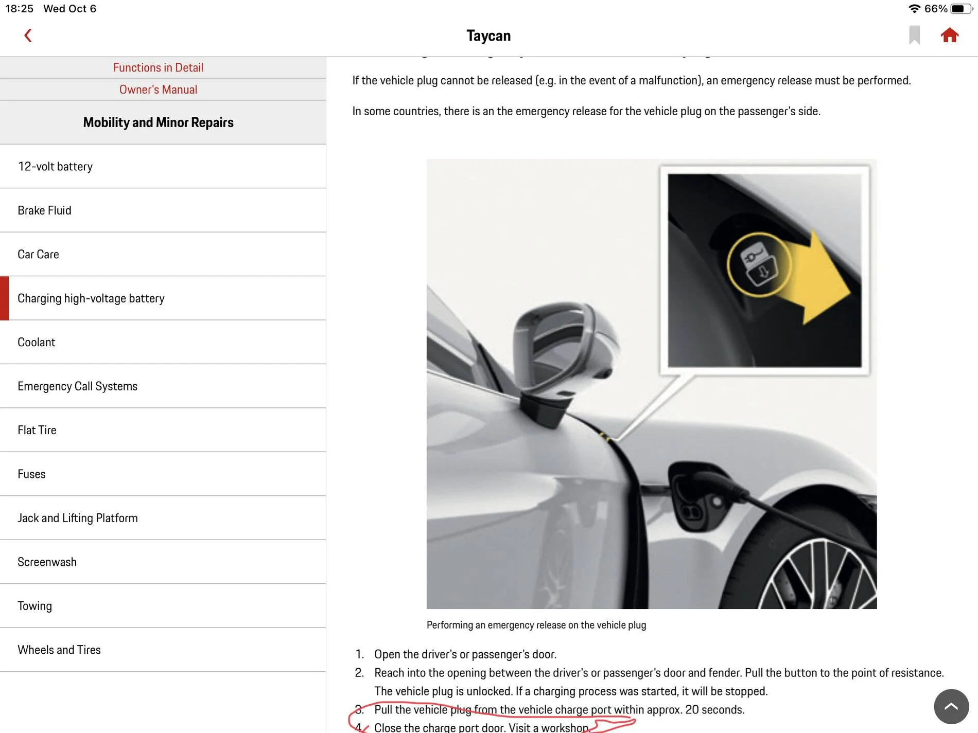

Had to do that once (out of 4 charging sessions) at an EA charger. Does anyone know how to get the cord back into hole?
Good to know app
Performing an emergency release on the vehicle plug.
States visit workshop.
Hope this is what you were looking for and helps.
