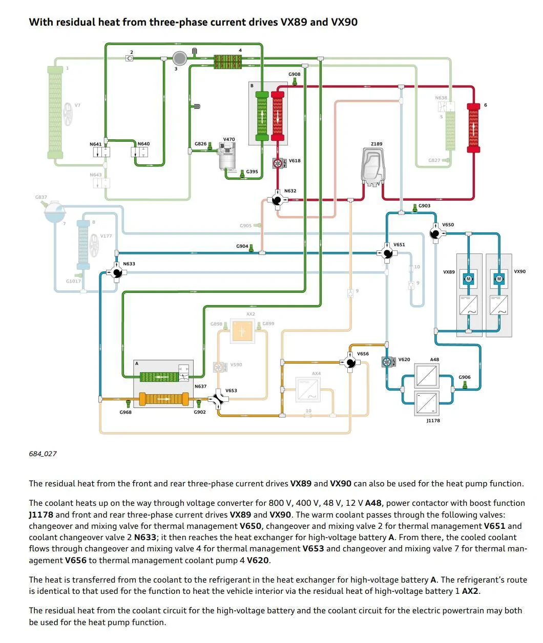

It remains a mystery to me whether the "Heat Pump" is a true heat pump or part of a waste heat coolant pumping circuit.
heat pump in the Taycan and many other BEVs mean: adding a few valves to use the A/C compressor to reverse and act as a heat pump
this is a nice explanation:
Porsche Taycan Heater issues anyone? 1643290446957
it should be also quite obvious that the heat pump won't have any meaningful effect on heating/preconditioning the battery of a cold car. Only the HV heater (Z189) is doing it and wastes a lot of energy for that.

Thanks. This is very useful, I had always questioned whether the Taycan "heat pump" was a classic heat pump (valve that reverses evaporator and condenser function). With no HV Heater (i had a bad one) I would have expected the heat pump to be able to warm the cabin after 20 min, but that didn't happen. So I have questioned what they called a "heat pump" might be a heat recovery system to recover excess heat from the battery and use it for the cabin.

heat pump function will work fine on longer high way distances especially after a fast charge, when the battery is a 700kg heat energy buffer

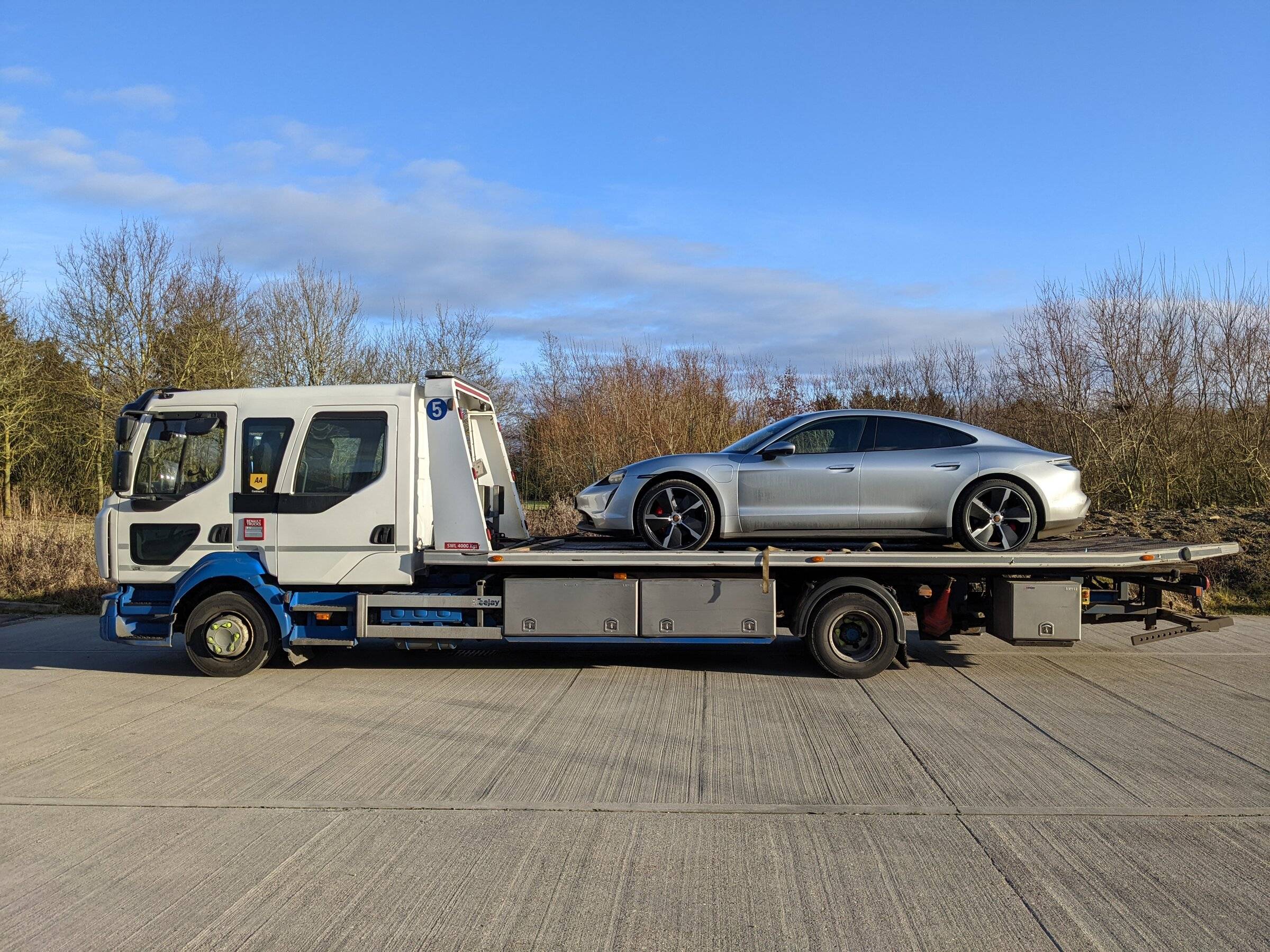

Mine packed up a couple of days a go. Dealer picked it up today and exchanged it with an A6 estate!
What's the current lead time for the part?
