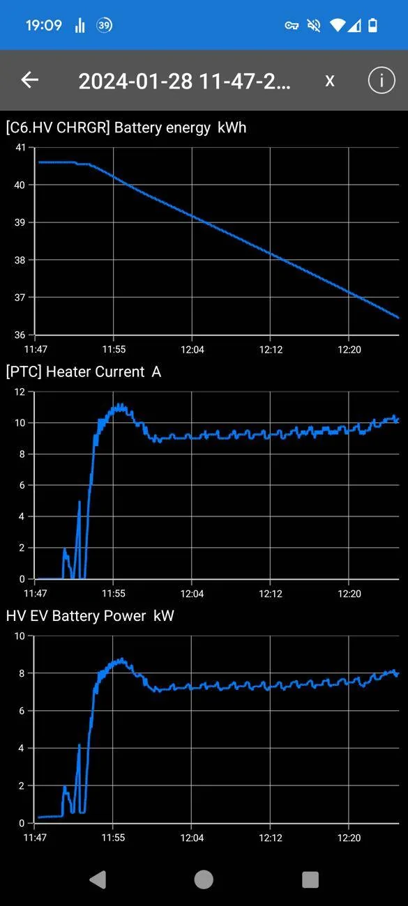

Take the example below: car was steady for 20mn, i just had the heater working 100% for about 30mn. I lost about 5kWh (from 11:50 to 12:20)
Had I drive 1 km during that time (for instance stuck in traffic), consumption would have been ... 500 kWh/100km ! On the opposite, if i had done 100 km during this time (driving on average 200km/h ...), the extra consumption due to heater would have been negligible, +5kWh/100km

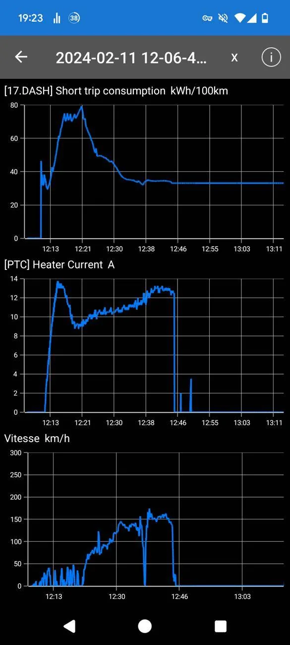

Here an example where i was actually driving: I started the car, next charging stop would be 30mn from there.
From 12:10 to 12:20, heater is at max., I'm downtown, slow avg. speed, consumption goes up to 80 kWh/100 km...
I then reach the highway, speed increases... and consumption goes down because the extra energy from heater is now small (but not insignificant) compared to the one needed by the engine.

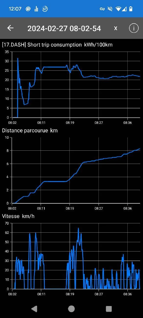

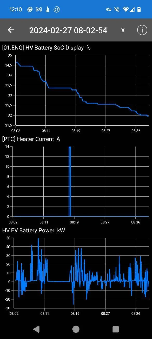

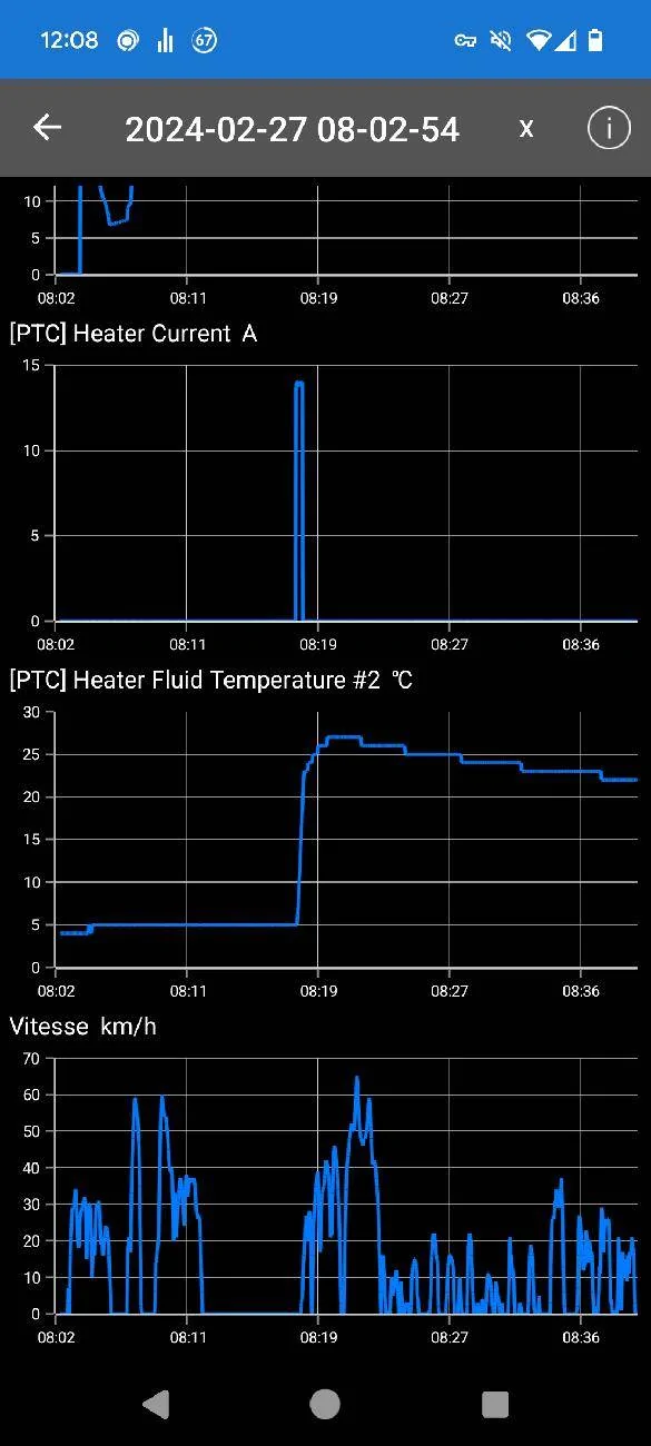

first test this morning ?
- car didn’t move for 48hrs, parked outside. Battery temperature was at outside temperature (4°C). both temperatures didn’t change during this short trip (<10km)
- no preheat, no heated seat, no AC, no music, no sport sound, … only headlights needed
- started the car in range mode. drove for about 3km, then stopped to buy croissants (??‍♂) for 7mn, and drove again. see below.
Porsche Taycan High consumption after first start screenshot_20240227-120704
- heater didn’t start, heater fluid stayed at 5°. short trip consumption (see above) was « normal »: street is going up and down. I stopped ... and then heater started when i went back to the car. Not clear why ... perhaps because the car went back to normal mode for a few seconds. not much effect on the consumption, but these few seconds were enough to raise the heater temp to 26°C.
heater didn’twork again, and that temp went slowly down for the rest of the (short) trip
Porsche Taycan High consumption after first start screenshot_20240227-120858
- SoC went down as expected (no phantom drain), power required went up to 50kW during some accelerations, with negative values when regen/breaking.
Porsche Taycan High consumption after first start screenshot_20240227-121006
the Short trip consumption was still very decent for a cold morning (4°C) at the end: around 21 kWh / 100 km… close to summer values.
