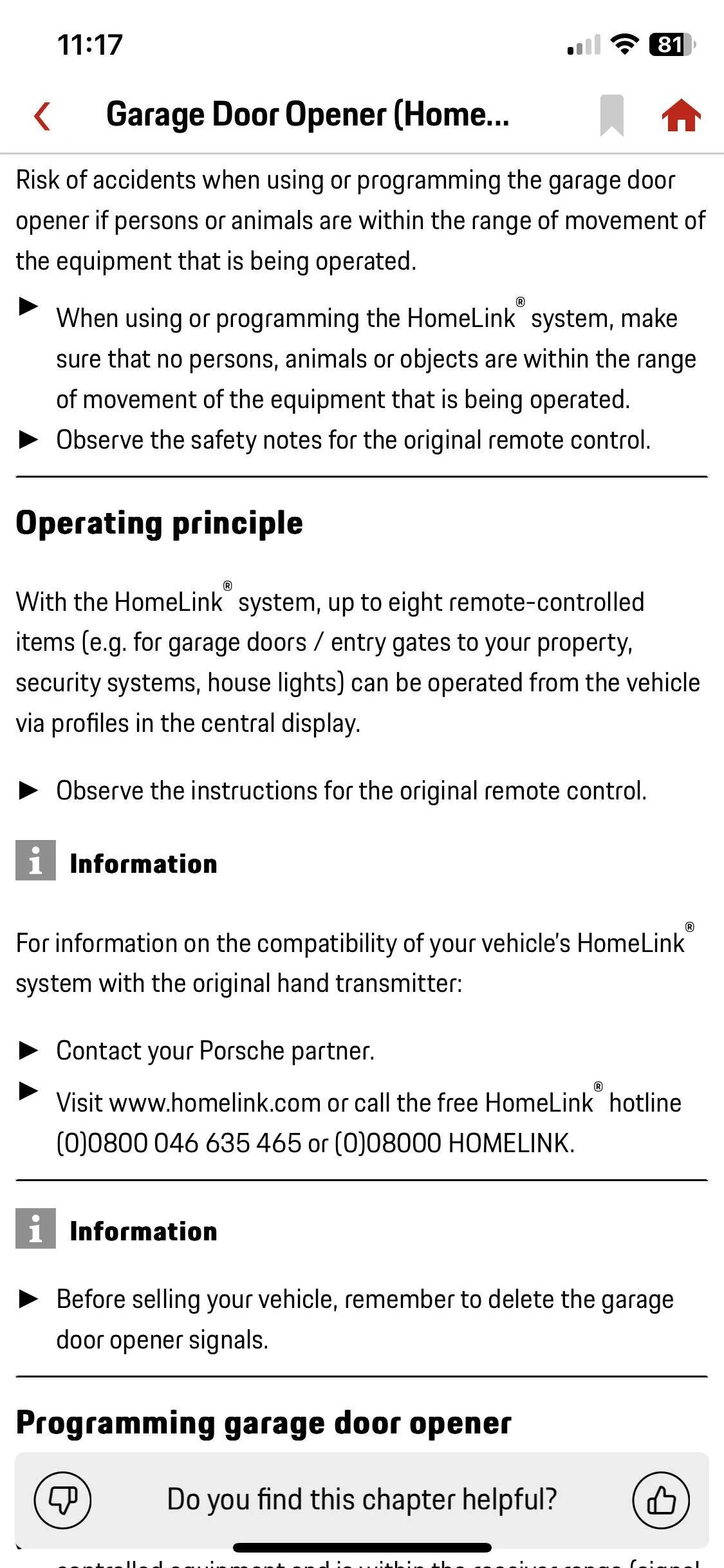

How many separate devices can be programmed?
In most cases I will just need to open the gate and the garage door where my Taycan will live. However there may be occasions where I might park in a different garage so it would be helpful to be able to have more than one garage programmed. Is this possible? From memory there were 3 or 4 slots available when I had homelink on a 991.
According to Good to Know it’s up to eight:
