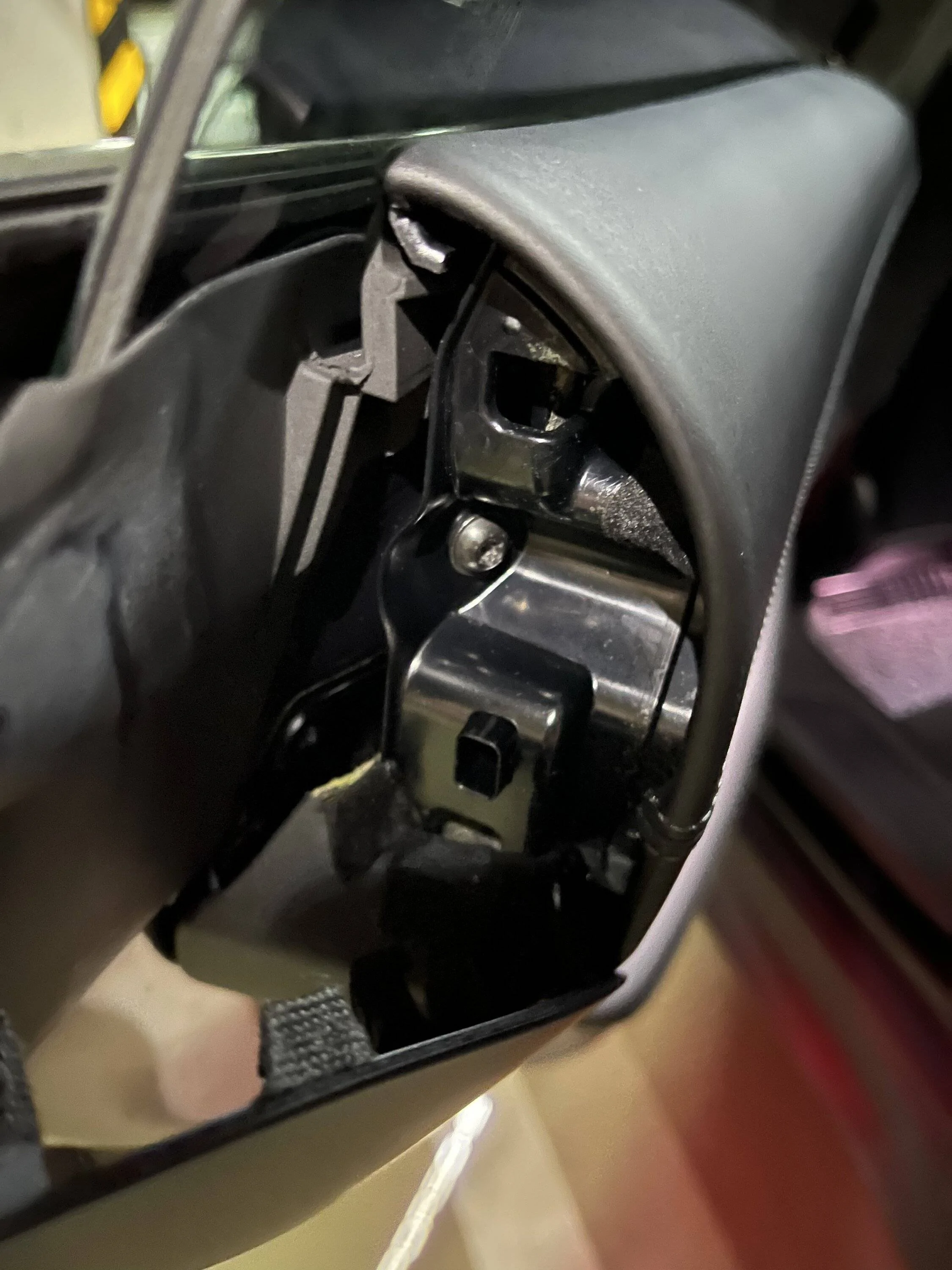

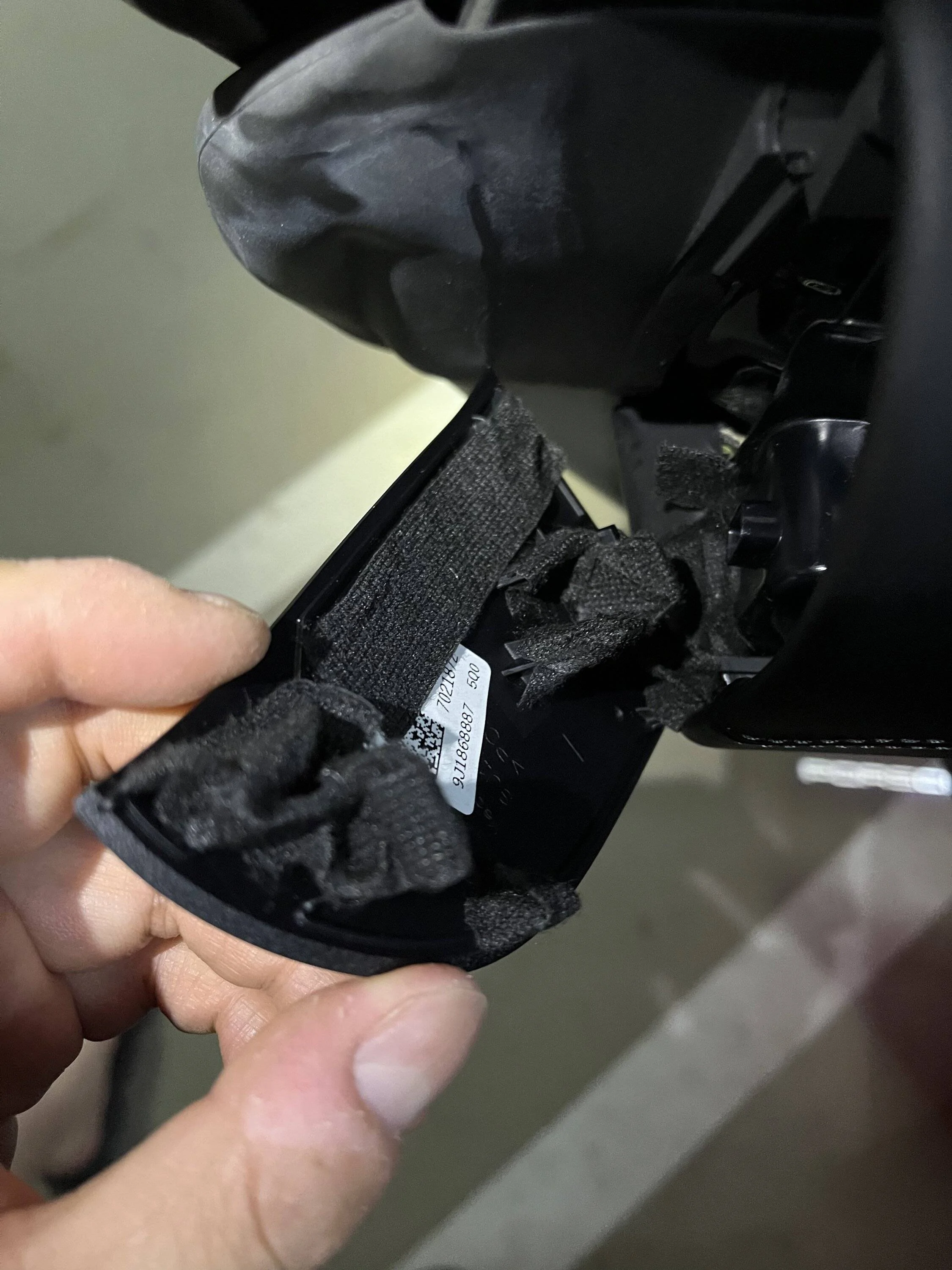

My rattle source 90% is from this plastic panel, just opened it, and taped all the hooks by foams and installed it back, it sounds much silent afterwards.

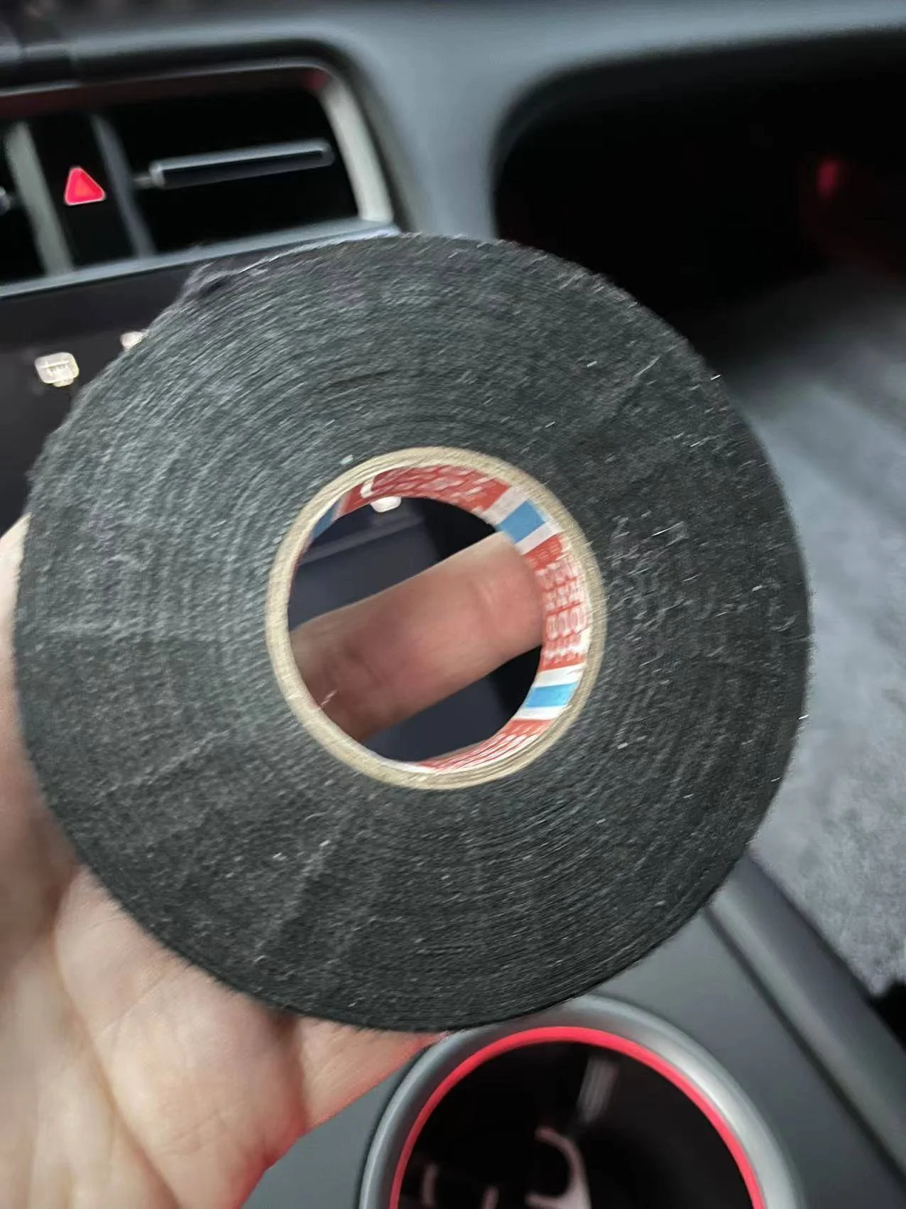

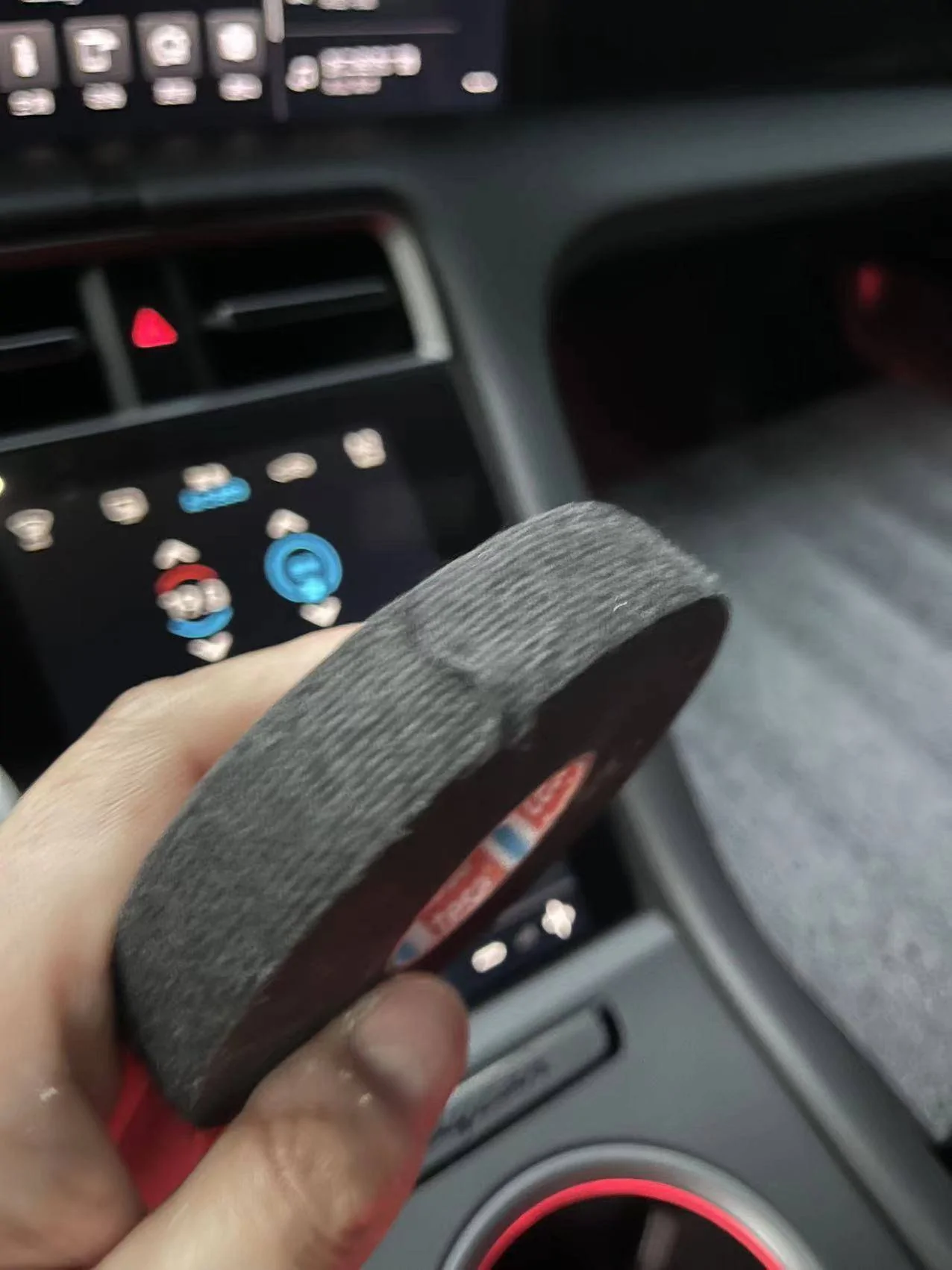

I used this foam tape, this is excellent to remove rattle on the car:

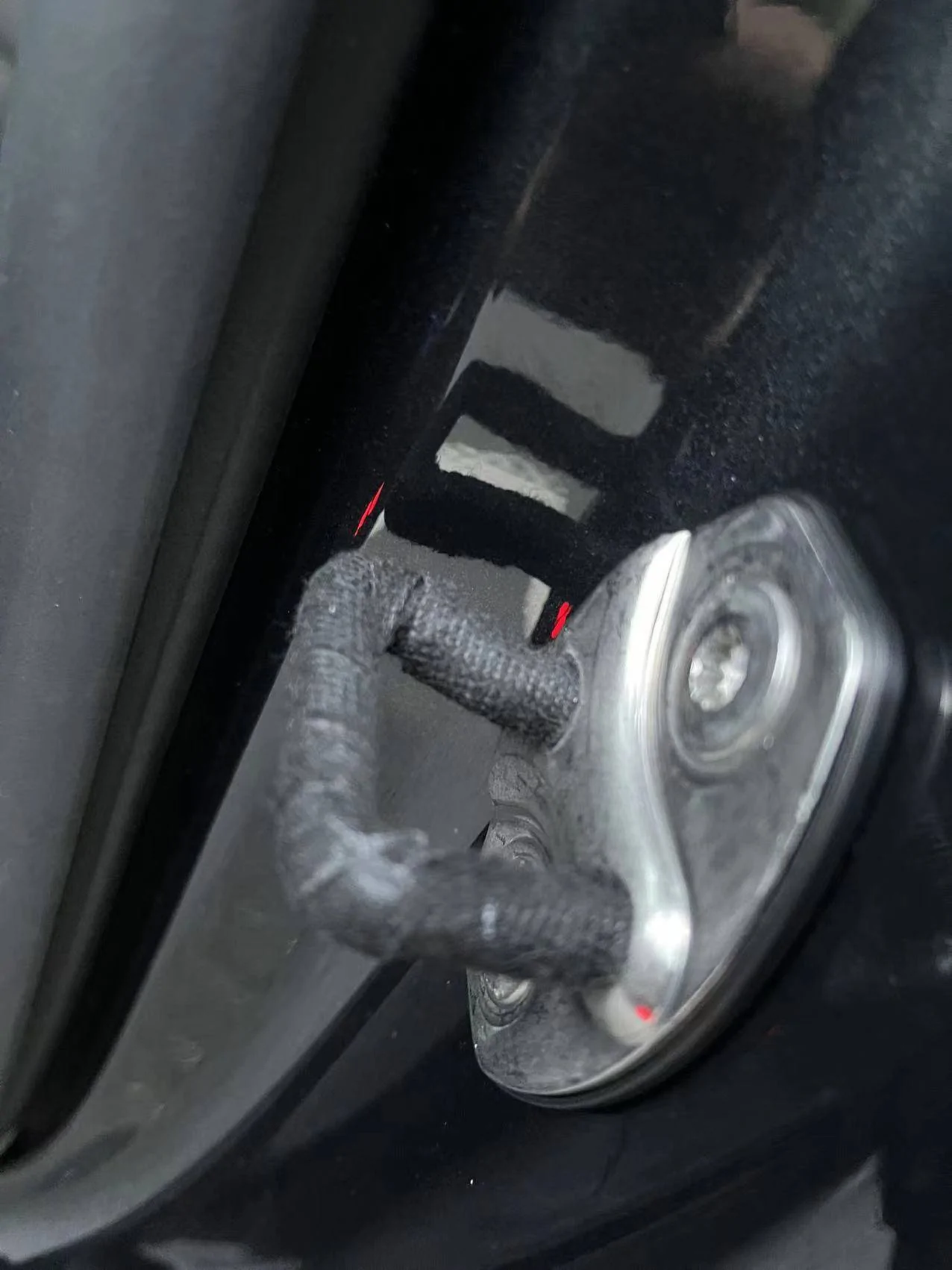

Then I found there are still some little rattle, I tried to tape the door lock hook, to make the door locked righter after closing the door, I surprising found it's almost 99% clean after doing this small trick. If you tried all the other ways, still some little rattle, you can try this, might bring some positive result to you as well.

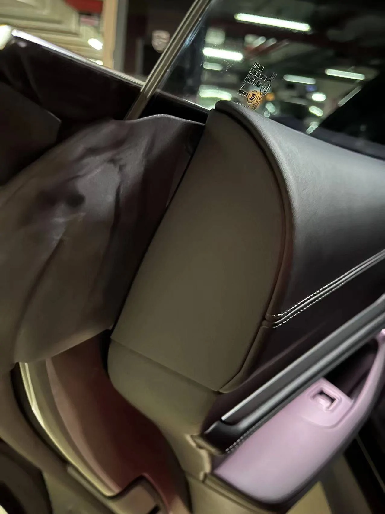

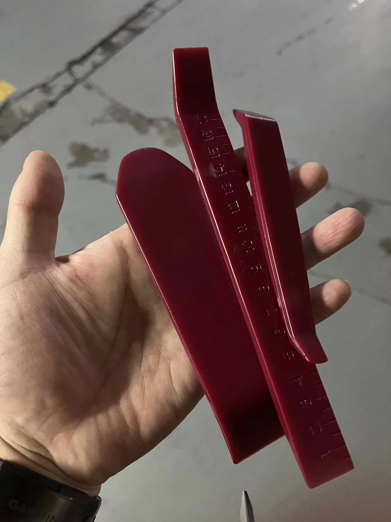

The tool I used to open the plastic panel on the door. very handy.

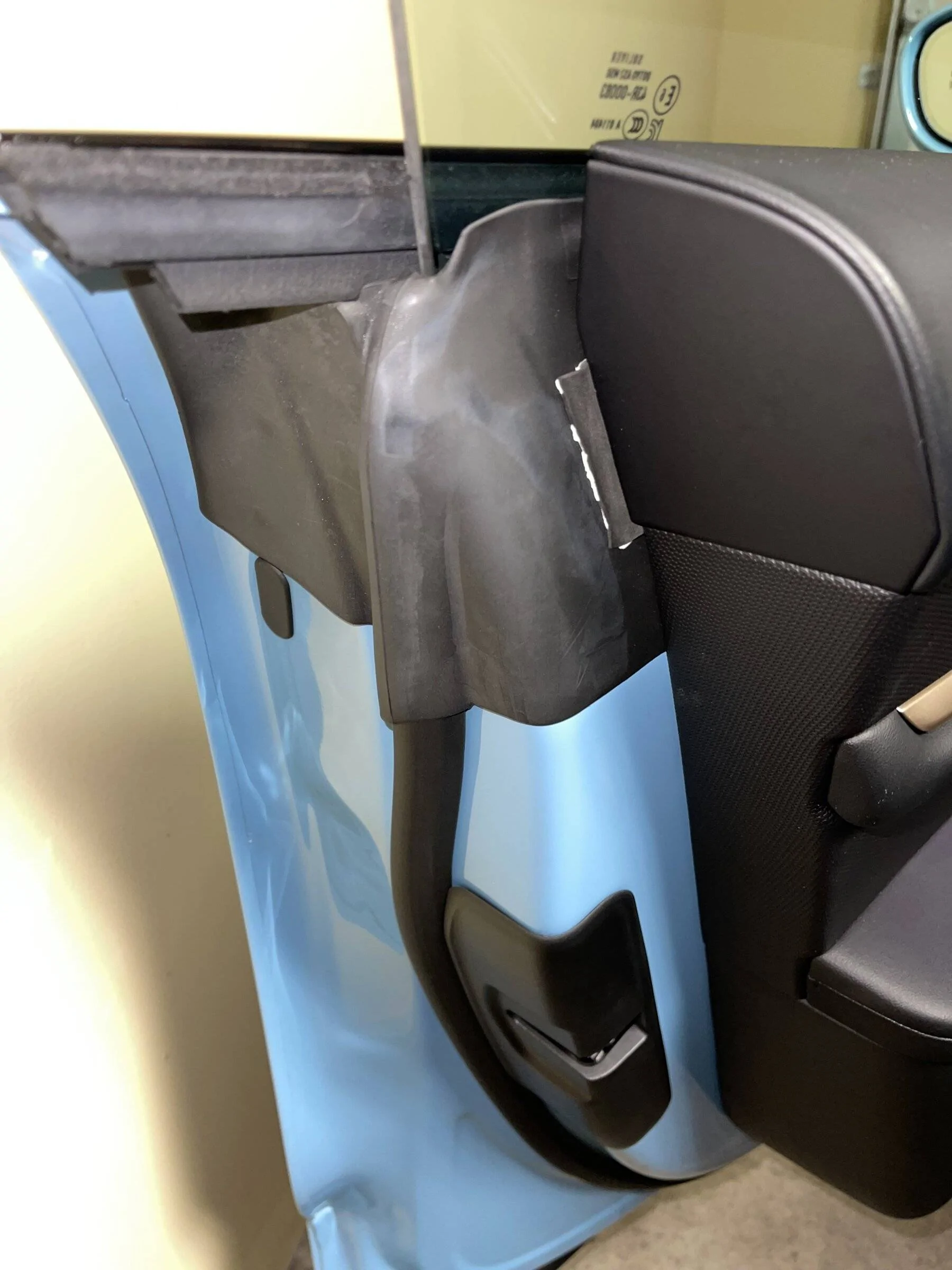

I reopened my panel, took the picture. Tape all the hooks both on the panel and on the door side.
