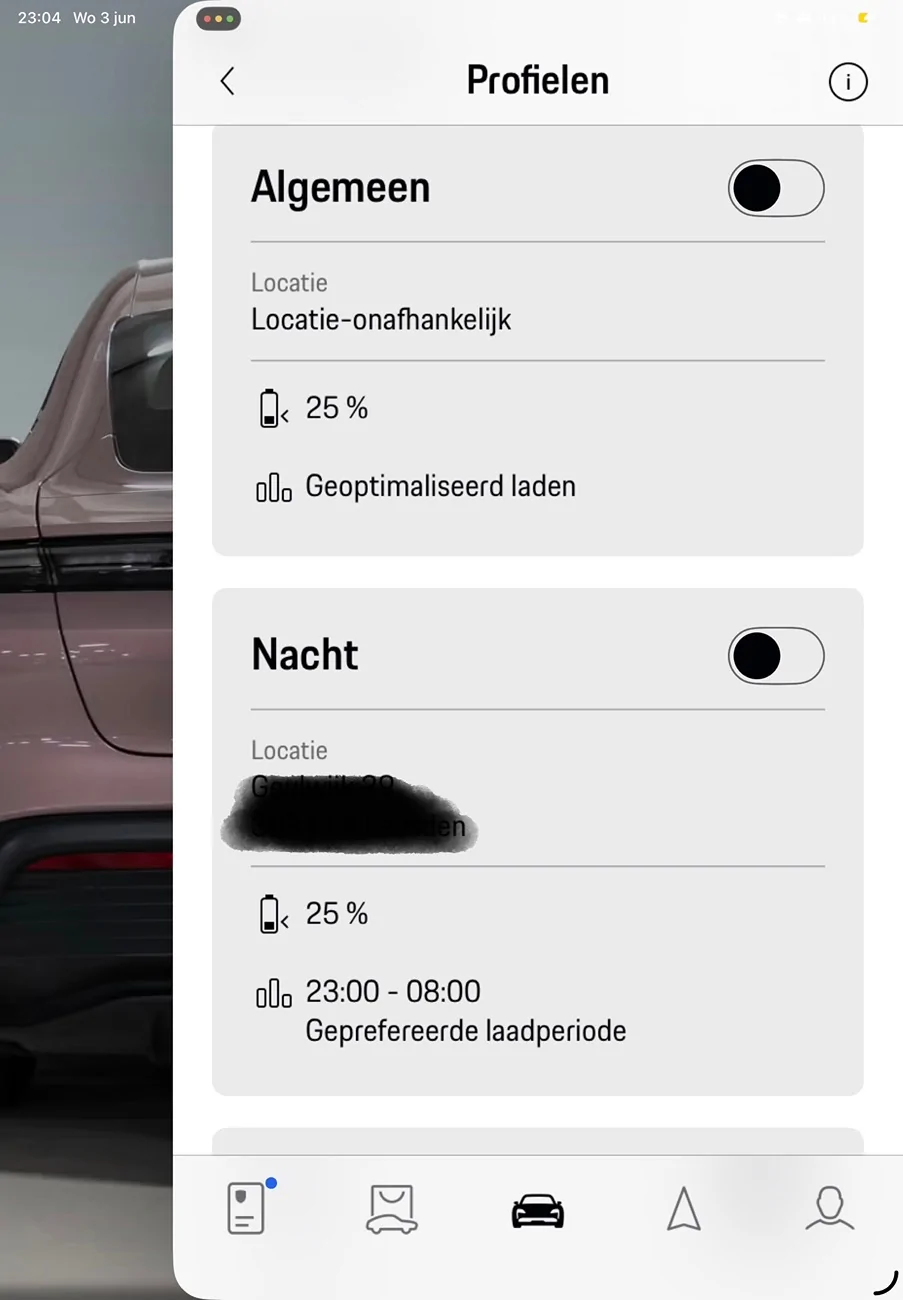

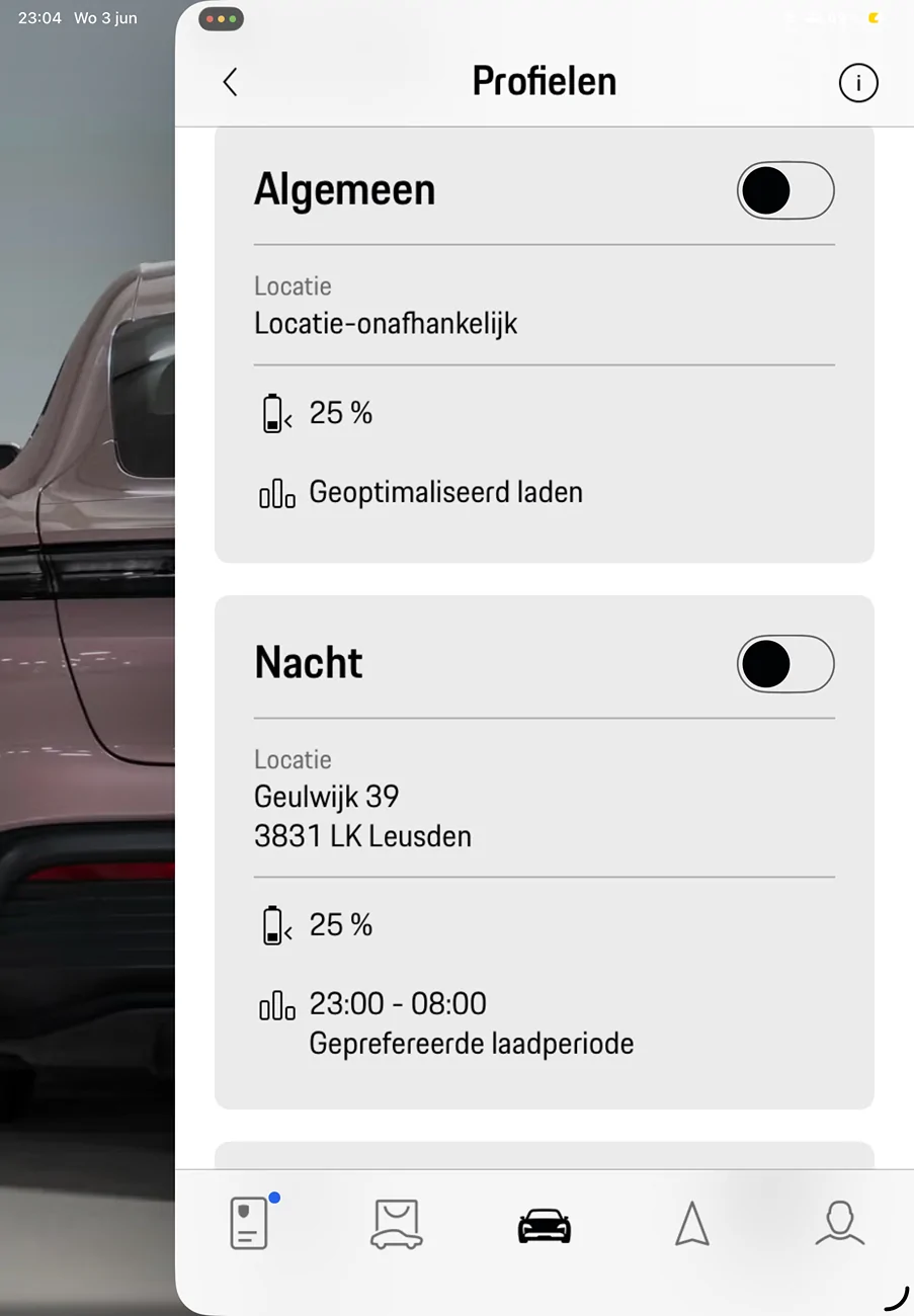

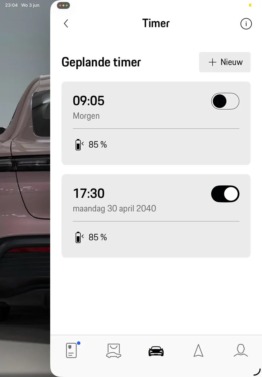

This is how I do it:
I have 3 profiles: 1 general, 1 for charging night hours and 1 for charging day hours. It’s set on minimum 25% so that is always the immediate target. At 25% the timers kick in
I have 2 timers: the first one is always “tomorrow” but I change the day and time to my needs everytime I start a charge. It’s set to 85%. The second timer is set for a date in 2040 And is on all the time. Any future moment will do here, it just prevents the charging going back to default; which is charge up to 100%.
The pics might help clarify.
o, I manually program every time and then activate the appropiate profile, that’s why you see them off in the pics.
since I don’t have a day job my needs vary a lot.
hope this helps!
