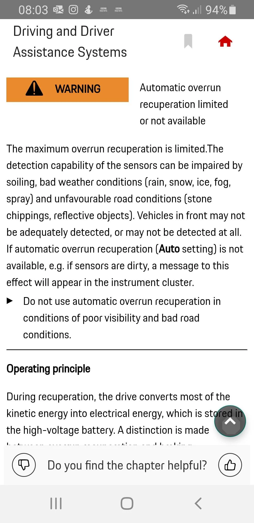

This is normal and is dependent on certain conditions - check the Porsche Good To Know App for details but there is a reliance on following the vehicle in front.
I tend not to use either manual or auto as the appears to regen in any case according to the power meter.
Porsche Taycan Inactivated recuperation Screenshot_20211226-080311_Porsche Good to kno

I've not found auto/adaptive recuperation disengagement to correspond with bad visibility or road conditions. It can be frustrating to use but nice when it works. My Audi e-tron's adaptive recuperation consistently works without issue compared to the Taycan's system.
I have calls/texts to my dealer for this exact issue….it happens virtually every time I’m in Auto Recuperation…regardless of weather, state of charge, or whether I’m in normal or sport driving mode. Something isn’t right….and I want them to fix it. I could leave recuperation on or off, but this is an option and I prefer driving in Auto…so I want them to figure it out. Seven weeks removed from delivery…550 miles on the Odometer. They‘ve already fixed the bug where my car was in Drive at a light and switched into Park on its own…
