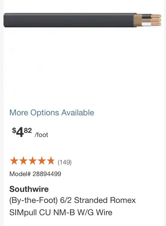

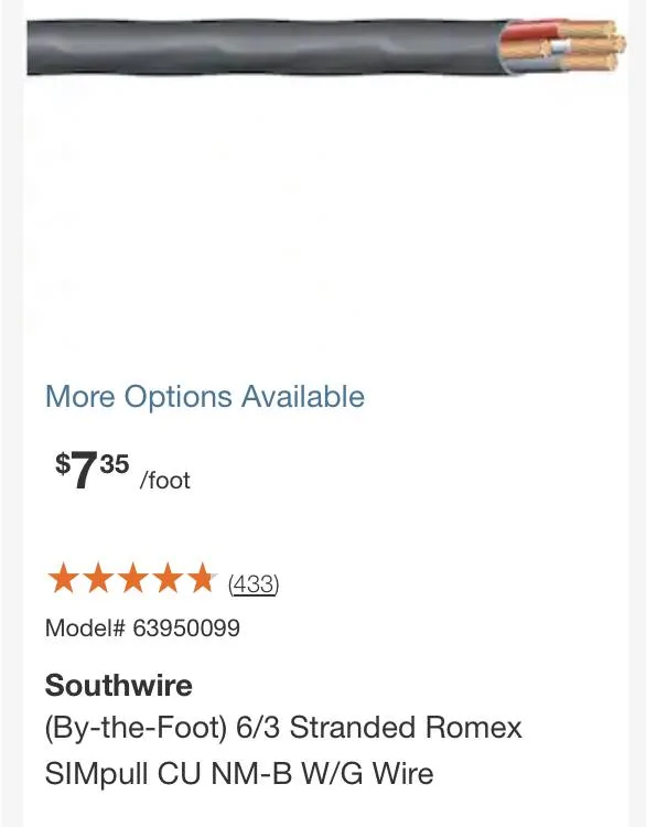

quick check w/home depot website
6/2 (3 wire) cooper is $4.82/ft vs. $7.35/ft for 6/3 copper
25ft @ 4.82/ft = $120.50
25ft @ 7.35/ft = $183.75
$63 savings on 3 wire (hot hot ground) vs. 4 wire (hot hot neutral ground) - and the neutral is un-necessary and unused for an EVSE - but required by code for a NEMA 14-50 outlet (but not a NEMA 6-50 outlet which is an option also).
if the wire pull is longer the savings could be even more significant.

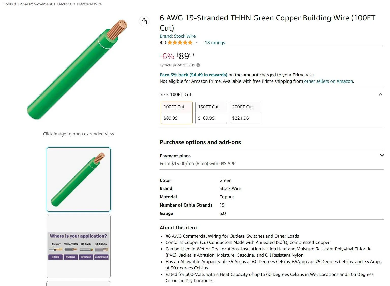

They sure charge a premium for Romex wire. Standard AWG6 THHN is under $1 per foot, quick search on Amazon yielded this:
