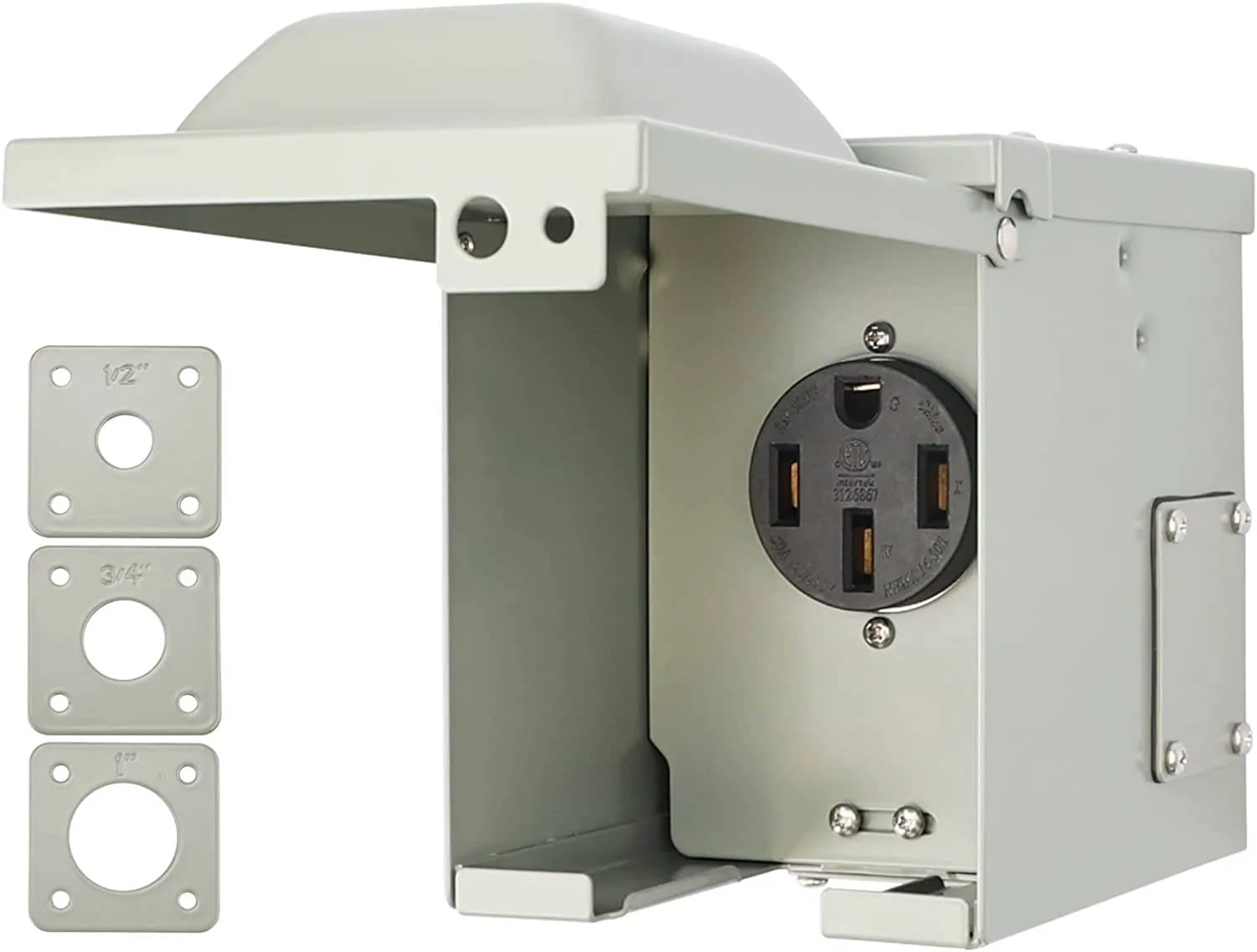

Hi folks. I'm thinking about installing an external Hubbell NEMA 14-50 to use with my mobile charger connect plus once it arrives with the car. I'm having a hard time finding a weatherproof enclosure online that fits the larger than normal outlet size. Does anyone have a setup like this and had luck finding one?

just get a big 10x10 or 12x12 waterproof box and have the bigger box enclose the normal 4.25x4.25x1.75 deep socket box…you'll want that anyways to cover the power supply cable when it's plugged in…
