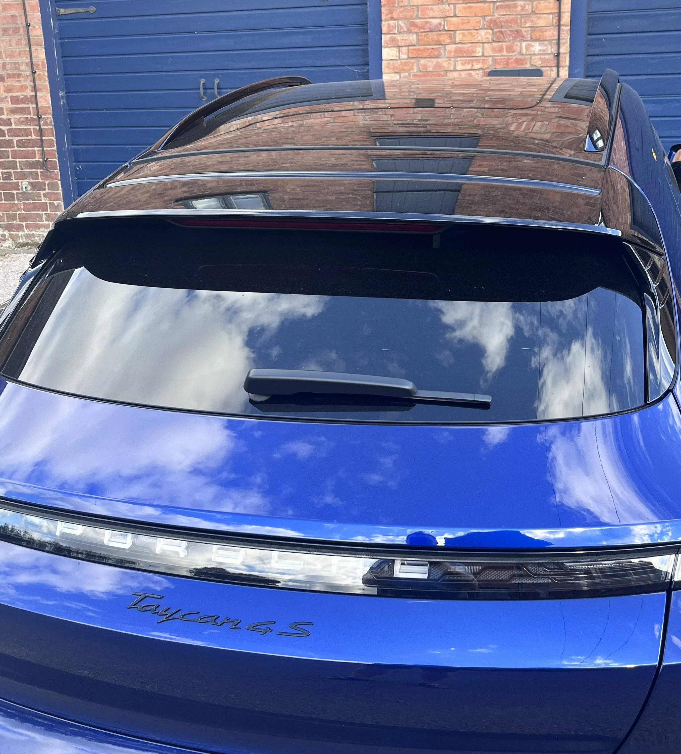

Lasted 9 days (Panoramic roof)
Larkey
Steve
Apr 18, 2022
U.K.
Porsche Taycan 4S Cross Turismo
Well, still away on business but had a message saying that mine hasn’t been done as the bodyshop didn’t have the right specialist tools yet and there aren’t any at any UK sites….
At least the 22kW and instrument cluster campaigns have been done whilst away.
Tell then there’s one at Porsche Centre Solihull!
baboum68
Jan 5, 2022
CT4S
The part just arrived. But I can’t have an appointment until….end of August!!!!! Pfff
Larkey
Steve
Apr 18, 2022
U.K.
Finally got mine back after 6 weeks! All seems fine but paranoid I’m going to see another cracked roof every time I go out in it!

MY NEW REPLACEMENT ROOF HAS CRACKED
had it back for 1 week and two cracks appeared in new roof. Gutted. They clearly didn’t have a root cause when they did the fix. At a loss about what to do and wishing I’d gone metal roof!! May ask for new car.

They have now said they have not found the underlying issue yet but have a team in Stuttgart working on it. Apparently in U.K. there have been 30 CT roofs go and I’m one of 3 who’s managed to go through two of them!!
I’m going to keep the car this time as not losing it for 6 weeks again. For those with the problem who’ve carried on driving, have you had any issues and have the cracks got worse over time or stayed the same?
Mine never got any worse , well apart from the Cayenne Tank courtesy car till my (first ?) replacement roof is done. Sure its all very good if you are into that kind of bus height ride but definitely can’t wait for Friday to get the CT back. If it cracks again, will be keeping it just as before till the next replacement roof…
