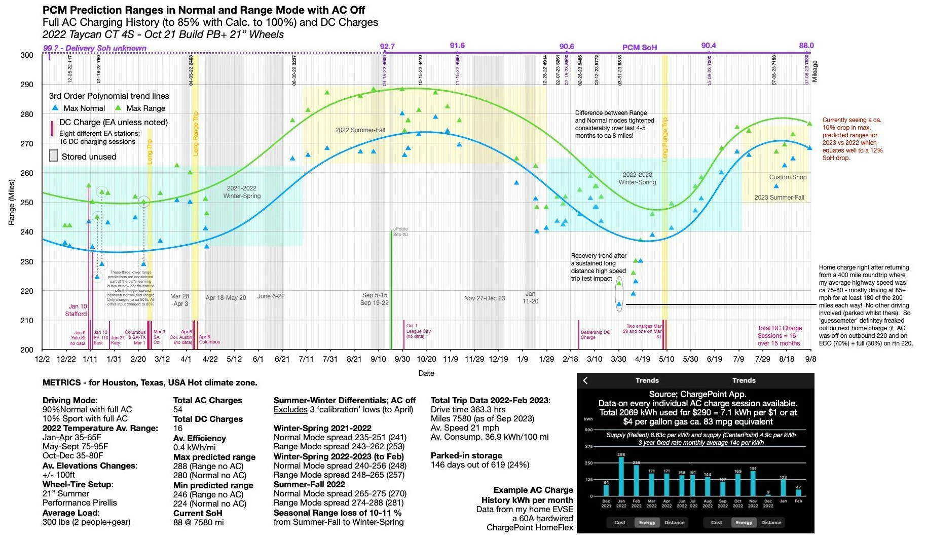

Any number of things - if still in it's first 6 months then ranges improve, if comparing seasonal changes they differ, if driving lots of short inefficient in-city trips followed by one or more efficient long trips your guessometer will come up with all sorts of changes :)
Here is the GoM values for my car after every charge over nearly 2 years - the most interesting perhaps the seasonal variability but also the impact of declining SoH!

Whoa, that is some truly amazing data to have, thanks for sharing it. My 4S is sitting at about 90% SoH too, but I picked the car up in mid April 2021. Interestingly, I am not seeing a big difference in the estimated range. I don't check range mode, but in Normal mode during the summer time, I am still seeing it report essentially 250 miles on 100%. The one odd thing I've seen is that when I charge at home, the car always stops at 99% now - before if I left it on overnight it would always be 100% in the morning.

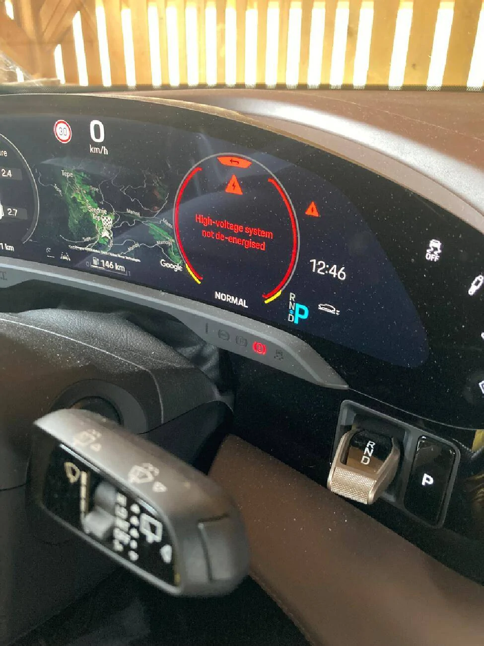

Peter, I couldn’t connect device with their app.
I can see it as a bluetooth on my iphone, but connect (step 7) doesn’t work.
Maybe it’s because i don’t have internet access?
Also, see enclosed error message on my dashboard.
Any hints, since their support doesn’t work during weekend.

Sorry I can not help now because I am not with my car. I have not seen that message and it looks like you are connected to the car, but not the app?
I will try to see once I am back, but that will be towards the end of next week. Sorry!
You can use OBDLink MX hardware. For Taycan use it with CarScanner app. https://www.carscanner.info/
No problem, i hope i’ll solve problems with their support.

I thought that mx+ comes with their own app, so i’ll wait for an answer of support.
It does come with its own app. Its own app does not work for Taycans, and many other EVs. Trust me. I have one. It works with carscanner app.
Just a check but it looks like you are using the OBDLink app to connect?
Are you using an OBDLink reader or the MX+ reader which is not compatible with the OBDLink app I.e. you need to use the CarScanner app to link to the car - for ref I actually have both - the top end OBDLink tool and the MX+ and for the former the company rep actually recommends using CarScanner and not their OBDLink app as not all functions supported with EVs for the latter!
The other piece is to indeed check that the correct protocols we selected for whichever reader you are using.

Understood… i didn’t know that.
Thank you all…
i moved to @Tooney suggestion… few minutes later, it worked. :clap:
Ah - the web site has been acting weird for me as @Tooney 's post had not appeared/refreshed when I responded - apologies, I basically repeated :)!
