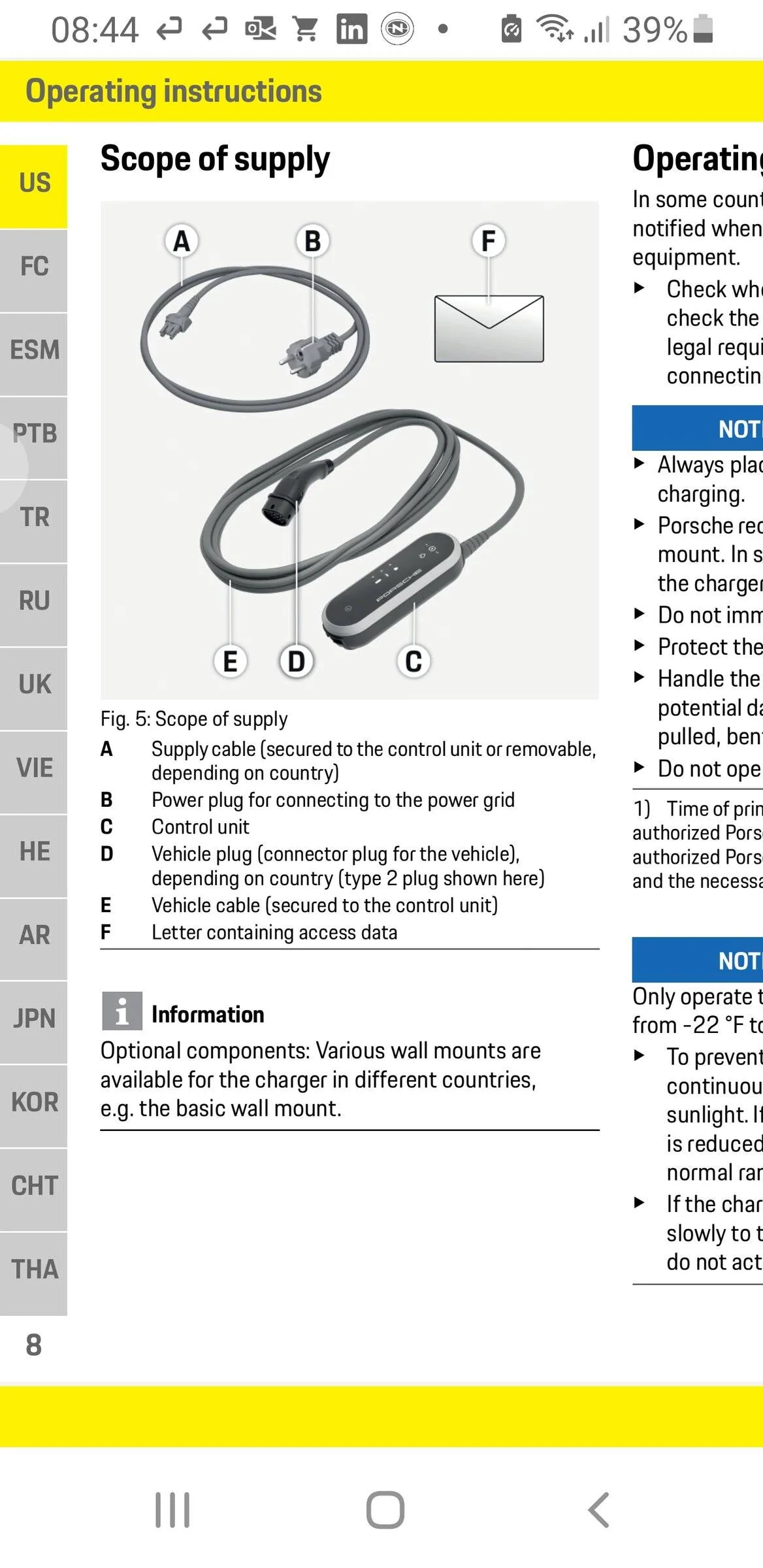

The car comes with this as standard :
E-Performance
• Supply Cable for Red Industrial Electrical Outlet (400V, 32A, 5 Pin) • Charge Port on Driver and Front Passenger Side
• On-Board AC-Charger with 22 kW
• On-Board DC-Charger with 150 kW
• Charging with Direct Current (DC) at public Charging Stations with a Voltage of 800 V • Mobile Charger Plus with 11 kW
• Supply Cable for Domestic Electrical Socket
• Charging Cable (Mode 3)
8,818
5,278
GTS ST, Macan T
Yes but lacks details of the PMC+ - mentioned only.
According to the manual the basic wall mount is extra.
