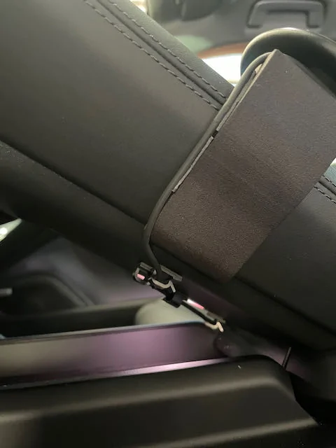

There is a crack along the side of the console (between the leather and the plastic) that it can be wedged into. I ran it to thru the tray area to the passenger side, down along that space, and into the console compartment. I installed a cigarette USB charger instead of using the built-in USB ports as I don’t think they have enough power for the MagSafe.
Do you have some holder under the phone holder (looks metallic). I did not realize the USB-C could not run the magsafe. I do not use the cigarette lighter so that will work.

Not sure what metallic parts you are seeing. I have some small plastic clips (double stick taped) holding the cable under the console (Lowes). As for USB-C charging, that all depends. If you read up on the MagSafe it requires a high-powered charger. I believe it's 18W. I don't know what Porsche put behind their USB ports, but it's probably not high-powered. I bought "UGREEN 20W USB C Car Charger" from Amazon. I also bought a right-angle short cable adapter to keep the cable from poking too far into the compartment.
You cannot see the cable in my install. All you see is the short stub coming off the MagSafe charger itself, the rest is hidden.

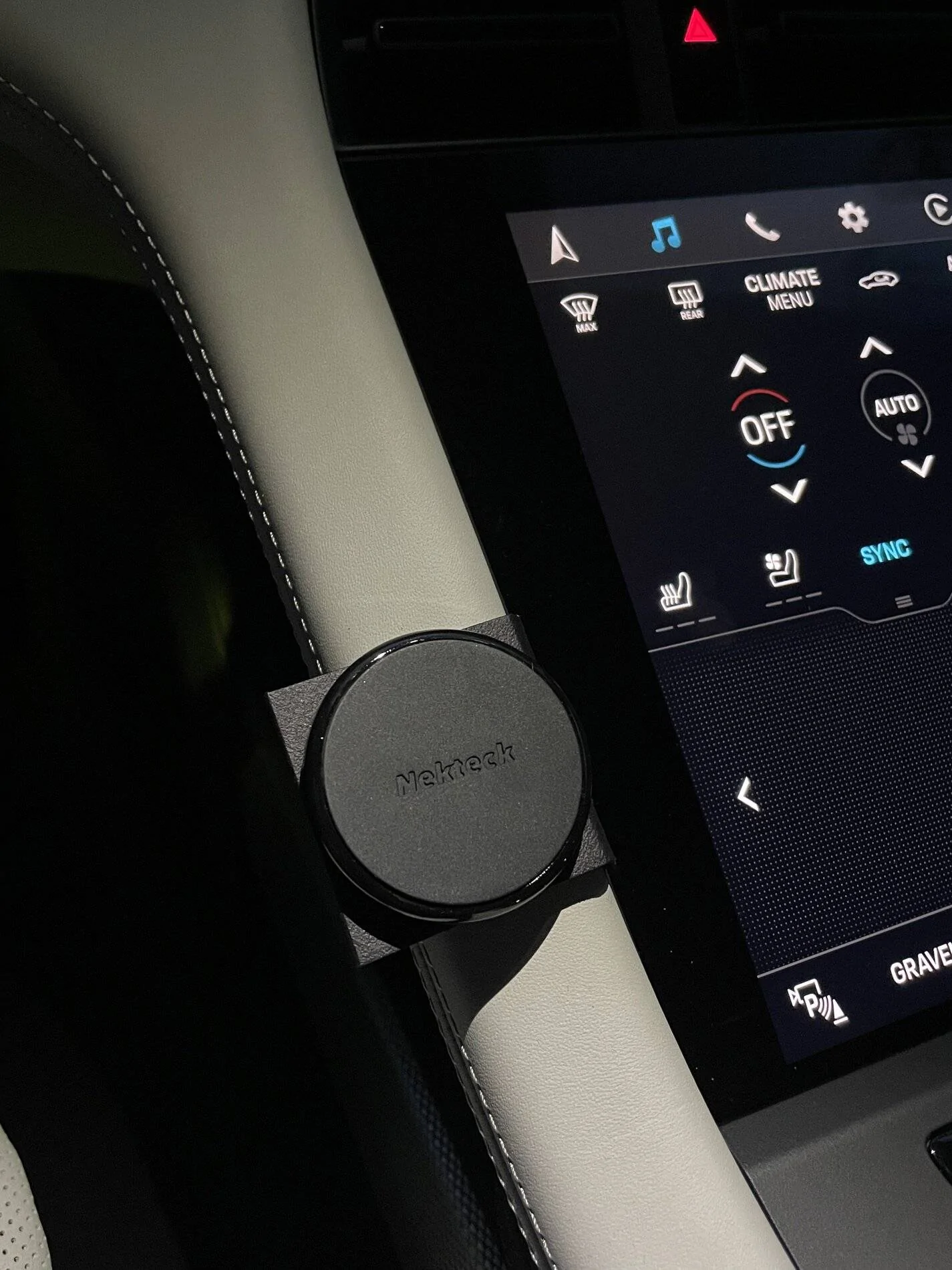

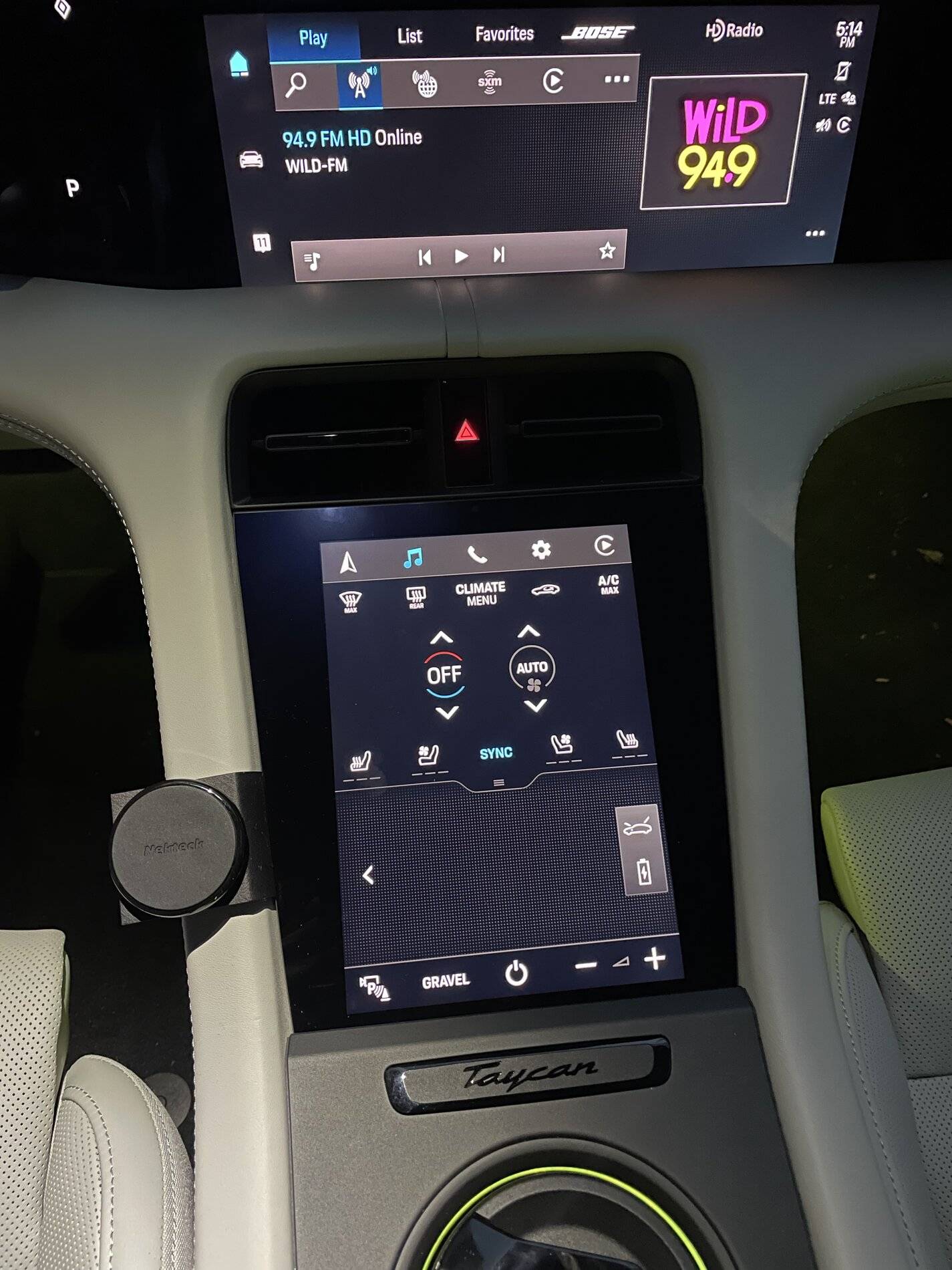

Pleased with how this turned out. Thanks again for the 3D printing file.
Looks great @Greenmachine . Have you thought of printing it with a beige filament to match your leather? Could blend in even more.
Did you connect the MagSafe to power or just using it as a magnet?
This is just a cheap adhesive magnet that I used. I figured I could use the expensive Porsche USB cable when I need power on longer drives so that my wife can also use it for her Android phone.
Color matching to the leather is a great idea but I didn't think of that in time.
