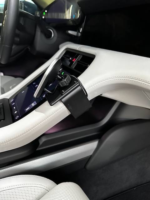

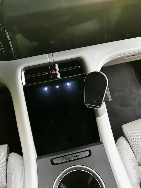

I got the proclip and married it up with an apple MagSafe charger.
https://www.brodit.co.uk/
Proclip - 655613
Magsafe charger/mount - 216322
£67
The only slight confusion was the predrilled holes in the clip didn't marry up correctly with the MagSafe mount in the correct orientation. The screws they supply self tap, so attached it to the clip that way.
I've mounted it on the LHS (ie passenger) of the aircon screen. Looks really neat and i just pushed it into place (and didn't use the supplied adhesive patches) and it feels secure.
Bonus discovery was the charging cable squidges into a gap along the side of the arm rest/centre console, so it's pretty neat and no requirement to break stuff doing any dismantling of cupholders etc.

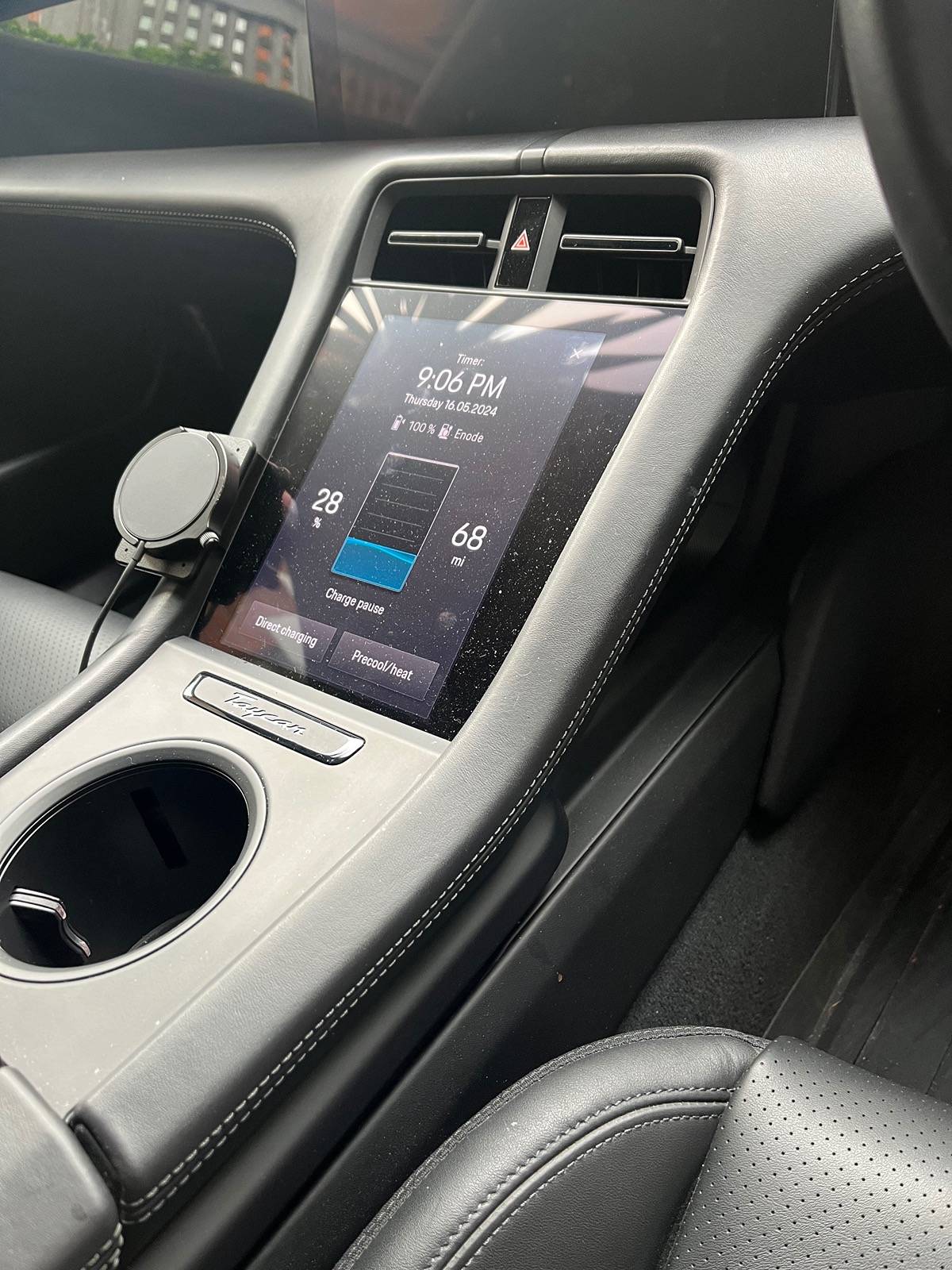

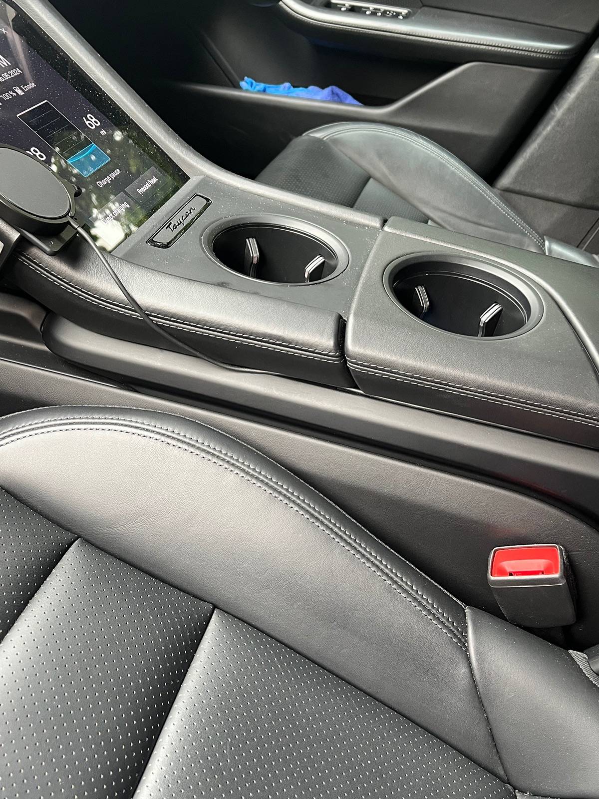

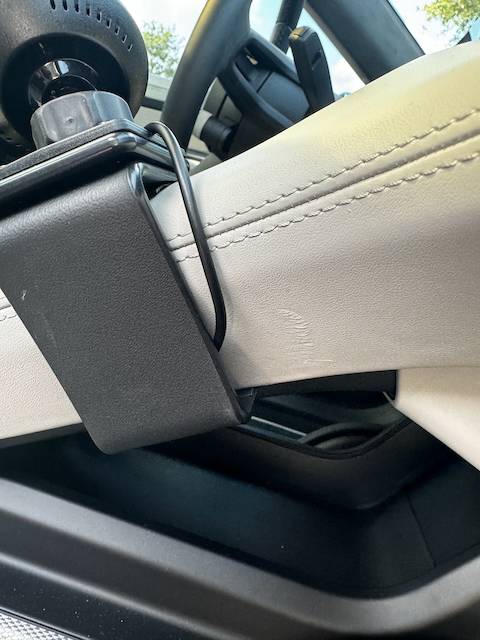

I like the setup that I got from www.proclipusa.com
You choose a mount and then a phone holder specific to your phone and put it all together. I chose the Taycan mount obviously and a Charging magsafe mount, although there are many different options. The wire is run into the armrest console and plugged in to provide power. The wire is just pressure fit within the seams of the panels along the way and there was no disassembly.

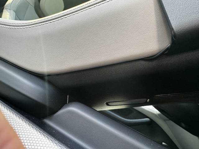

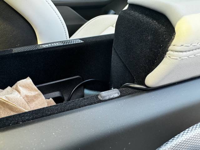

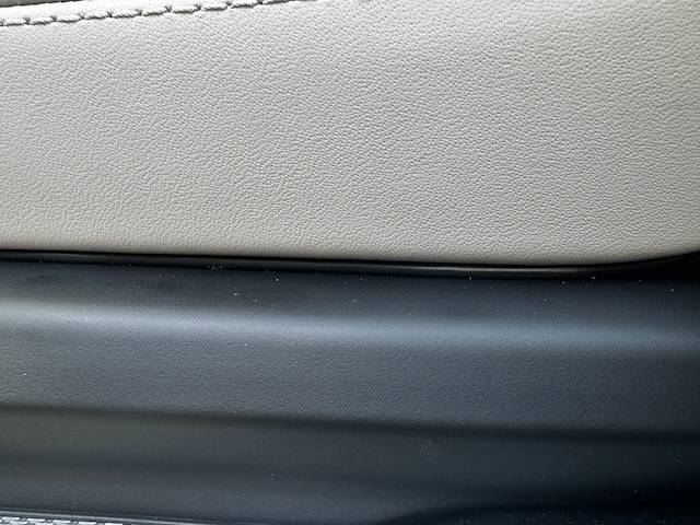

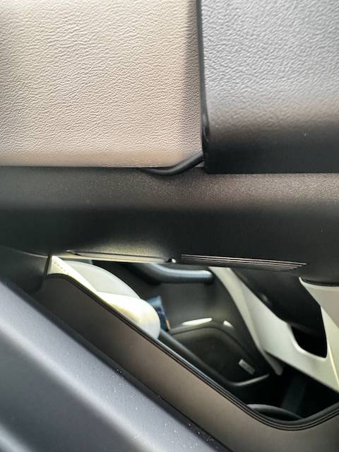

Shawn, the cable is wired purely via pressure fit in between the panels, here are some pictures that illustrate the routing.
Super helpful, thank you! I got part of it to budge to get this done already but seeing your pictures I’ll try to get the rest hidden as well.
