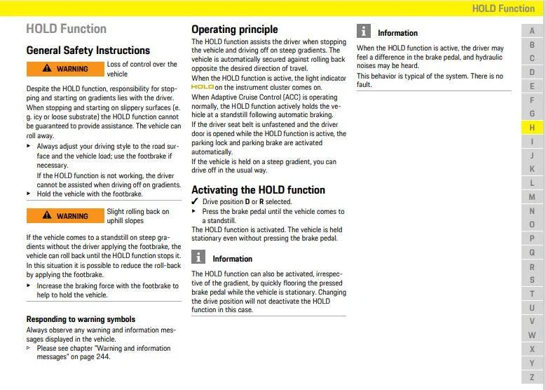

Since I don't have a Taycan yet, I'm curious. How does the hold function work? On my MB the hold function only engages if the car is on a slope or descent of at least 5% and the hold function only is active for 5 seconds. Basically meaning it is supposed you having your foot on the brake the entire time and it will hold the car while you transition from breaking to moving forward.
How does the taycan work? Thank you
Well there is "hill hold" which works as you describe, then the ACC/ALK stop-start behavior where it will occasionally read "hold" then continue.
Oh. So it isn't supposed to hold indefinitely at all. Meaning that in the op's case he must have those systems active and the sensor suddently "thought" it had clear view ahead to move?
That is my best guess at what happened. In my experience (30K miles across two Taycans so far) I've never had the car automatically drive as he describes.

Several times (4 I believe) the car was in hold mode at a stop light and suddenly exited hold mode and started moving forward. One time I almost collided with the car in front of me because of this. I slammed on the brake just in time. At first I thought I might be imagining it because its frankly unimaginable. But it happened while one time when I was on the side of the road with my feet nowhere near the pedals. Fortunately it hasn't happened since the major update and I hope it won't happen again.
I don’t use ACC, but if I long press on a break pedal, a HOLD displays on the screen….and the car doesn’t move until i press on a pedal to move on. And HOLD might stay for several minutes, up to five (i know since i have an underconstruction road near me, with road closure of 5 minutes).
Both my previous MB and the Taycan will engage hold if once you are at full stop you press on the brake further down. Then you can remove your foot from the brake until you press the accelerator

The one thing I will add, because it's a safety issue:
The fact your feet were not anywhere near the pedals is the problem. If you don't want the car to move, your foot should be on the brake or the car should be in park.
ACC+ALK, if active, is going to attempt to stop/start with traffic. Any chance this was on when this event occurred?
Not familiar with ACC + ALK. The car didn't exit hold mode due to other cars moving. One time I was on the side of the road and the car in front was parked with nobody inside.
