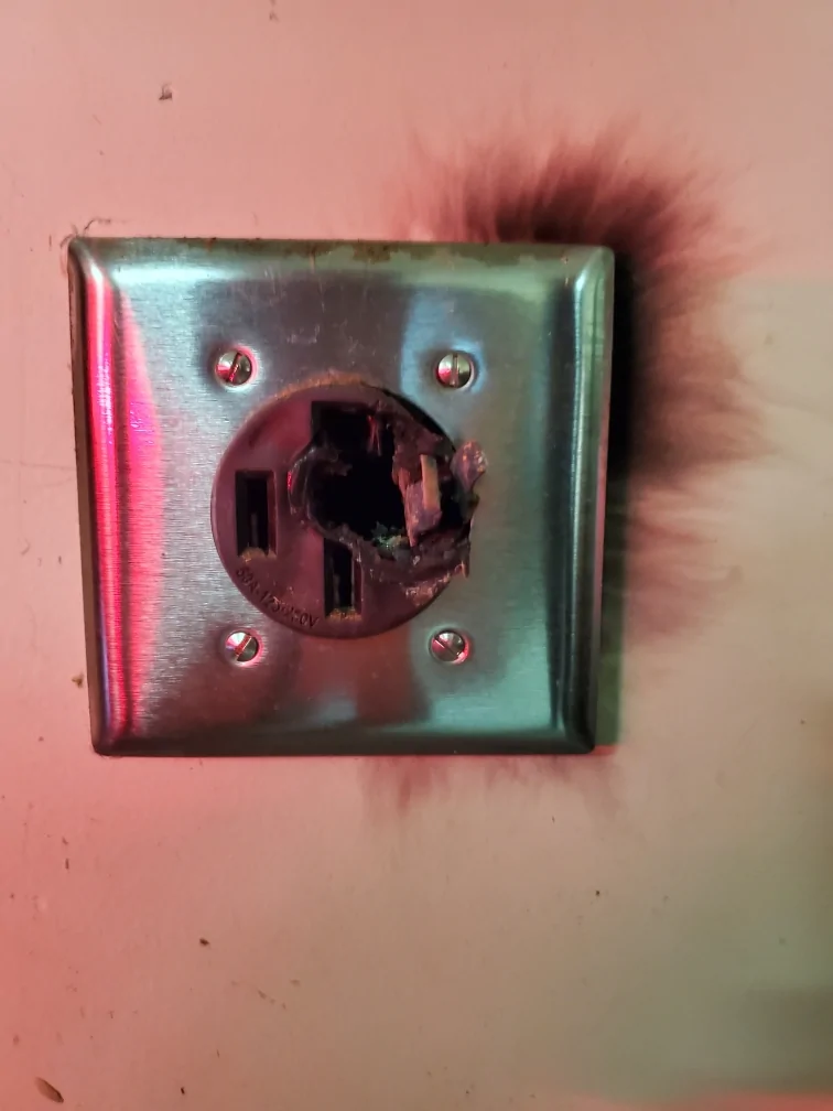

this has happened with a Porsche Charger - so yeah - it's a thing - and can happen with both PMC+ (no LCD screen) and the PMCC (LCD screen and Wifi and ability to have software updates).
https://www.taycanforum.com/forum/t...pmcc-via-ota-update.12791/page-22#post-191983
To be fair, the above melting of the receptacle is most likely to be caused by the poor quality, faulty or worn out receptacle (some are rated for 100 plug cycles or less, since meant for washer/dryer/oven scenarios where you don't unplug them daily), or even bad wiring. The only way an EVSE causes this type of melt is if the NEMA 14-50 plug had actually overheated to much that the prongs have melted the receptacle.. I have seen pictures of melted receptacles with Tesla chargers too, all usually stemmed from cheap receptacles or bad/loose wiring, except for very a early faulty NEMA 14-15 plug adapters that Tesla recalled/replaced long ago which did melt (everyone who got one was sent a new plug adapter for free, with a pre-paid shipping box to ship the old one back).
As side note, Tesla also added a safeguard against bad receptacles or wiring in the software which drops the charging current for the location (until overridden by user) if they see too much resistance in the path (they ramp up the current slowly, and if the voltage seen by the car drops too much, they limit the charging current). I have not seen any melted receptacles reported on forums since then. Do the Taycans do that? This check is best done on the car charger (rather then EVSE), since it essentially protects the entire path between the distribution panel all the way to the car - any source of resistance in that path (which would turn into a source of heat) would be detected. It does have some false positives though, when an unrelated voltage drop happens during the ramp.
EDIT: All of the above said, given what we know so far, I agree that using the PMC+ or PMCC just doesn't make sense. Even if it is not a safety risk anymore, at the very least it is now slow and sounds unreliable, which is not what you want from an EVSE. I have a MY23 Taycan coming with PMC+ (I presume) which I have no plans of using, ever - I'm curious if it will come permanently locked to 20A. I picked up a used PMCC from anther member here on which I plan to do some reverse engineering to satisfy my own curiosity, but would also not use it to charge any of my EV's unattended.
