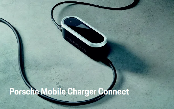

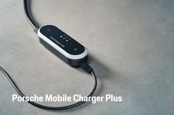

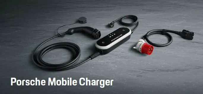

EVSE = PMC, PMC+, PMCC
For my knowledge, could you confirm these three - are they essentially different versions (charging outputs) of the same thing?
11,016
6,805
PMC = Porsche Mobile Charger (legacy unit)
PMC+ = Porsche Mobile Charger Plus (standard on Taycans globally since launch 2020)
PMCC = Porsche Mobile Charger Connect (optional cost, higher capacity)
PWCC = Porsche Wall Charger Connect (effectively a PMCC in a Porsche Dock)
Depending on country the PMC provided 3.6kW or 9.6kW, PMC+ 9.6kW, PMCC 22kW (or 9.6kW or 19.6kW), PWCC (not sure but minimum 9.6kW and up to 19.6kW).
UK market - PMC or PMC+ or PMCC
PMC and PMC+ look similar and are thinner than the PMCC.
PMC+ - PLC (power line connection for ethernet / networking)
PMCC has a touch panel and display, PLC, WiFi, Hot Spot etc
Overall dimensions are the same except that the PMCC is deeper.
