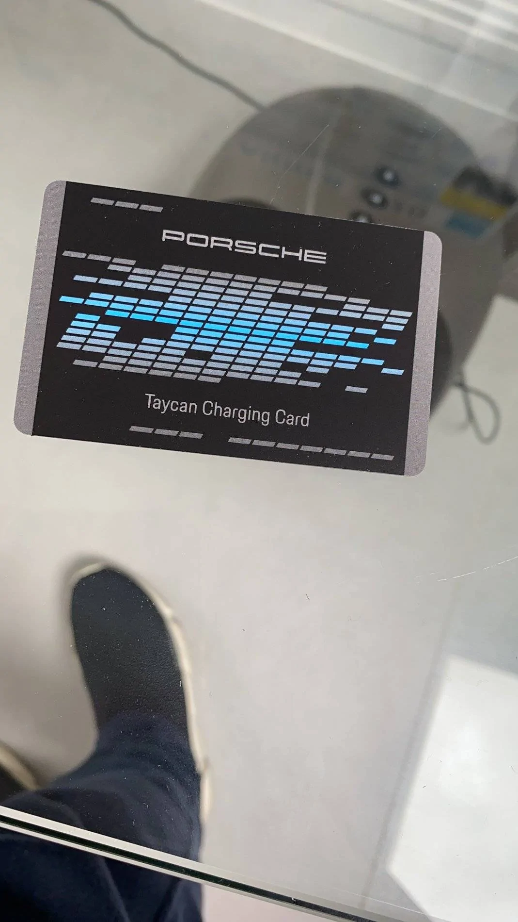

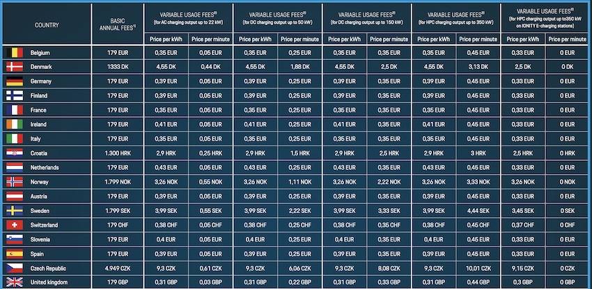

As one of the first owners of a UK car I found this out after ownership as even the dealer did not know!
Within the Porsche connect store you need to sign up to the “Porsche Charging Service”. This gives us discounted charging rates for all UK suppliers. Ionity for eg is only 3p per KW compared to the usual tariff of 69p per Kw. The full tariff chart is on the connect store I will see if i can find it a bit later.
You will be sent an RFID card in the post which you need to add your card details to. Touch a charger and begin charging and you get charged to this card.
Hope this helps :cool:
The discounted rate is 31p/kwh for Ionity....now go and try and find some Ionity chargers (there are 6 live in the whole of the UK!)

I agree this is the best way to arrange some charging, but Ionity is not so common in the UK as yet. You can also start the charging and log in with your Porsche Connect app. You just scan the code on the charger and voila!
Porsche Taycan Public Charging, do I need to sign up with different providers? 77404C40-9B3E-444B-A108-41C55D576110
Secondly you can, at least here in EU, have the same card or Porsche app utilise a lot of other charging networks. They do not cover all of them but have quite a good agreement with many of them. And they are also at ”favourable” rates? Not sure how they compare with direct subscription rates though. Something to check and compare.

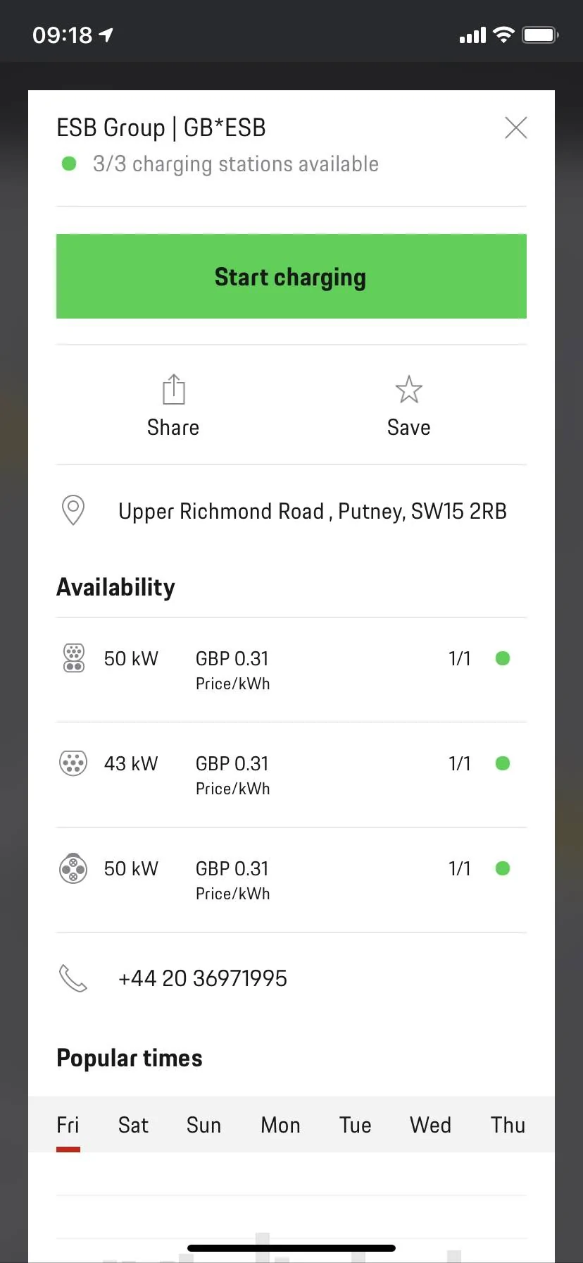

The Porsche discount is only applicable to Ionity as far as I can tell, very happy to be proved wrong.
The Connect app does seem to be able to be used for other networks - for example near me some ESB and also Newmotion chargers show up.
As for pricing, the ESB charger shows in the connect app at 31p/kwh:

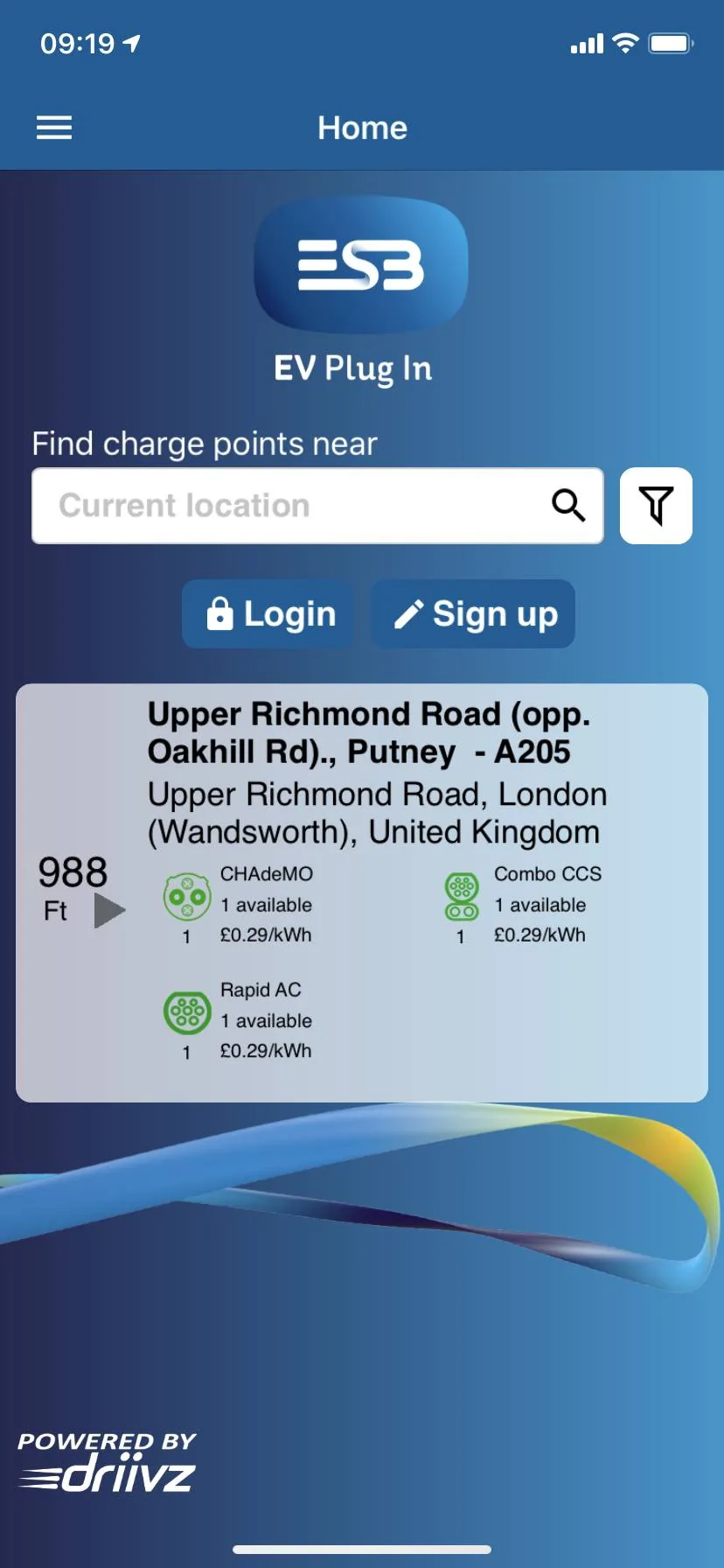

Porsche Taycan Public Charging, do I need to sign up with different providers? IMG_AF667C0F0355-1
But via the ESB app it's cheaper at 29p!
