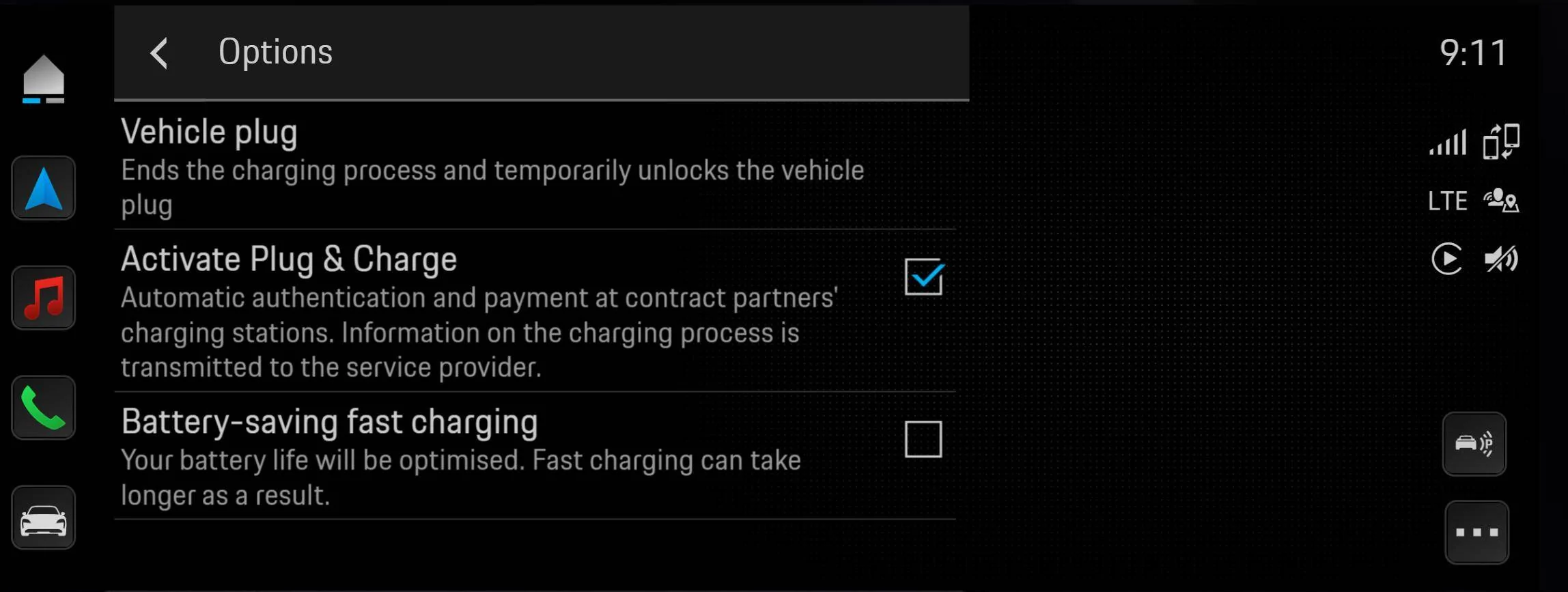

Thanks. Mine is MY22 as well. Do I just have to tick the plug and charge box in the PCM in car or is there some other layer of approval on the website i need to do? Ta.
Under Charge ... Options

Thanks. Have that ticked. Going to an Ionity tomorrow, so will see!
Yes, just tick plug and charge.

Box was no longer ticked :facepalm:, which i'm blaming the big update for. Will see what happens tomorrow!
