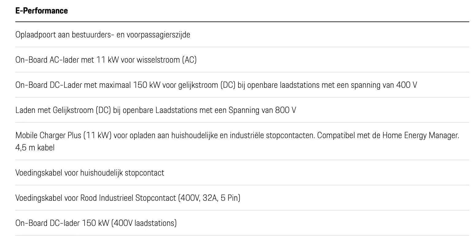

It is not a charger it is a DC to DC voltage booster with purpose of boosting 400V DC EVSEs up to 800V to match the voltage of the HV battery.
The only chargers onboard are the AC and DC (50 kW 400v + 350 kW 800v). Without the booster you would only get 50 kW from a 150 kW 400V DC EVSE.
Thank you for promptly pointing this out.
The DC to DC voltage booster is standard in Portugal and I think the same happens across Europe so, I believe, this is the reason OP isn't seeing it as an option in his build.

The OP is based in Europe I believe. The 150kw onboard charger is included in the base model so it doesn't appear as an option (OP can confirm on the standard specs page of his model).
Indeed - hence my confusion.

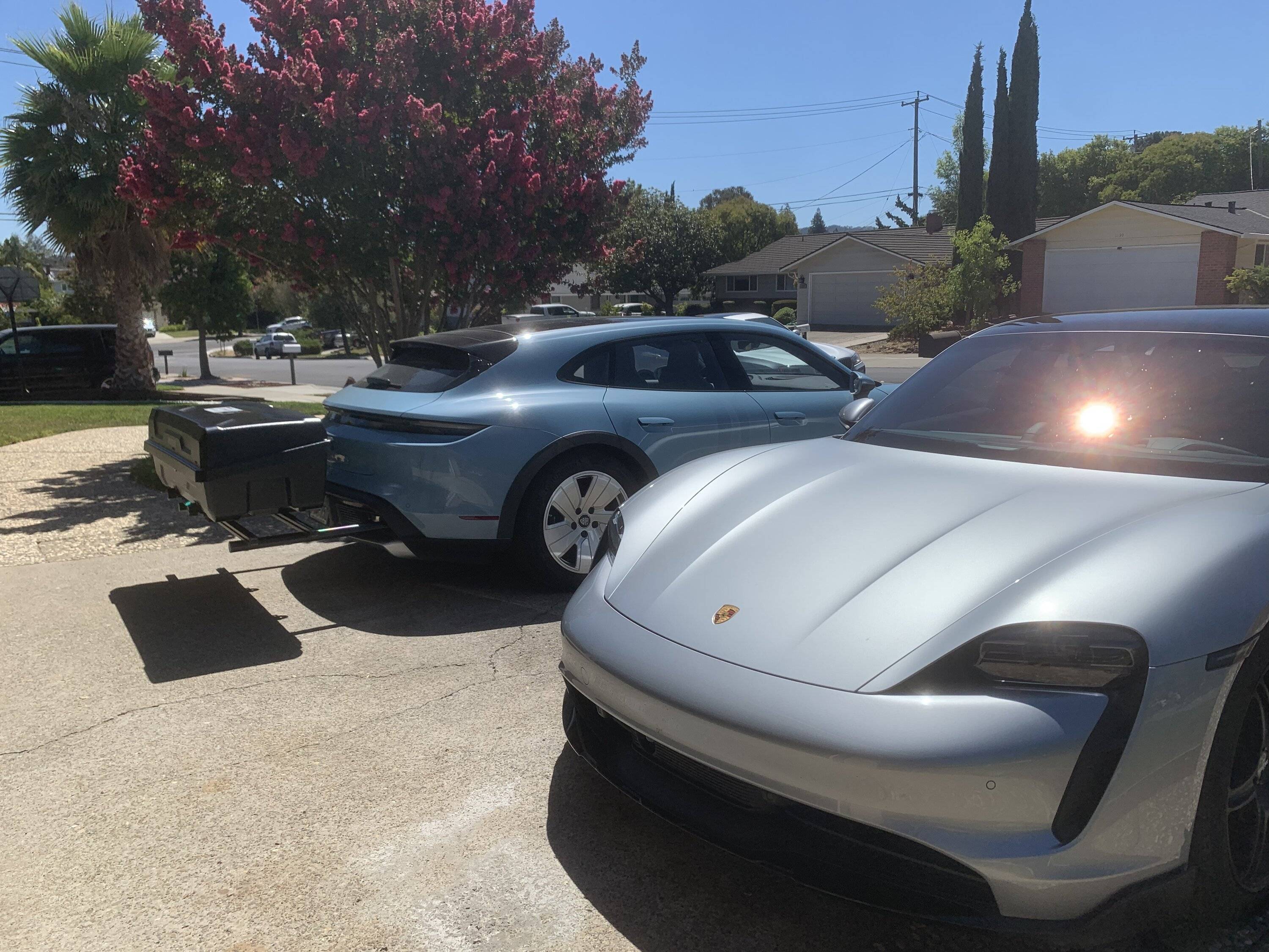

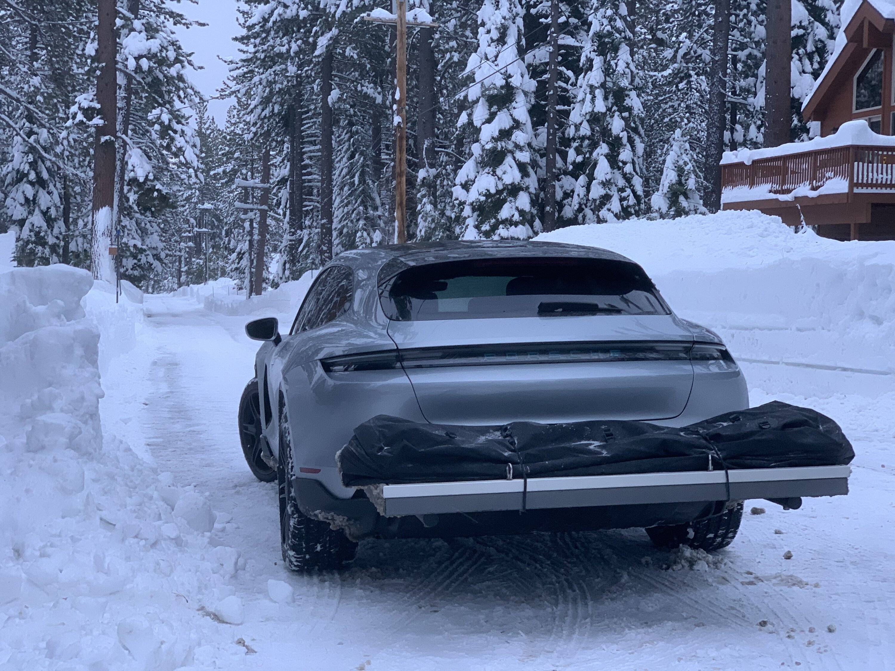

OP, keep in mind that the rear rack prep is only available on CT and ST(Europe only) in case you were thinking of using the bike rack/ box. I use a flexible bag to store our skis on a rear tray and it’s really convenient for 4 of us to hit the slopes. The Taycan is an amazing car in the snow too.
Porsche Taycan new customer questions A578120A-CCA8-404C-A619-638C259BE5D1

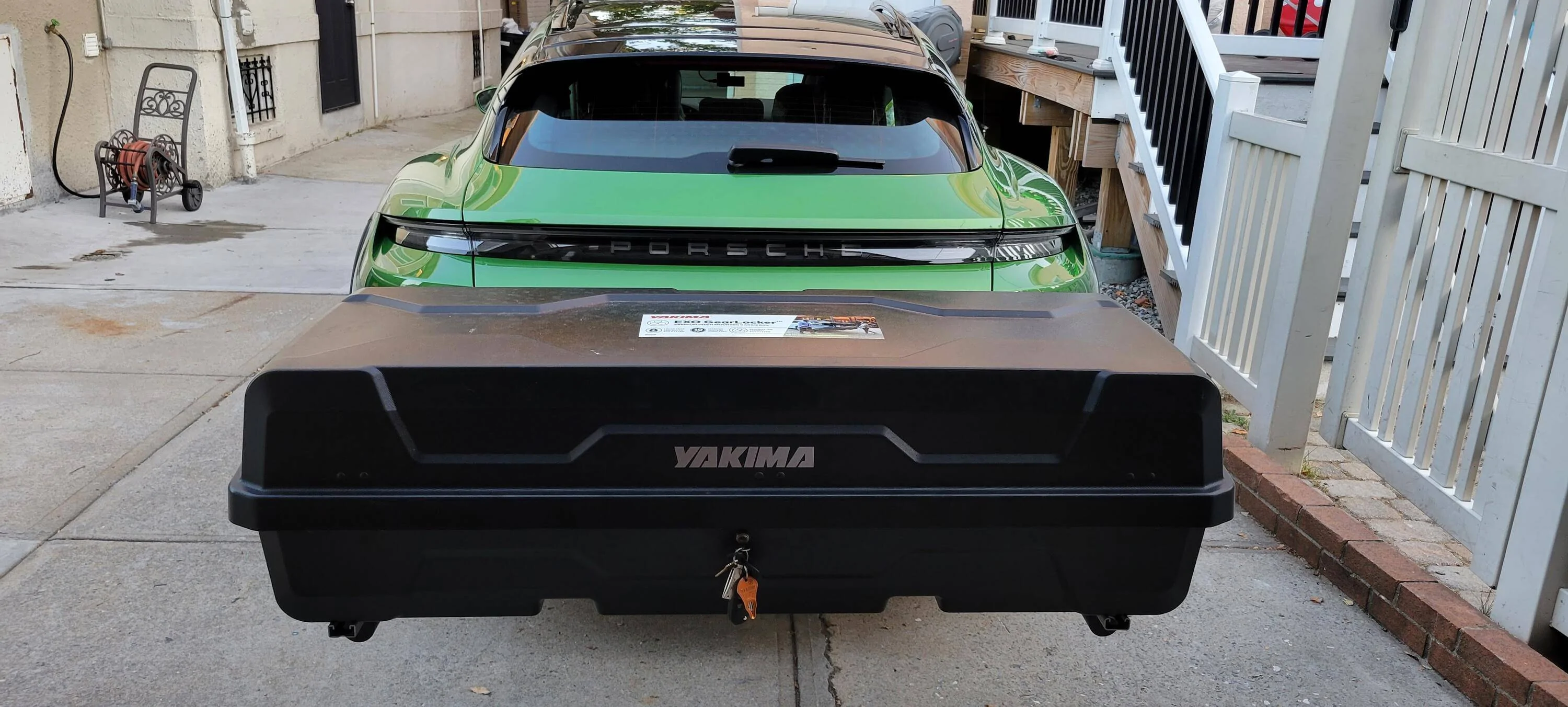

Here are some examples of boxes on the same setup that uses the bike prep. Unfortunately no hard boxes long enough to fit 180cm skis.
Porsche Taycan new customer questions BCD0C217-E301-43D2-B458-32F28CFAA7BE
Porsche Taycan new customer questions 56294CE8-BEAB-4EAF-B9AD-A9B1D13E4BB3
