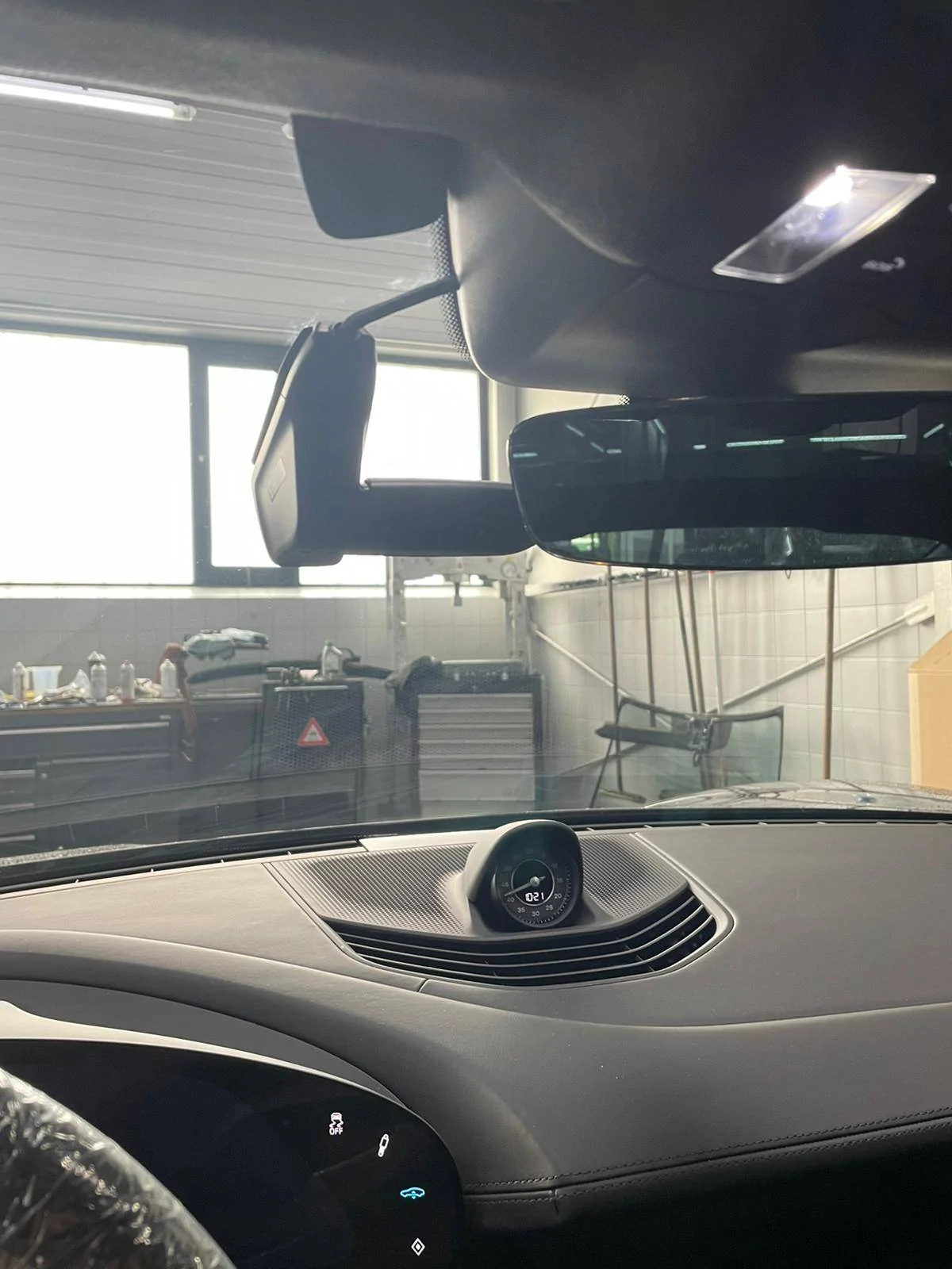

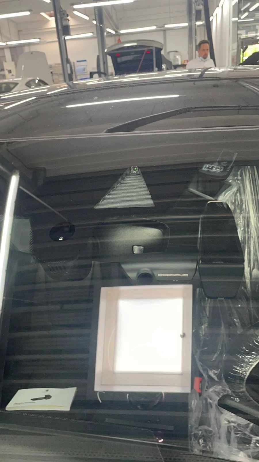

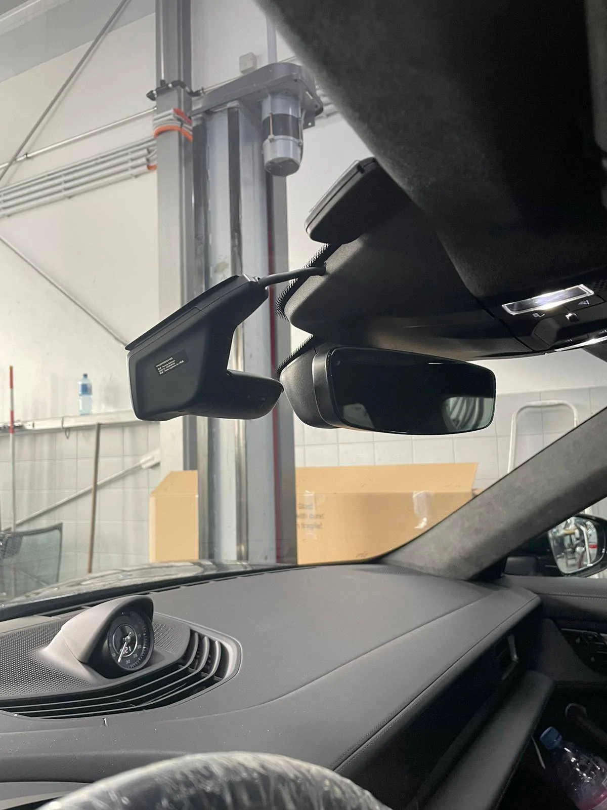

Got mine mounted today. This is how Porsche instruction says it should be mounted ????
Car went straight back. Tomorrow it will be mounted on the passenger side.

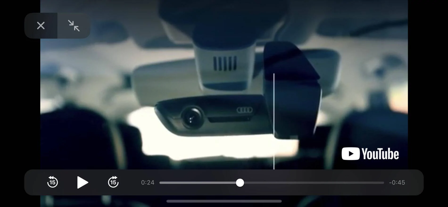

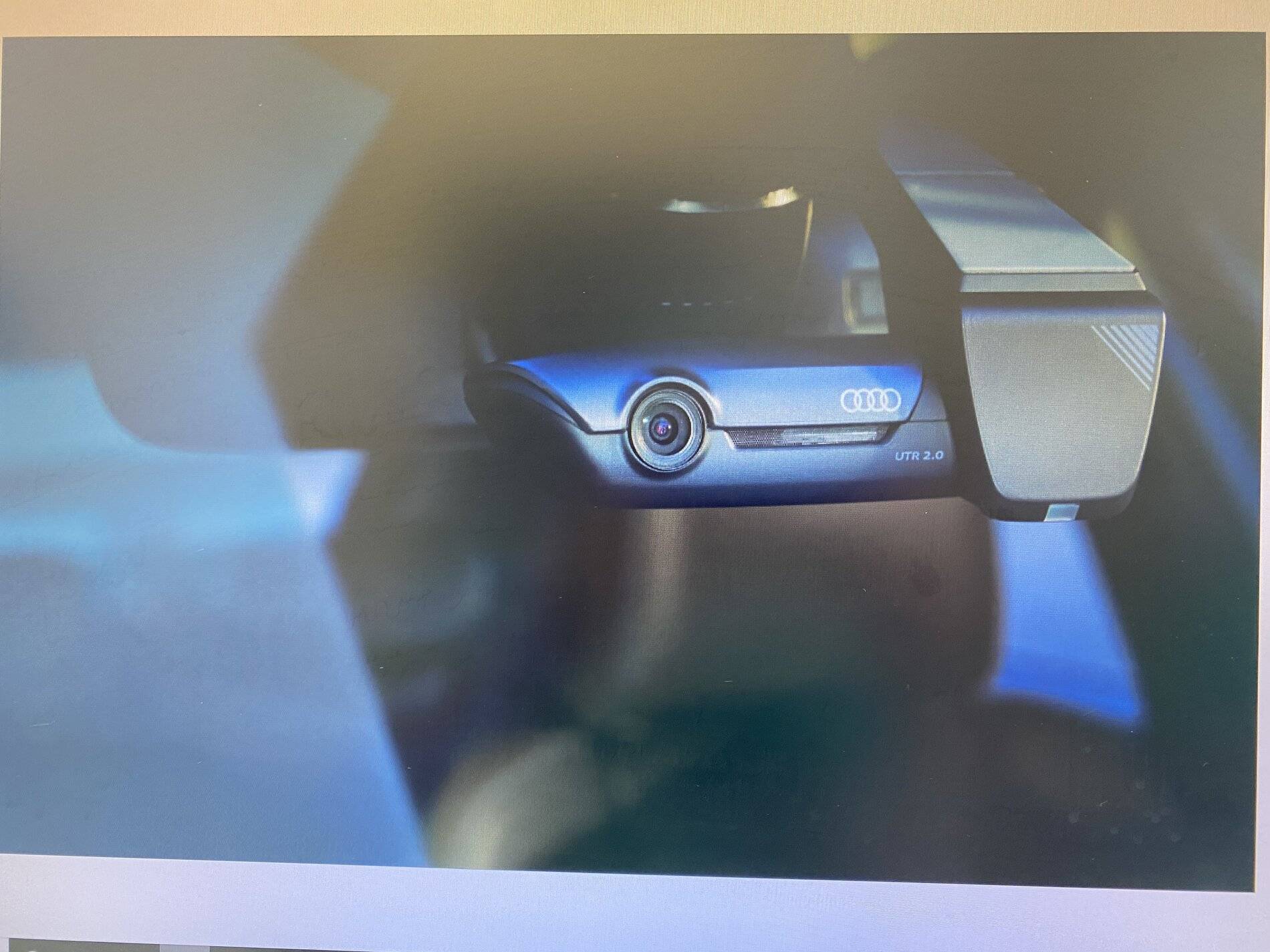

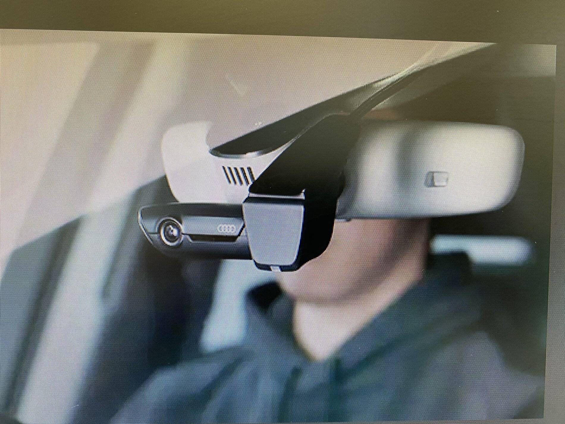

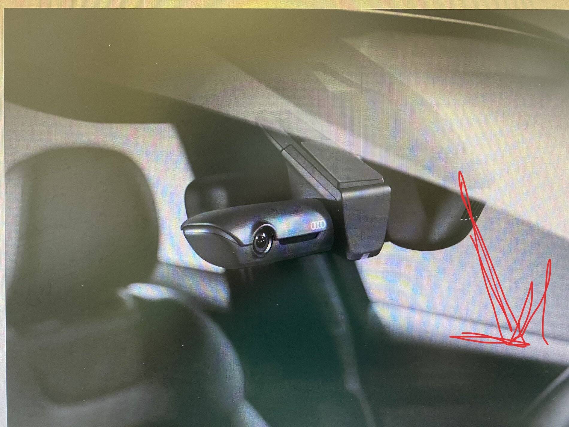

Even for right-hand drive cars (like my Irish variant) where this is the passenger side - that is unacceptable. Who'd want that stuck that prominently and low down?
I have seen the installation instructions for the Audi version of this camera – and they too have it installed in this position and this low. Nuts.

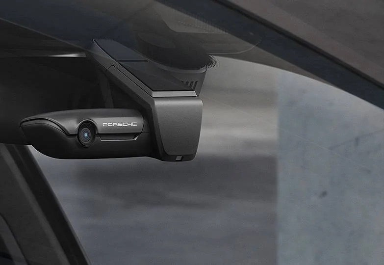

Especially when they advertise it like this.
Porsche Taycan New Porsche Dashcam Available 34ce05e7-336c-4aa2-9252-36edbfdf5f30-jpe
Was this installation done by a Porsche shop?? That is the worst installation I have ever seen.

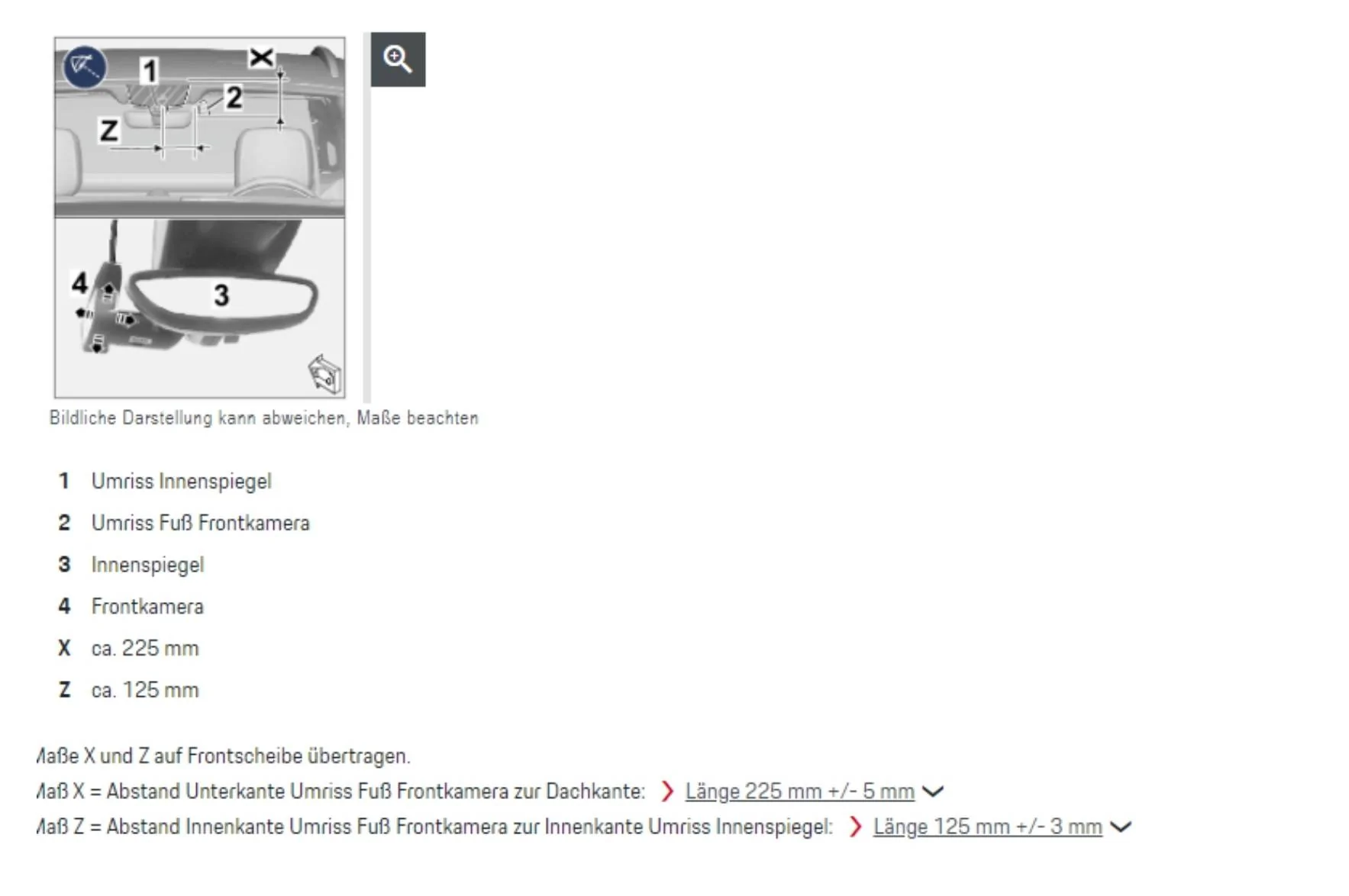

This is the original installation info. I too thought they installed on the wrong side...
Also cannot connect as I dont know the wifi password. Anyone knows the wifi password?
I agree, esp because that's how the inx show how to mount it...? so I'm out... No need to watch this thread any more... I love having stuff with the Porsche name, but there are LOTS of good dashcam on the market...at less of a financial (and aesthetic) cost.
It is in the manual. If I remember right 1234567890
