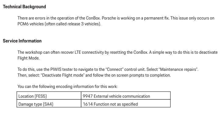

From the below linked TSBs:
OTA-FC = over the air function control
ORU-Reset = online remote update reset
Flight mode: "control unit is registered in the backend after flight mode is deactivated."
"Flight mode deactivation starts the eSim registration and pairing process."
https://static.nhtsa.gov/odi/tsbs/2021/MC-10204102-0001.pdf
https://static.nhtsa.gov/odi/tsbs/2020/MC-10174597-0001.pdf
Also see architecture description by @tigerbalm in this post: https://www.taycanforum.com/forum/t...es-pcm-app-porsche-tracking.9899/#post-142052
See Registration and Pairing process described in attached TSB, page 2.
( https://static.nhtsa.gov/odi/tsbs/2023/MC-10242124-0001.pdf ) Mentions Connect Control Unit also known the ConBox High or Emergency Call Control Unit.
Per @whitex ConBox High has battery in it: https://www.taycanforum.com/forum/threads/fuse-8-us-taycan.12744/#post-189480 :
Side note, conBox-High has an internal backup battery so few minutes without 12V will not necessarily power cycle everything.
Looks like they reset devices and software in your car and got the car reconnected to Porsche backend application.
Questions are:
--what caused your car to lose LTE in the first place and require this be done at dealer?
--when a Taycan loses LTE, how can you tell if loss of LTE will restore itself (ie. "system-wide telematics outage"), or needs trip to dealer to diagnose and reset?
