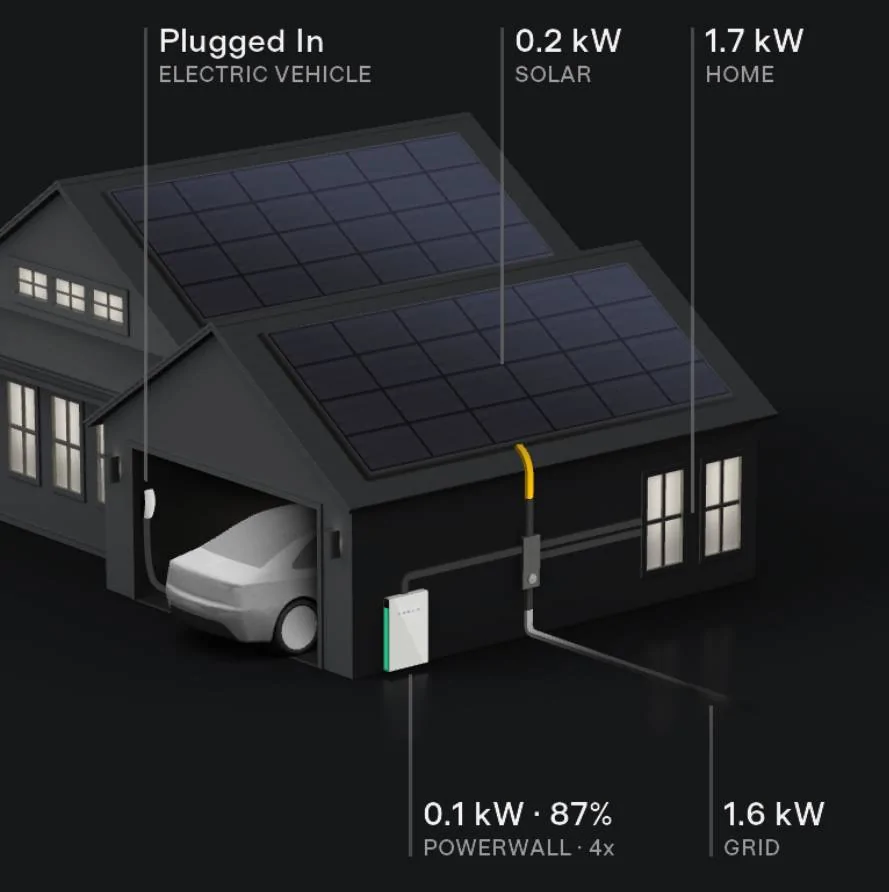

charger now "shown" in the Tesla app - see "plugged in" in the upper left of the screen shot below…

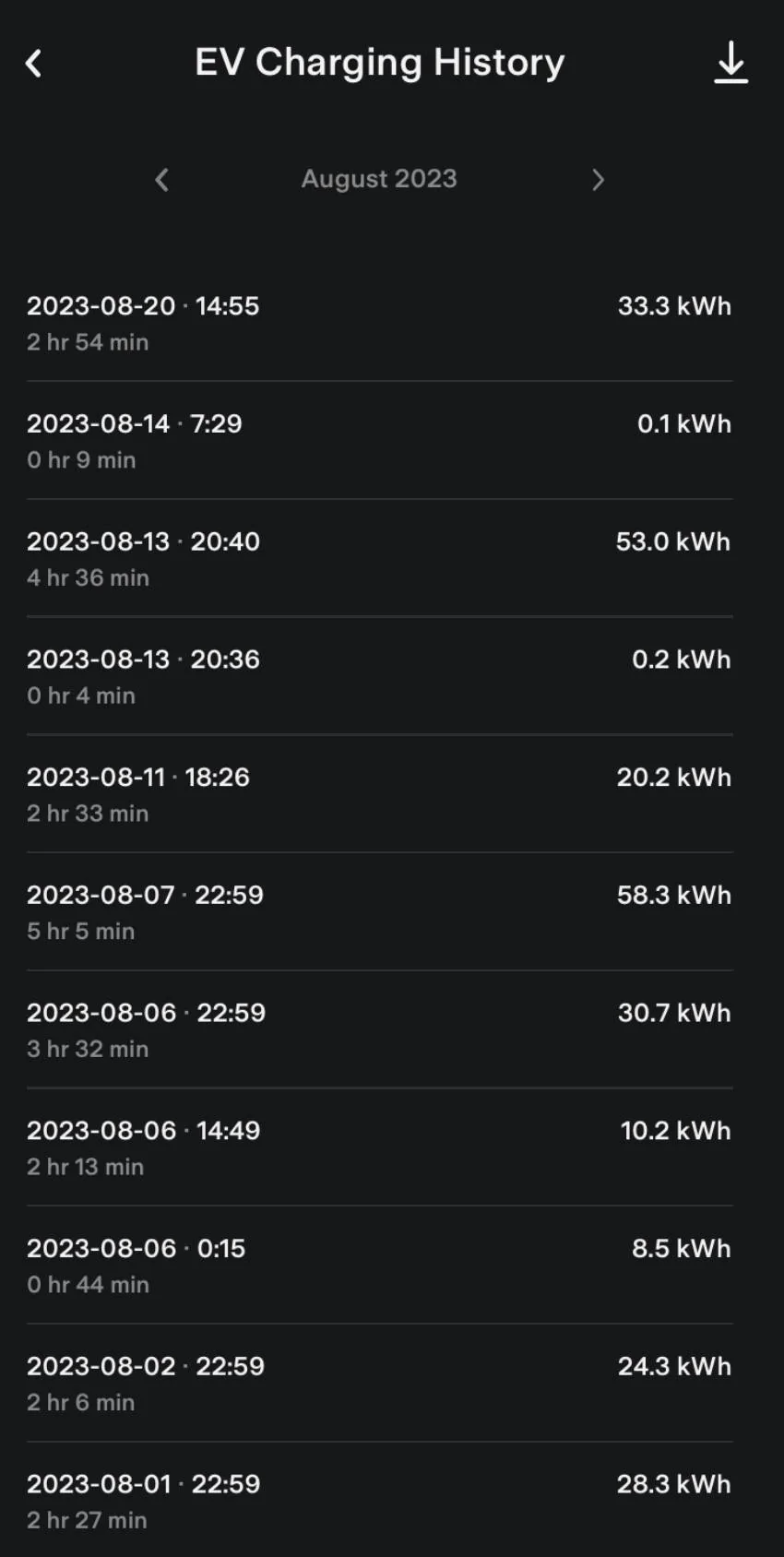

Porsche Taycan [North America] - Get your Tech from a Tech company… Tesla J-1772/Universal charger review IMG_1866
access EV charging history

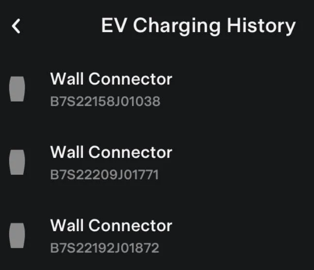

Porsche Taycan [North America] - Get your Tech from a Tech company… Tesla J-1772/Universal charger review IMG_1867
see the list of EV chargers associated with your account
Porsche Taycan [North America] - Get your Tech from a Tech company… Tesla J-1772/Universal charger review IMG_1868
access EV charging history metrics - and down load the data for offline analysis.
