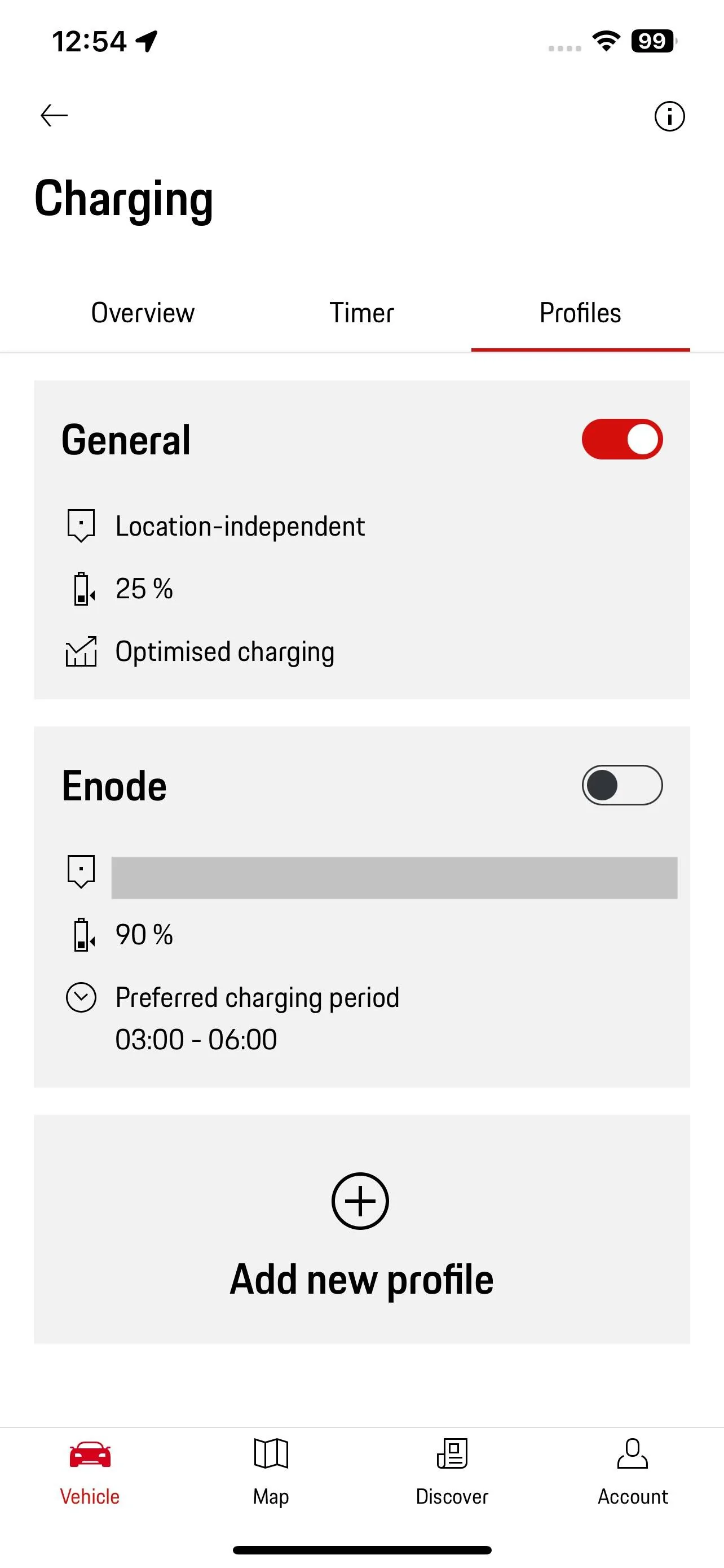

This is the “Enode” profile that was created for me in the Porsche app when I connected my car to the Octopus app.
Intelligent charging worked great for 3 days, then I lost my LTE connection resulting in much frustration. so I went back to Podpoint charging schedules which are 99.867% (approximately) accurate.
