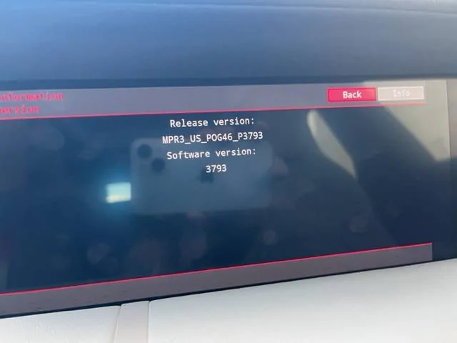

Would someone be kind enough to post a screenshot of the software versions... after this update?
Thanks..
