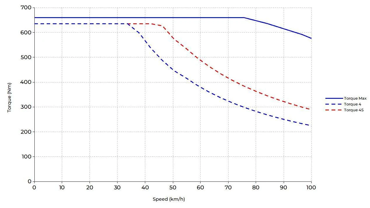

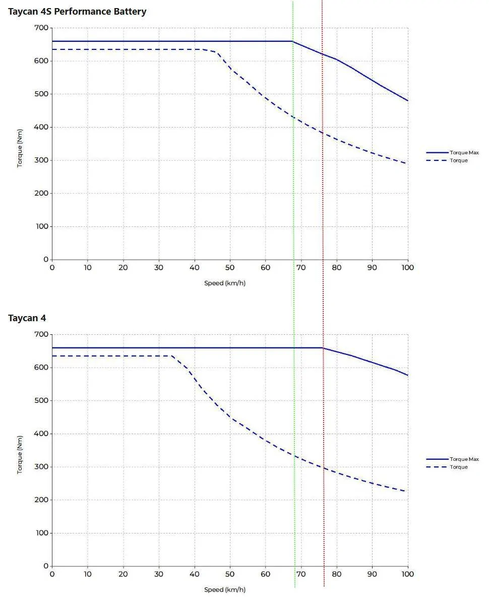

What makes the tuned Taycan 4 capable of sustaining higher torque than tuned Taycan 4S with PB+ after ~68km/h (green line I added in your graphs above)?
You are comparing the graph with PB not PB+.
All Taycan 4's have PB+ afaik no cross- or sport turismo has PB.
Touché. My bad. In my head I mistakenly assumed there was a 4S and 4S Performance Battery, rather than 4S Performance Battery and 4S Performance Battery Plus. There is no such thing as a 4S in your graphs.
