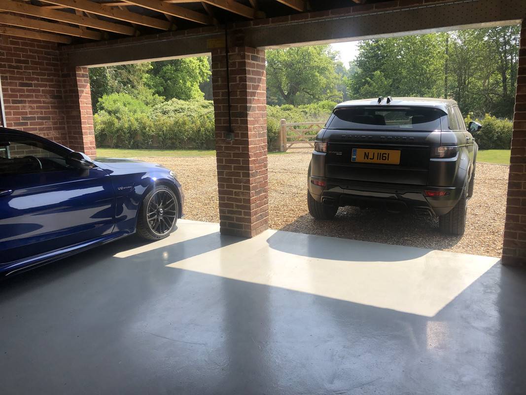

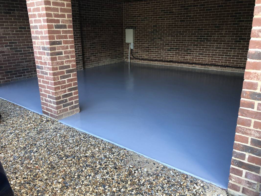

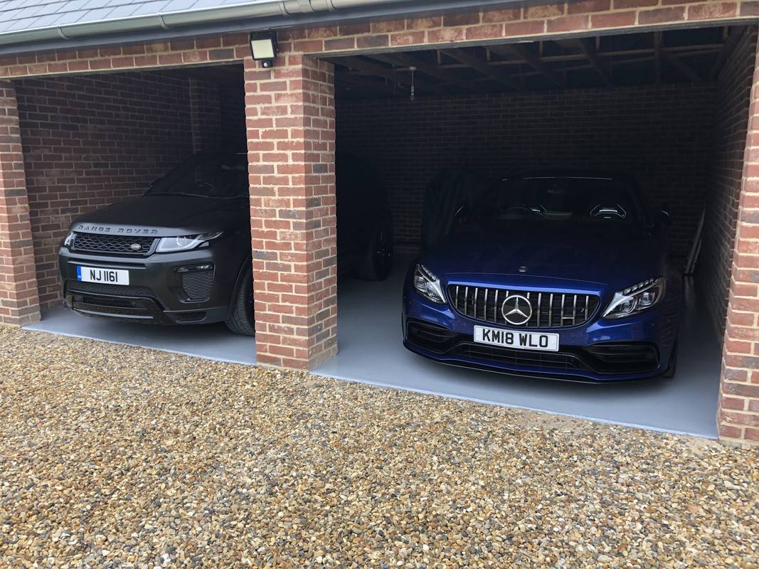

So, thinking I’m going to go for a pod point. Tethered unit 7kw and £559 after £350 grant. Anyone installed recently and any feedback? Is PP a safe choice in the U.K. ? Only other one I’ve really looked at is the Anderson and whilst it looks pretty is twice the price.
Second question is where is the best place to mount? I have a double garage ( or cartlodge as has no doors) and park in it most days. Am pondering fitting electric roller doors in the future so placement needs to consider this possibility. Heard that outside mounting is recommended?

If you like to reverse the cars in as shown would you contemplate the middle division pier Between doors? everything you do these days needs to have consideration for a 2 car garage possibly recharging two cars .... although Sod’s law would say 7kw might not be sufficient to bring two cars up to optimum 80/85% charge over anything other than 6-7 hours overnight hence suffice for one car charging only. Most chargers have a facility for work as part of a pair so adding a second charger becomes logical - if so you’d drive in as opposed to reverse and mount on back wall, handy to meter box power feed.

In the US I recommend to friends/family that you put the EV charger as close to the garage door as practical - if you have a cable long enough it can reach the front of the car no problem - but it also then allows you to reach a car in the driveway - allowing for maximum flexibility as to where to park a vehicle and still be able to charge it.

Yep I agree with that... The middle pier front could be an option but you will need to think about space if installing roller doors later (not in terms of fit but any possible reduced access). Then of course there is the cable run to the middle pier as opposed to one side of the garage.
The back wall has the benefit of being more tidy and central but you will likely need to park nose in and you will not have access outside of the garage for charing.
Middle brick post was an option as this was would I could chart outside also. Only worry on this is if i did fit doors that middle post may get modified!
