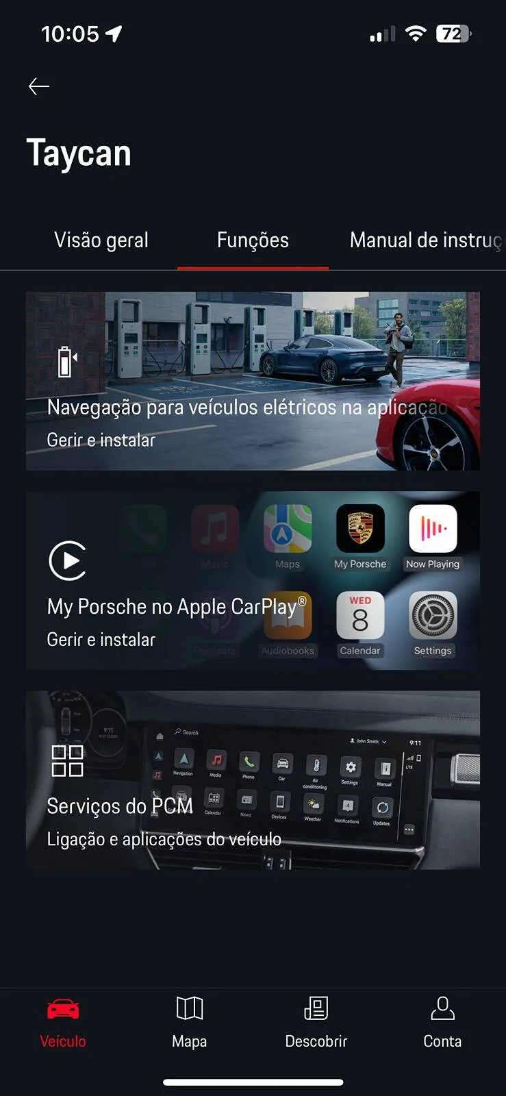

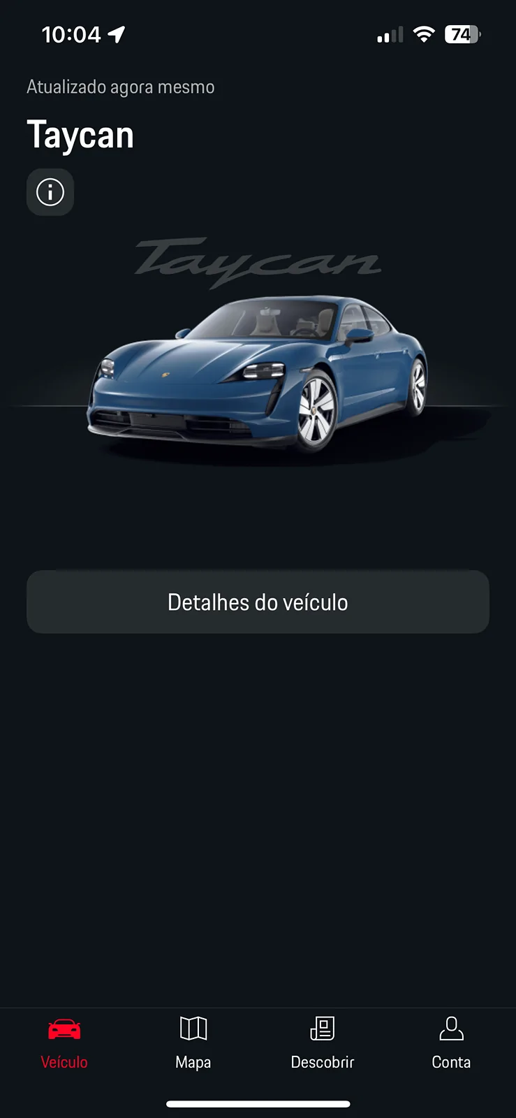

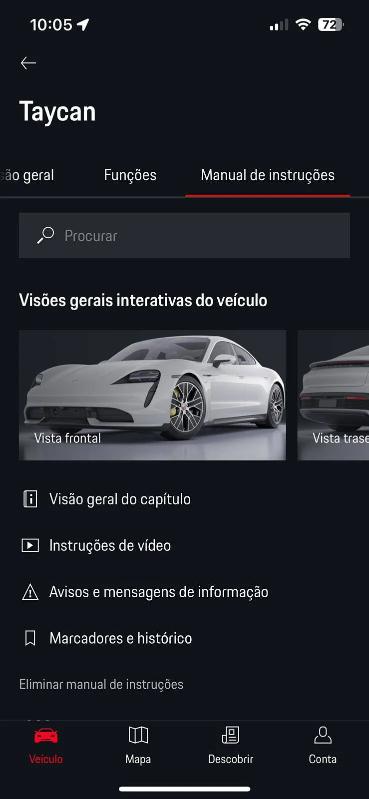

Hi,
I live in Brazil and here we do not have the support for the Porsche Connect. But I was able to get an account, and now I have the app with the manual, and some new features of the apple car play. But the app does not access the information remotely (because the car does not have internet connection).
Here is what I did:
1) I have enable an VPN from my PC to use an USA address, I do not know if it works without VPN, but to make sure I have used an VPN

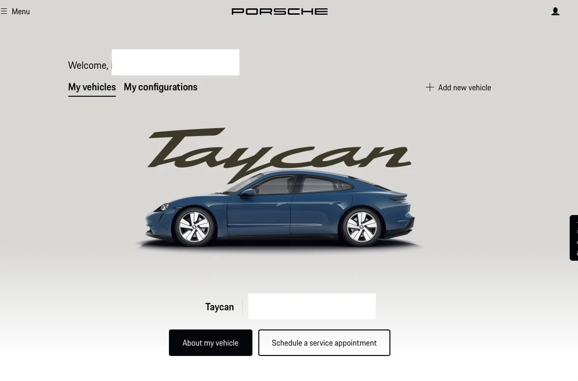

2) I have created the account through the USA register site
https://signup.porsche.com/us/en_US/register

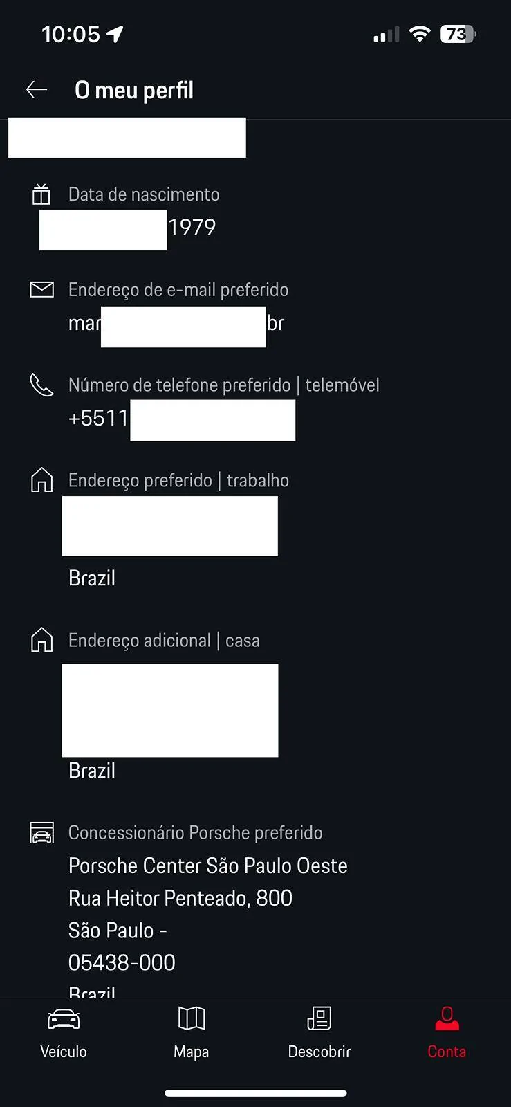

It will ask for you your ID and a proof of you owner the car. I have send my passport, and also the Brazilian car document that has the chassi number in my name. I do not know what kind of car document in your country, but try to send some that has your name and your chassi number on it.
3) The site will ask for your home address after you logged in I recommend that you put your real phone number with the contry code, because when you log on the app it will send an SMS to confirm de account (here in Brazil the country code is +55 ). I have also put my real address in Brazil and my Porsche center in Brazil.
4) It wil take some days to confirm your ownership, and I did not receive any confirmation. But after 3 weeks I entered on the app and I was able to register my car and have access to it.
5) As I use IOS do download the Porsche connect app I need to create an USA Apple Store account to download the app. To do that (Visit the US Apple ID website (https://appleid.apple.com) on your iPhone, iPad, or Mac. Select Create Your Apple ID, then choose United States as your country and fill in all the requested details. You can use any international phone number with this account, as long as the dialing code is correct.)
6) When you connect on the app with your account created on the Porsche USA site it will send a verification code to your phone. Make sure you have put the country code correctly.
If you need any help just let me know.
