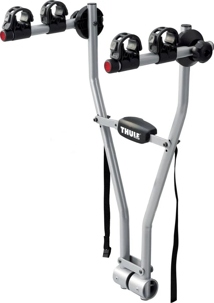

I installed a regular detachable European tow hook on my Taycan sedan. (one that can only carry bikes, not tow trailers).
Very handy with the super light Thule Xpress 970 bike carrier.
It is installed in 5 seconds and weighs only 4.6 kg.

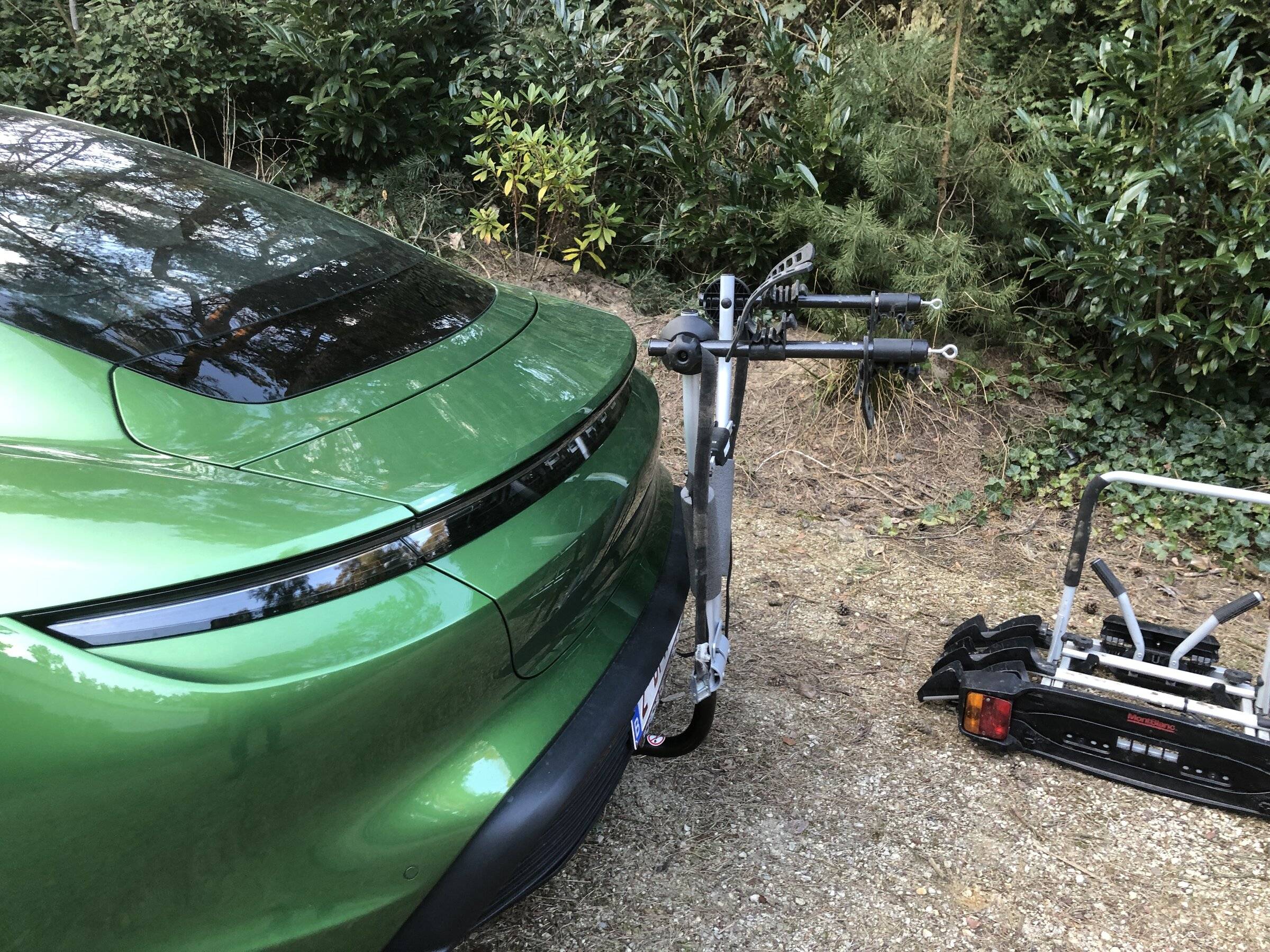

Would like to see your hitch mount and installation if you have any pics.
jasperp
jasper
Dec 12, 2021
163
107
Flanders
tesla,porsche
The bike carrier is grey. The tow bar is black.
The tow bar is detachable. It is connected at the bottom. So you can not see it if it is detached. Inside it is connected to the big alu bumper bar.
It is legal and safe because the tow bar can not be used for towing. So legally it is not a tow bar. It is 'a bike carrier hook'. It is made by the dutch company Brink for an ID3.
It is a bit of work and you need to cut a small hole in the pastic bumper at the bottom, but it is a very handy solution.

@jasperp would you mind sharing more photos where you cut the hole and attached the hook? I’m trying to do the same on my Taycan. Much appreciated!
