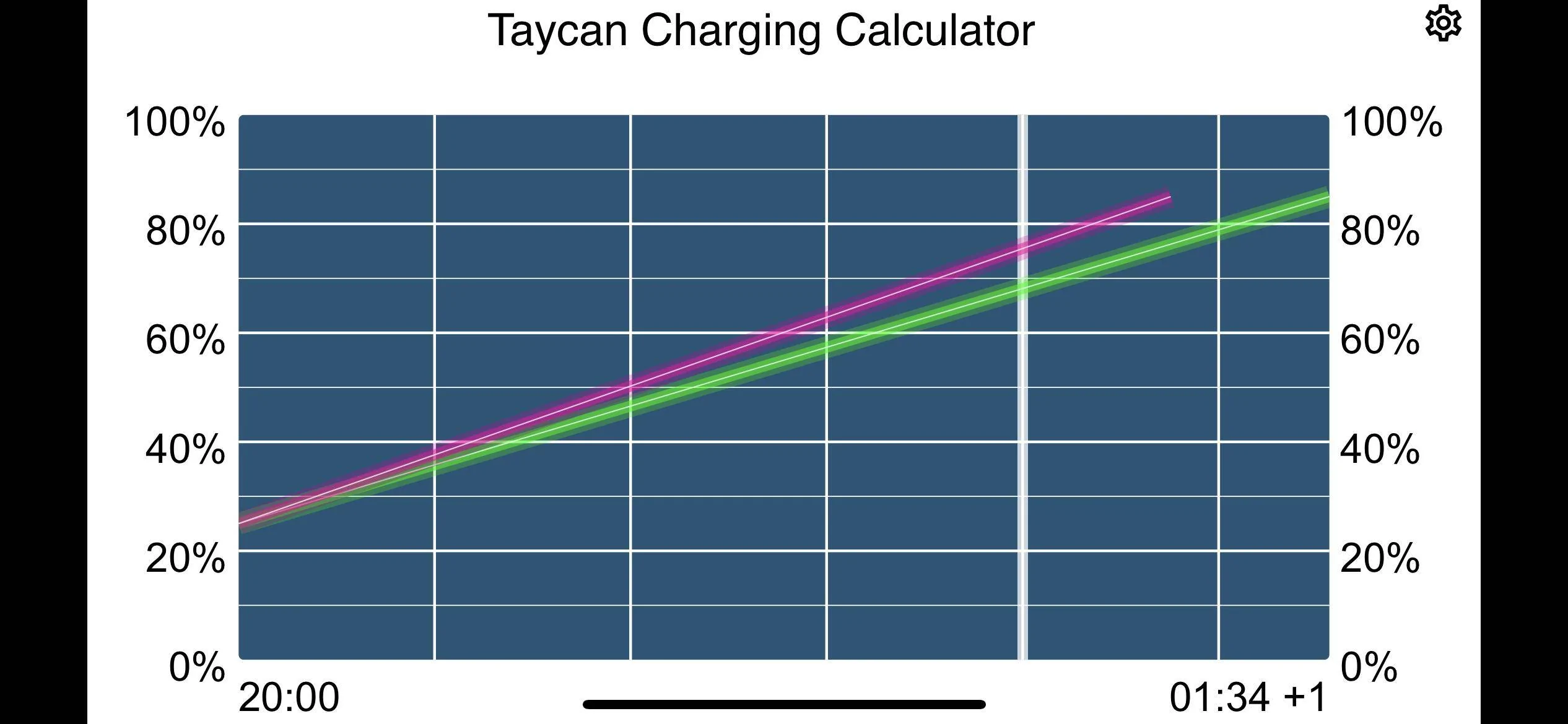

I think Tesla knows EVs better than Porsche. Their AC charger used to be 9.6 kW with an option for dual, which put the charge power at 19.2 kW. Their latest gen of onboard chargers for all vehicles tops out at 48A so 11.7 kW with 100 kWh battery. They dropped max ac current from 80A to 48A from gen2 to gen3 AC wall boxes, which matches their vehicle hardware spec.
Everyone can justify what they bought (of course), but the OP asked for advice. And got a mixed bag.
Tesla offered the 72A upgrade from 48A for a while, might still be available from a "secret menu". Until recently I had an 80A capable Tesla, it was useful couple times a year (outside of COVID years). I replaced it with an 80A capable Taycan a month and half ago. It was really useful once on my trip home (3,500 miles), kind of useful one other time on that trip, and very nice to have for the first month I had my Taycan at home where my Taycan didn't have its own place in the garage until I sold my Tesla, so I had to charge the Taycan from one of the Tesla chargers while blocking-in my wife's Tesla, so had to move it after charging. Having 80A almost halved the charging time, so I could move it much sooner, convenient.
Is 19.2KW needed for everyone? Of course not. Is it useful to some people? Sure. Is is useless for some other people? Of course. Is it nice to have? Absolutely. In the end you need to consider your usecases.
PS> Telsa model 3 RWD maxes out at 32A. It works for some people.
