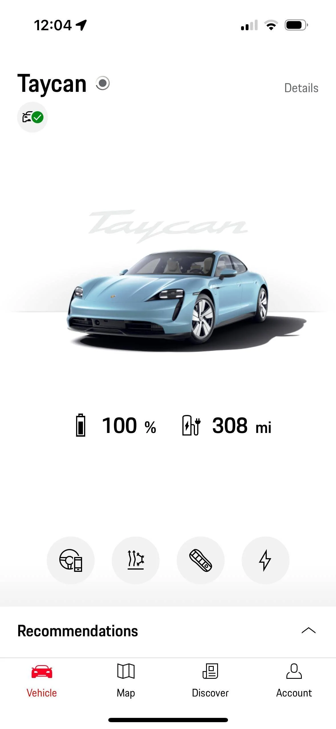

Depends on your recent usage patterns, but I did get this few days back on perf battery plus my23 -
Porsche Taycan Range at full charge IMG_1053
