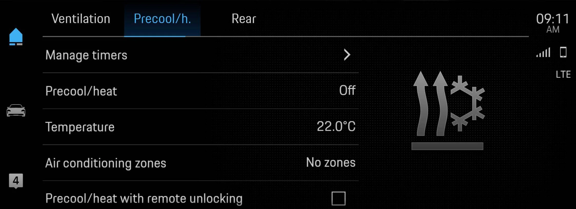

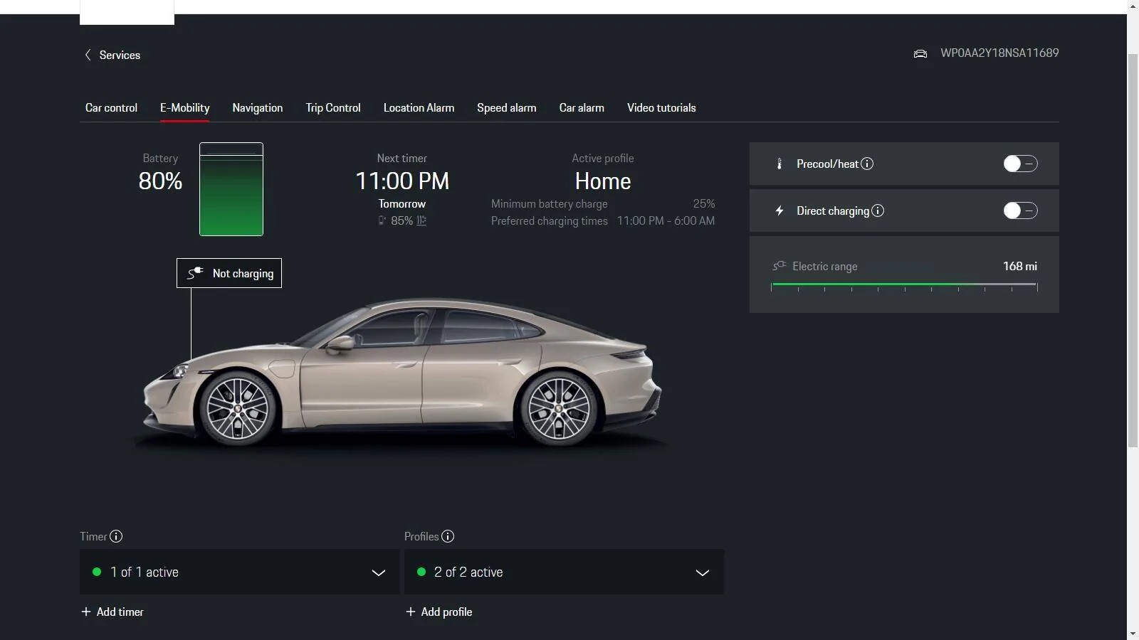

Here is what I see. I do have Precool/heat turned off yet my car pre heated last night. I screen shot the message on my phone and it says '11:10pm Air conditioning, The temperature adjustments in your vehicle have been completed'.
Porsche Taycan Range Problem taycan_1

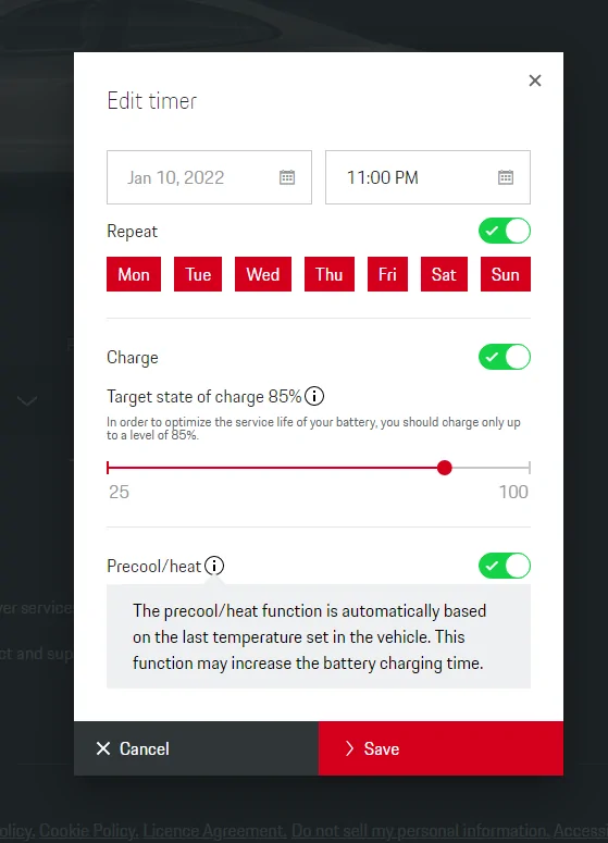

Edit: when I looked at my Timer, I do see 'Preheat/cool' turned on. But I thought this was only when the car was plugged in:
Porsche Taycan Range Problem taycan_2
No - Timers are independent if connected to your EVSE or not. If not then the timer will kick in, attempt to charge but realise its not connected and move on to the next task which in this case is to Precool / heat.

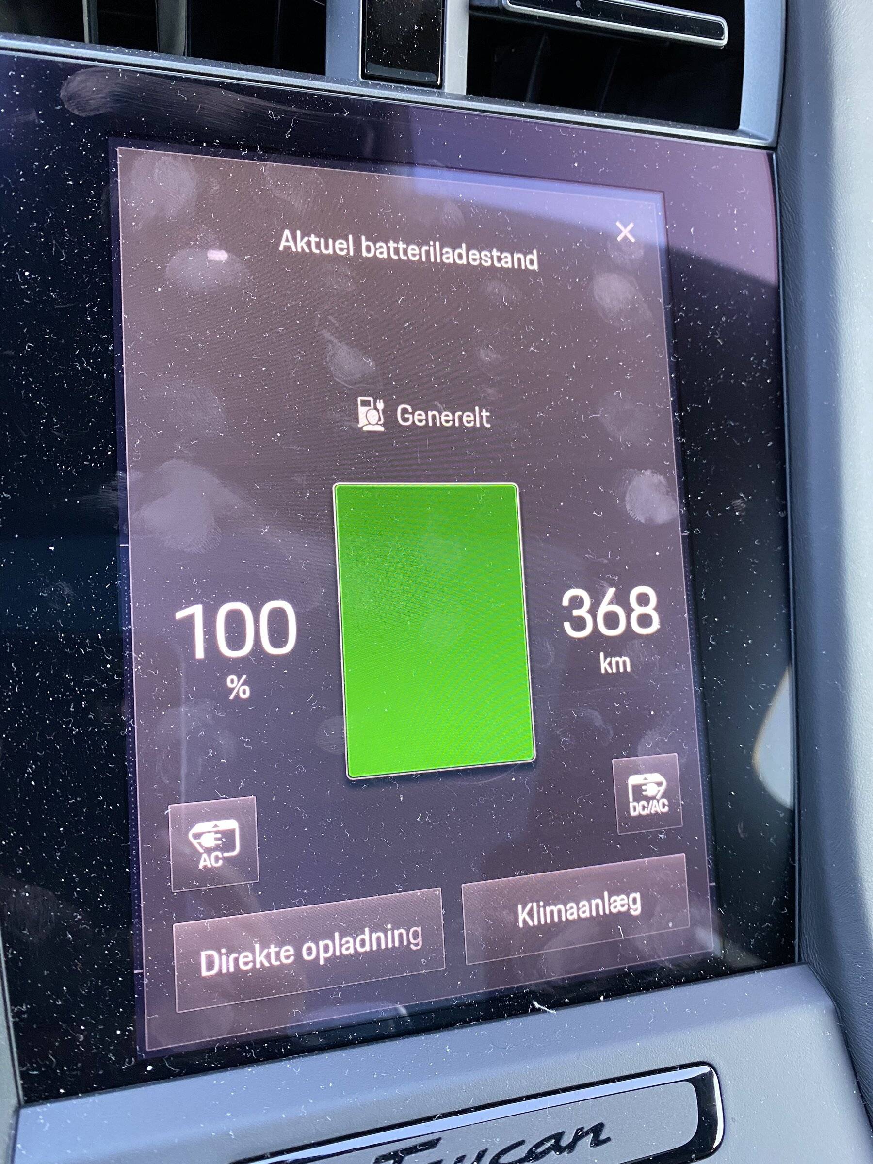

So today it was my first day with A/C on eco and no pre-heat. It bumped a full charge 100% up to 368 km range.
Waiting to see if the usage will be better.
Porsche Taycan Range Problem F463EF25-CBAB-42E0-B1EC-12CC4D0826B3
I am not fully satisfied yet. It must come up over 400 km range. It is not that cold in Denmark yet. And I have the performance battery plus.
So, I should turn OFF the 'Timer' -> 'Precool/heat' button? This will prevent the car from heating at night when I'm not driving?

Yes toggle the preheat to off and save but leave the rest of the timer as is as it won't charge if not connected to your EVSE.
You could create.another timer - one for charging and preheating (when EVSE connected) and another with preheat toggled off. Then you can activate either timer depending on whether you want to charge and preheat or not.
Preheat when EVSE connected can be good practice to get the best range but pointless if not.
The other option is to preheat en route to a public DC charger for faster charging. That's another topic however and requires using your Nav to do so

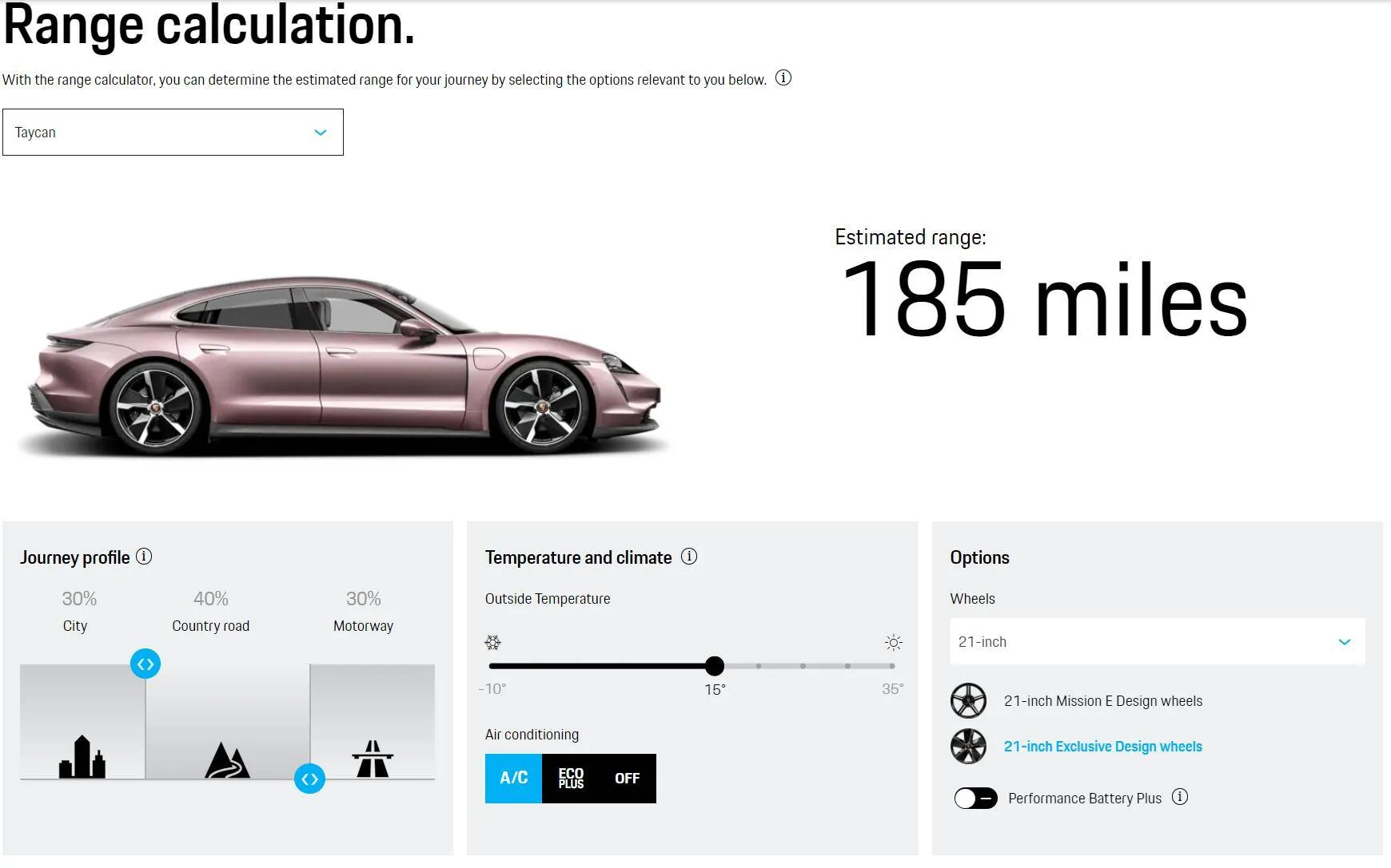

Yes but I think your have the Performance Battery and not the Performance Battery Plus (£4K option), is that correct?
You also have the 21" Exclusive Design Wheels which won't help (reduces range by 20 miles).
Porsche Taycan Range Problem 1641987072237
If so then that would be your range for this time of year so pretty much bang on.
Above estimate is based on the parameters you see. If you do 100% motorway driving you can expect up to 183 miles, 100% city driving up to 166 miles, and if 100% country roads driving you can expect up to 203 miles when the ambient temperature is 15C.
