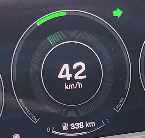

I have done about 800 miles in my car. I get the impression the regenerative braking is not yet working when I use the footbrake. How will I know when it starts to work?
What are the tell-tale signs?

I'm confused. Currently at ~300 miles. If there's no recuperation yet, what is the green band on the powermeter indicating when I'm braking?

I've spent time in both the 4S and the RWD version of the Taycan and there are some differences.
First and foremost, regen only occurs if there is capacity in the battery to receive the regen. So if your battery is fully charged, the car will not regen cause there's no capacity to store the electricity.
Second, coasting is more energy efficient than regen. I would say that this is part of the reason why range mode disables regen on throttle lift.
Now to see whether your taycan is regenning, set your center instrument cluster to "Power Meter". You'll see that around the speedometer there'll be a bar that goes around the cluster. When you give it more electrons to scoot, you'll see the green bar that goes around the cluster to indicate how much power you are using. When you regen, the bar will go the other way in a different color. If you look really carefully, you'll what the max capable regen and acceleration which is designated by the darkened bar.
Now the differences between the 4S and the RWD. I've noticed that in the RWD version, the regardless of the battery's SOC, the car won't regen until after a few minutes. Not sure why, I have no idea and can't think of a reason for this. In the 4S, you have regen immediately as long as you have the battery capacity.
I remember that Feye (?) in a previous post has some photos on this where he showed what the gauge looks like in both extremes. Full charge and no charge. Maybe he'll be kind enough to post it here too.
Observe the green bar in the power meter when you hit the break pedal.
Green bar = recuperation.
mine needed 450km (so less than 300miles)…and breaks feels completely different.
before, i had to push a lot….now, just a touch needed.
