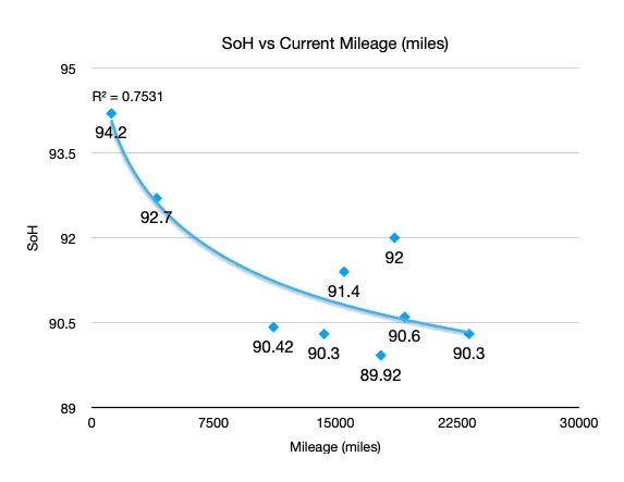

96% SoH after over 80,000 miles - really? My CT4S is 92.5% after less than 5000 miles. And the data from other users on this forum all report ca 90% +/-1 at roughly 20,000 miles.
Now this can be a tricky metric to record accurately or consistently but I still suspect a bit os BS on this :)

Interesting. How do you know (and other users) the recent SoH of your/their car? -Thanks.
These data all from OBD data a number of fellow forum members have - ton of other data can be downloaded from your car too - search forum if interested (can't recall thread this minute :)!
