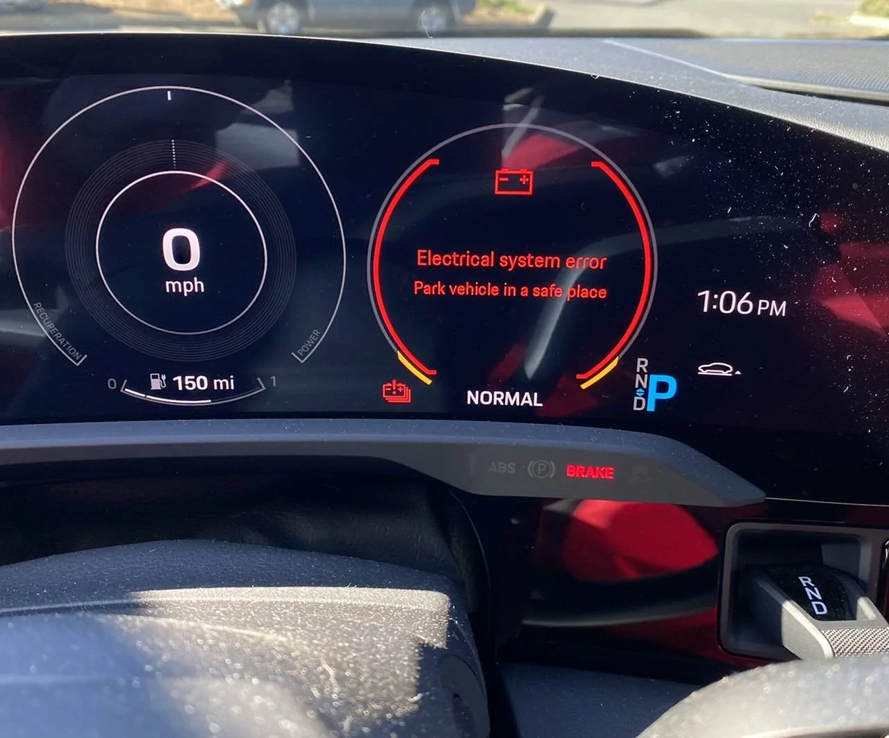

Add me to the list of people to see this error now. After 6 months of worry free driving. I got in after grocery shopping to see this error. Took 5 times of lock waiting and trying again before it started as normal and got home no issues thank goodness.

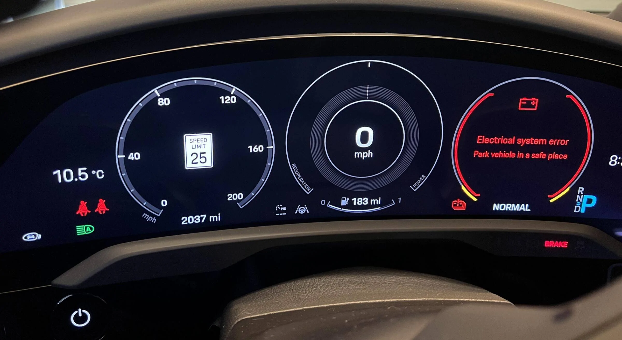

'22 Turbo S (11/21) with 2K miles, just got same error getting in the car first thing in the morning. Good that my wife's X7 was available to save the day. Back 30min later, i went back in the car and there seemed to be no issues. Drove around the neighborhood for about 1.5hrs and haven't seen any issues at all - no errors/codes and full power + regen available. Tried a few lock& walk-away scenarios, as well as a 80% charge after the drive, and still seems to operate normally.
A call to the dealer was answered by a call center, with the contact info of Porsche Road Assistance, no promise for a loaner, and first available drop-off date 5 days ahead. I already have a loaner appointment scheduled for 3 weeks from now for interior alarm + WNA5 update so I'm deliberating rolling the dice and waiting out till then.
Not sure if related, but a couple of things I've noticed:
- yesterday, the annoying Smart Route suggestions were popping up a lot more often than usual. I had to dismiss perhaps 8-10 suggestions on the ride home. Normally it is just one
- The interior alarm went off yesterday evening. it's done it before though
- I've noticed before, when I idle somewhere for a longer time, say 30min while waiting to pickup the kids, all 4 of the interior screens seem to be getting quite warm but not hot to the touch. No impact to their function at all, but this doesn't seem to happen during actual driving.
I was ready to deal with "range anxiety", but not sure how I'll do with "reliability anxiety"...

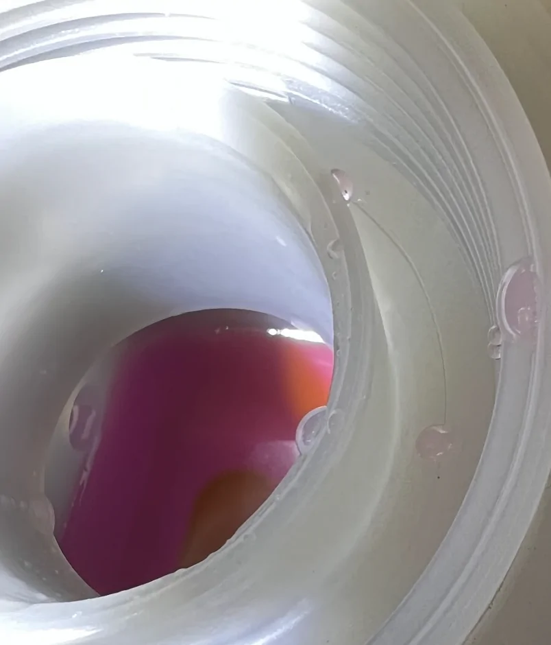

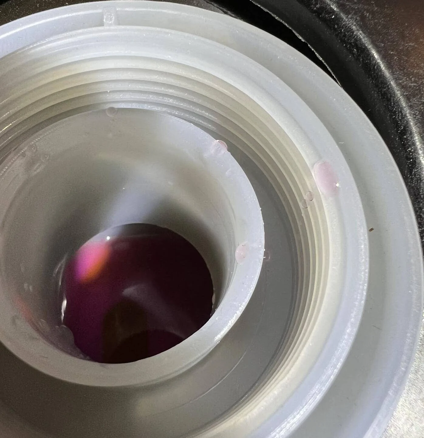

I just checked the coolant level just in case based on previous post. There is no specific mark i can see as in any other car I've had, but I can see some coolant in the reservoir so I'm gonna say it looks fine to me:
