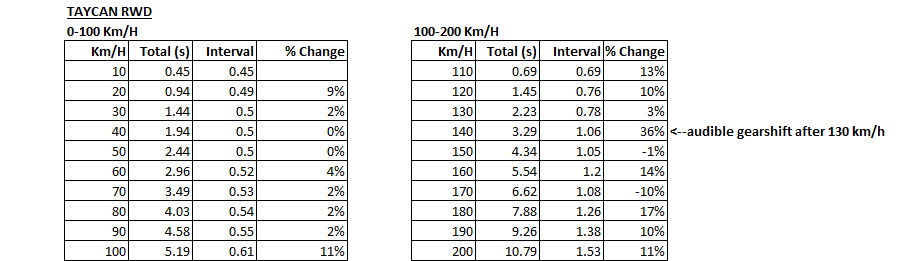

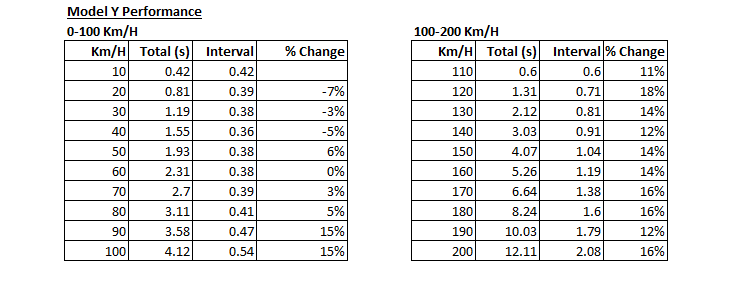

Was somewhat bored and doing some bench racing in excel, analyzing acceleration data from AutotopNL's videos for the Taycan RWD PBP and Model Y Performance that include breakdowns of 0-100kmh and 100-200kmh. Charts are below

Two interesting observations:
  • I believe the RWD's acceleration is artifically capped from 0-50kmh. It's surprisingly consistent at 0.5 seconds per 10kmh, whereas the Tesla actually shows decreasing intervals up until 40kmh.
    • In the context of EVs, the Tesla's numbers make more sense. EV motors provide max torque at 0RPM, and HP produced rises as the motors wind up to speed until peak power is produced. This explains why the Tesla actually is accelerating faster and faster up to 40kmh, and after this point peak HP is reached and starts to taper off slowly
    • Perhaps this is also an effect of the car hooking up and getting traction, but in this case you'd expect the Taycan being RWD should benefit even more from this effect
  • The Taycan RWD shift point is around 130kmh. It is audible in the video, and also reflected by the sudden change in the acceleration intervals from ~0.75s to ~1.05s

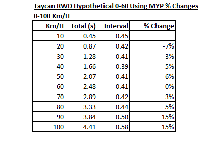

As a hypothetical, if you took the MYP's % changes in intervals and applied it to the Taycan's 0-10kmh, you'd get a table that looks like this, resulting in a 4.4s 0-100kmh. This is actually a lot closer in-line with what you'd expect from a car with this power and weight
HP rising as speed increases doesn’t mean accel gets faster. Under constant torque, accel should be constant, assuming negligible changes to resistance.
Torque applied at the wheel becomes a force and acceleration equals force times mass. So constant force = constant acceleration. HP increases because you’re doing work at a faster rate as you accelerate. But that doesn’t necessarily mean faster acceleration. For acceleration to increase, HP would have to increase faster than the rate of speed, meaning torque would be increasing.
Ah you're totally right - I forgot that Power = M*A*V
