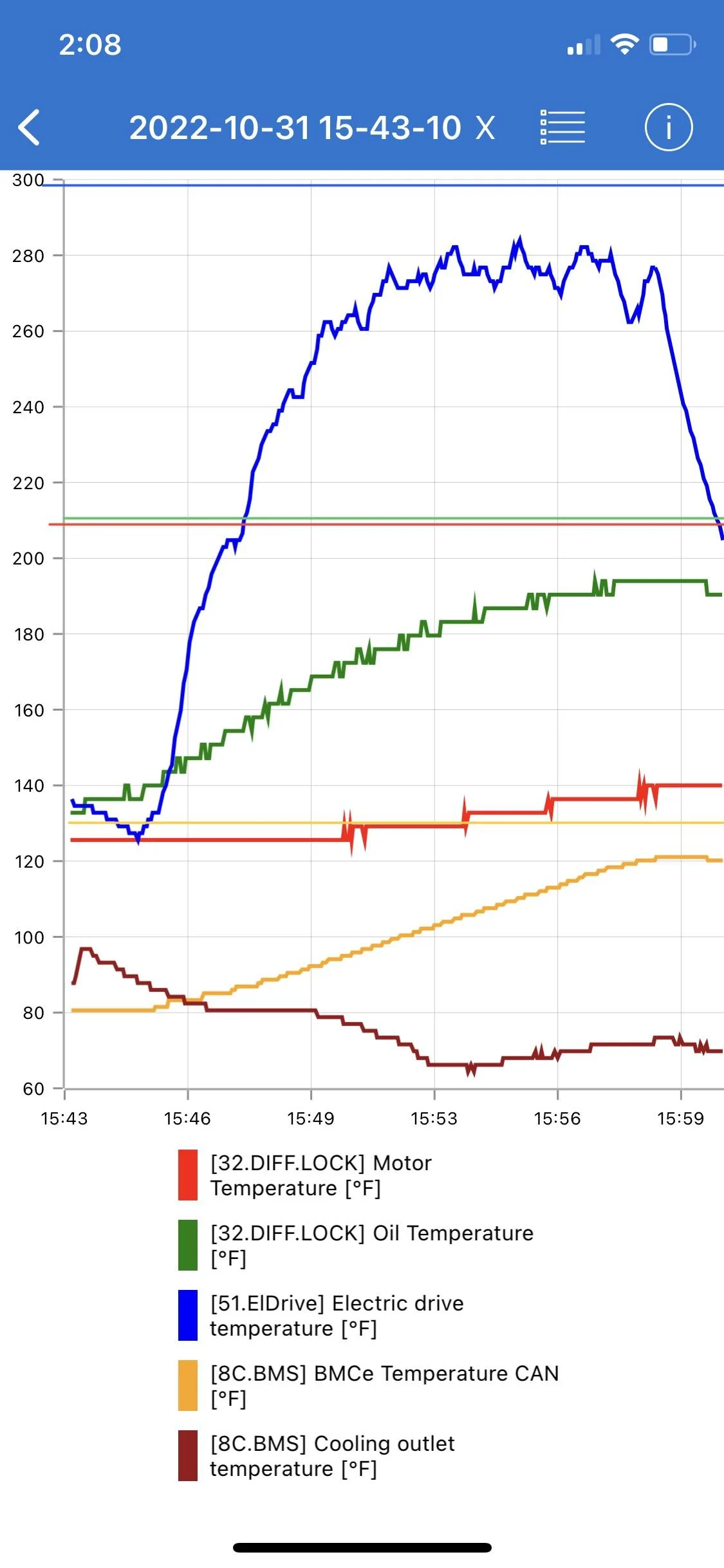

I think battery thermals would remain the limiting factor. Motors can run hot and just lose efficiency over 100C. Invertors and electronics would be the next limit at 150C. From my past data logs on the track, motor and invertor (I assume ElDrive) temps plateau or have lower increases than the battery temp (BMCe). Battery temps need a ton more cooling capacity than the car has. Still manageable for the 15 min session logged below though.

Horizontal lines for temp limits added for reference.

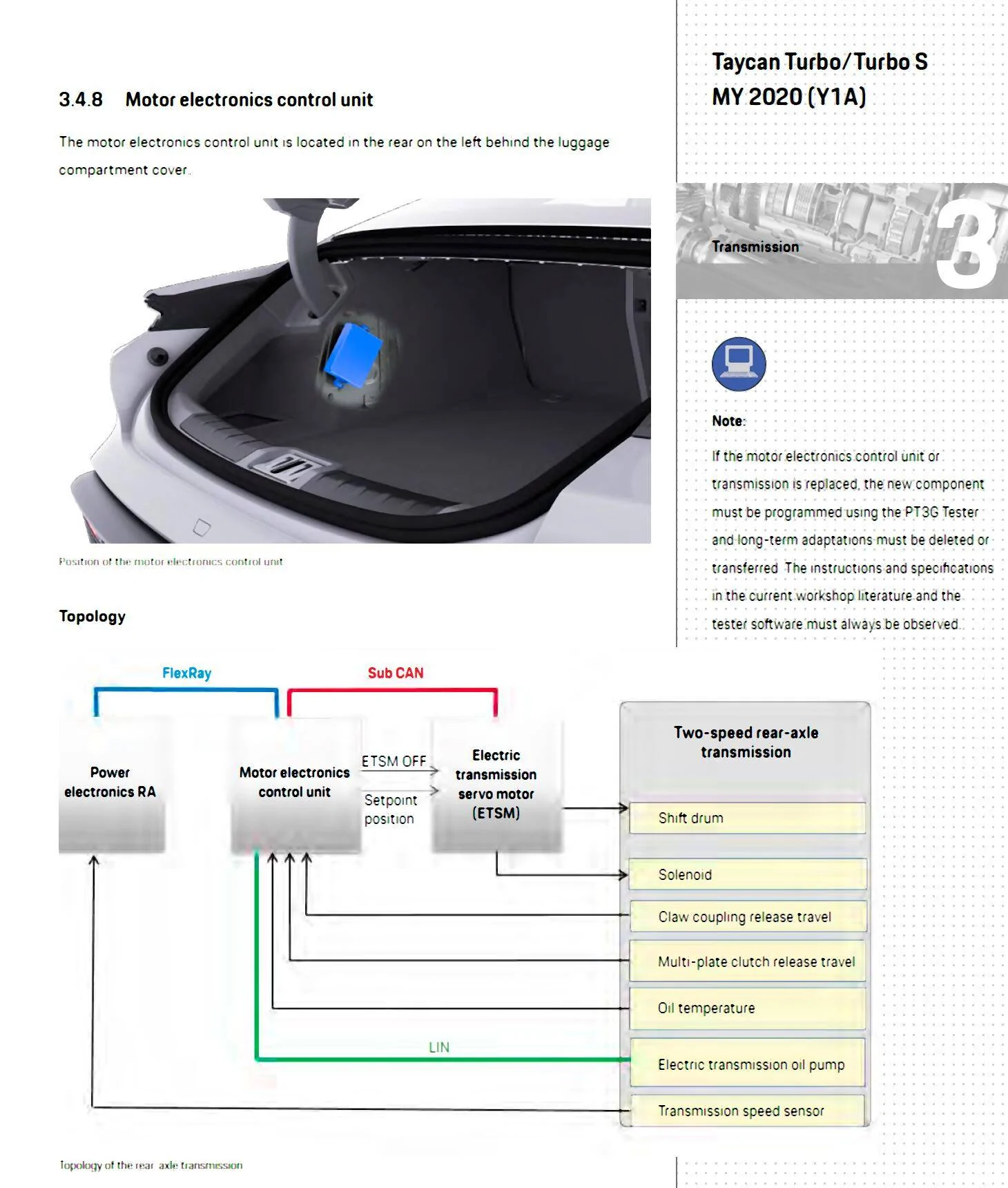

What form does this upgrade take? Is is reflashing some ECU(s)? Does it add or replace any hardware (if so what)?
EDIT: Nevermind, it's a firmware re-flash of motor electronics ECU. Video here how to remove it from the car.

Interesting that those docs quote 40c and 45c battery temp as threshold for avoiding excessive battery ageing, compared with Porsche's apparent limit of 55c. Have you noticed any permanent degradation from your sessions exceeding those thresholds for 5+ minutes? (I used Porsche's own vehicles) I'm guessing that fast charging alone could see up to 55c.
